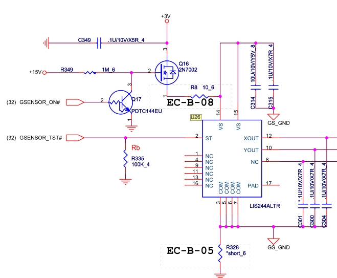

    Hello, recently got a Lenovo SL510 laptop. The laptop had a coffe spill, I cleaned it up, put it back together, the keyboard worked just fine. After the laptop had not been used for two weeks, the keyboard stopped working. So I took it apart again and removed the stickers on the motherboard to find any residue. What I found was bad, the coffe got under one sticker and was already "eating" the components, I cleaned the board with a toothbrush and alcohol and found a resistor that was not working and looked very bad, I can't identify the value of the resistor, or maybe it's a small SMD diode?
    The small red mousethingy is working fine, also external keyboard is working. I am out of ideas guys.
    Maybe someone can help me find a schematics of the motherboard, Monument.

        Re: Lenovo SL510 Keyboard issue - bad unidentified resistor
        No sir, it's not. When I check for an example "R345", the values are different from the ones in this pdf file.
        Here's the image of this area.
            Originally posted by Monument
            I am out of ideas.
            Clean this zone of PCB, and post new photo.
              I took out the resistor, it was very oxydated, couldn't tell the value, even the surrounding PCB is a bit damaged.
                Are Q17 and U26 in contact through any of its pins?
                The quality of the photo is good, but I can not see the name of U26.
                Could you post it?
                Is there a motherboard code number?
                  One end of the resistor should be in contact with the transistor. I believe the motherboard code is dagc3amb8 and I read
                  "KXTC8
                  20020
                  1511"
                  on U26 chip.
                    I think this is the code, but I haven't this diagram.
                    See if this diagram helps.
                      I think the resistor is R349 with a value of 1Mega ohms.

                        yes it is
                          Schematics can be found via google. Still, replacing the resistor should not make the keyboard work. The keyboard itself might be damaged.
                            Yes, it didn't fix the keyboard, however, the laptop seems to work just fine, external keyboard is also working fine so I assume the keyboard is malfunctional.
