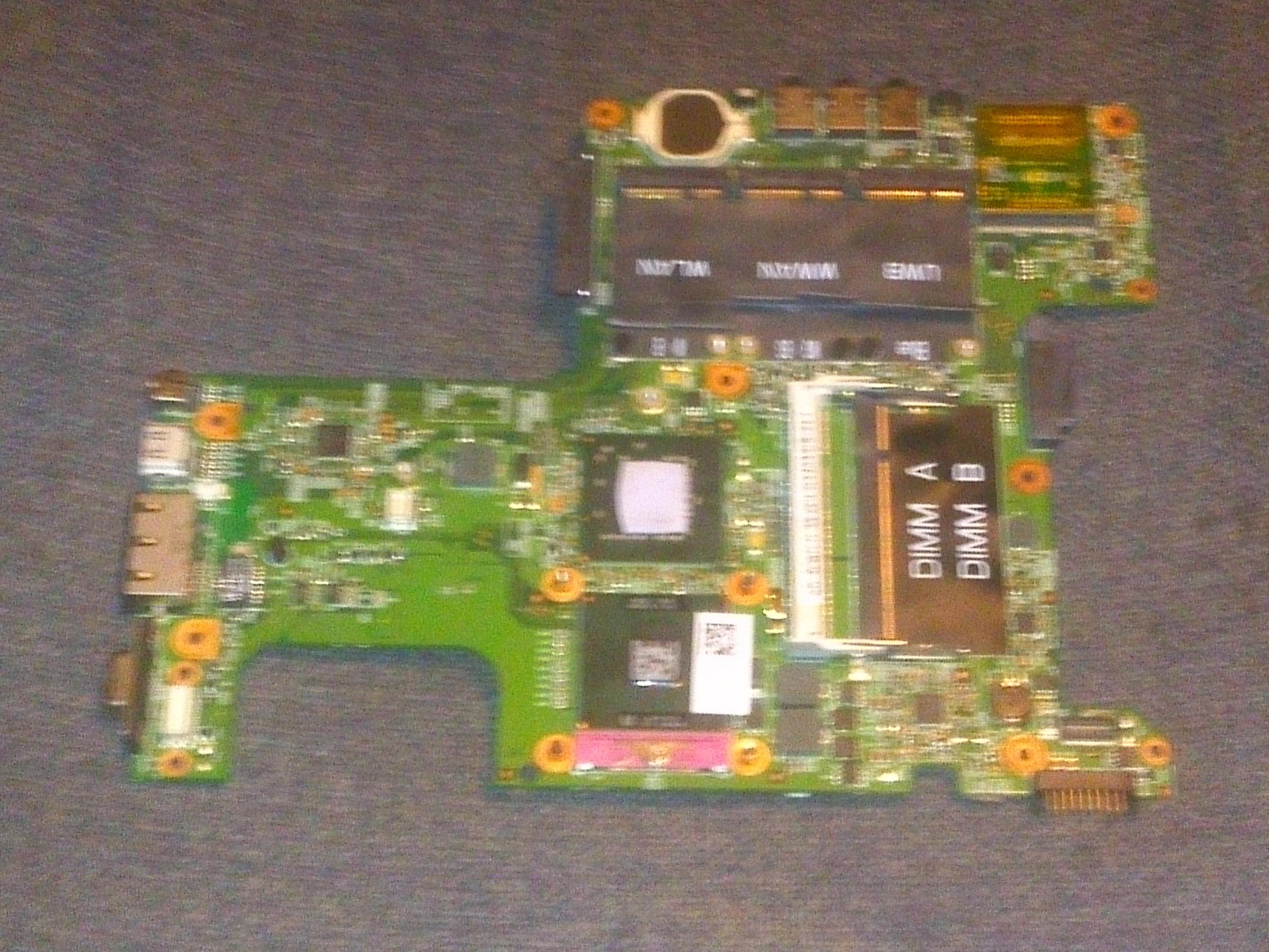

    i have a dell 1525 that shuts the green led off on the ac charger when the motherboard is attached to the power board! i replaced the power board and still the same problem. so now i'm trying to figure out what on the motherboard is causing it to short out the ac adapter! i have seen many of these with problems but everyone just replaces the motherboard and never troublshoot it or has a fix. i wanna try to figure out what on the board is causing it to have reverse circuit problems from what i have read that is the problem. the charger doesn't get tripped if it is plugged in without the motherboard attached so it has to be something on the board shorting out. i have everything removed from the motherboard modem,ram,etc. and nothing is attached to the motherboard like the keyboard,power button board etc. where could i start to test? i also checked the cmos battery and across the cmos when it is on the board and it reads 3.07v which is ok. any help would be greatly appreciated!

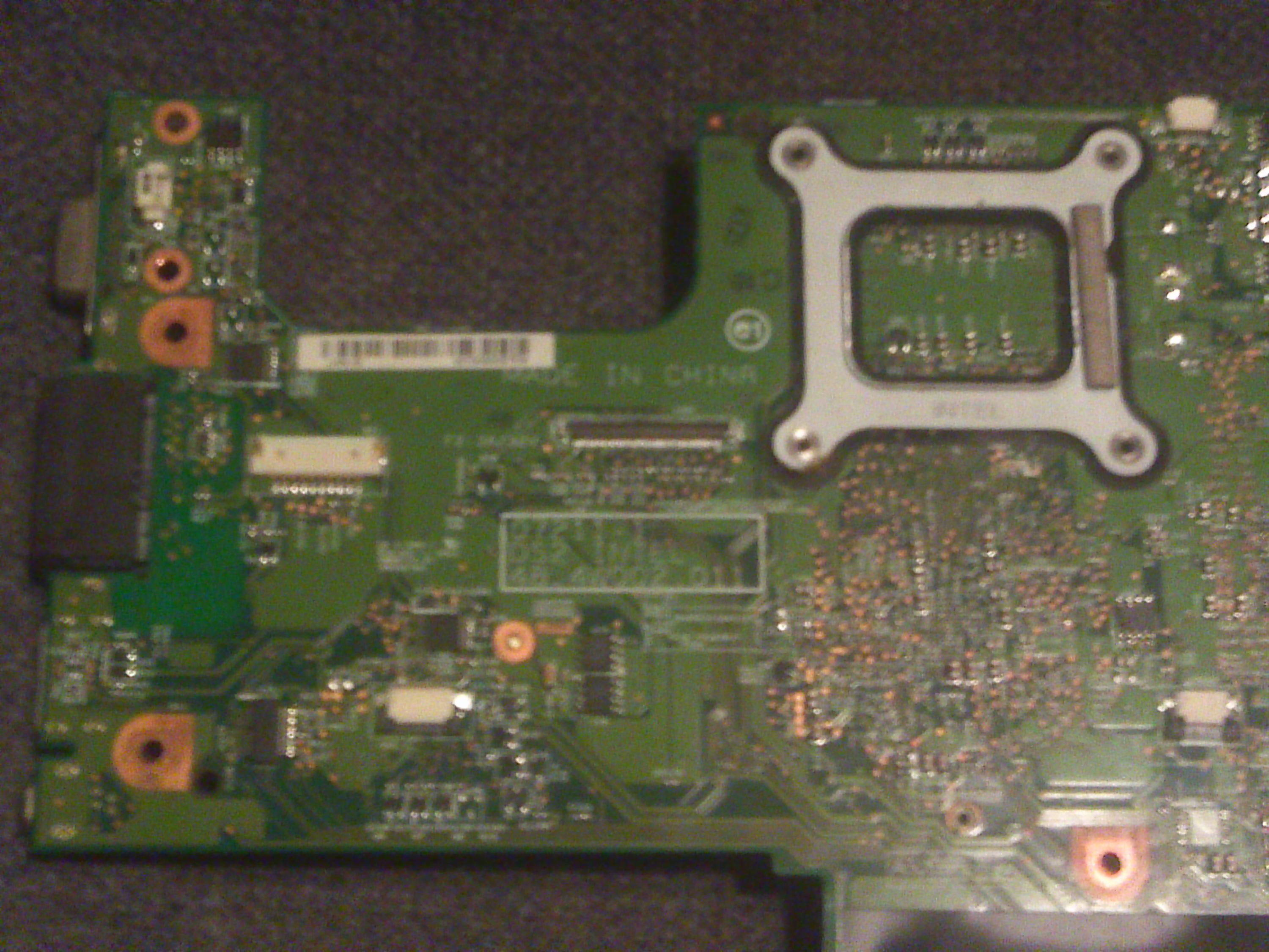

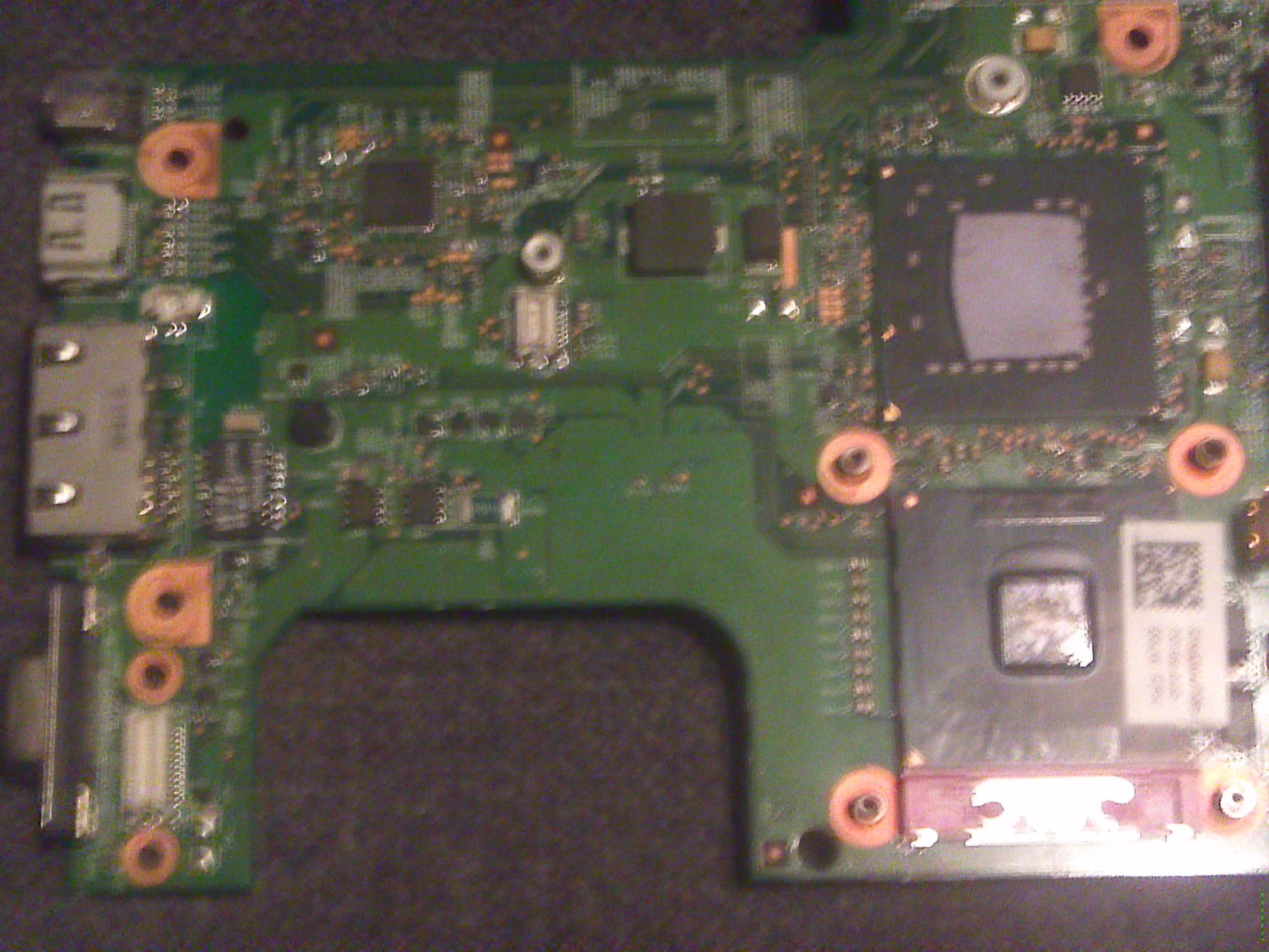

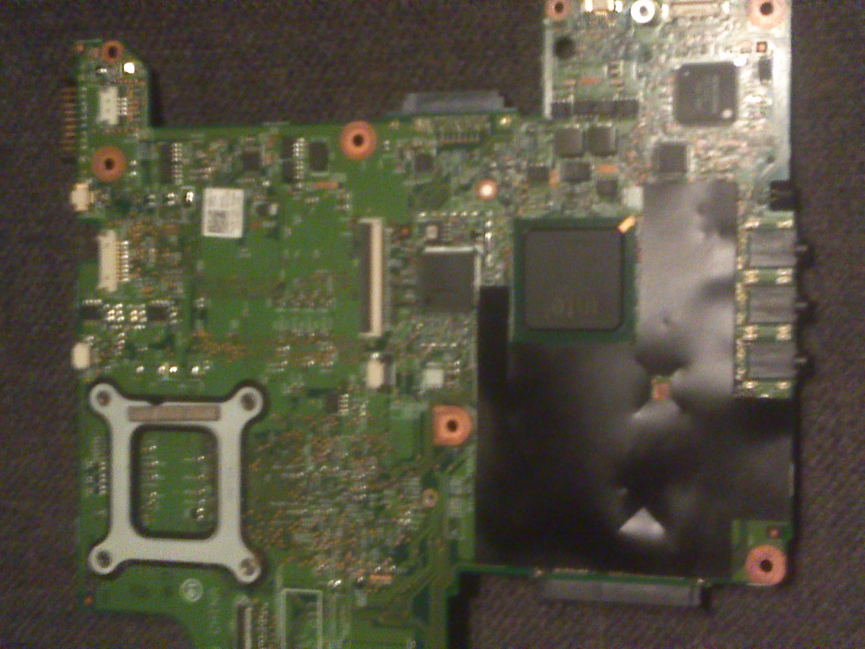

    the board is 07211-1 ds2 intel 48.4w002.011 and on the board is see that it has K5,k6,and k2 which are contactors i believe they have to be making contact in order for it to work and if they aren't will this cause the board to act like it is shorted and give me the results i am getting? here are some pics they aren't the best. all help is appreciated! thanks in advance!

      Re: Dell 1525 motherboard trouble need help troubleshooting
      remove the wifi protection sticker.
      i had one dell like this that had burned chip under wifi sticker,
      find a better camera even my webcam can make better pictures

        i took the sticker off and don't see anything burnt.here is a schematic but i am having trouble following it!

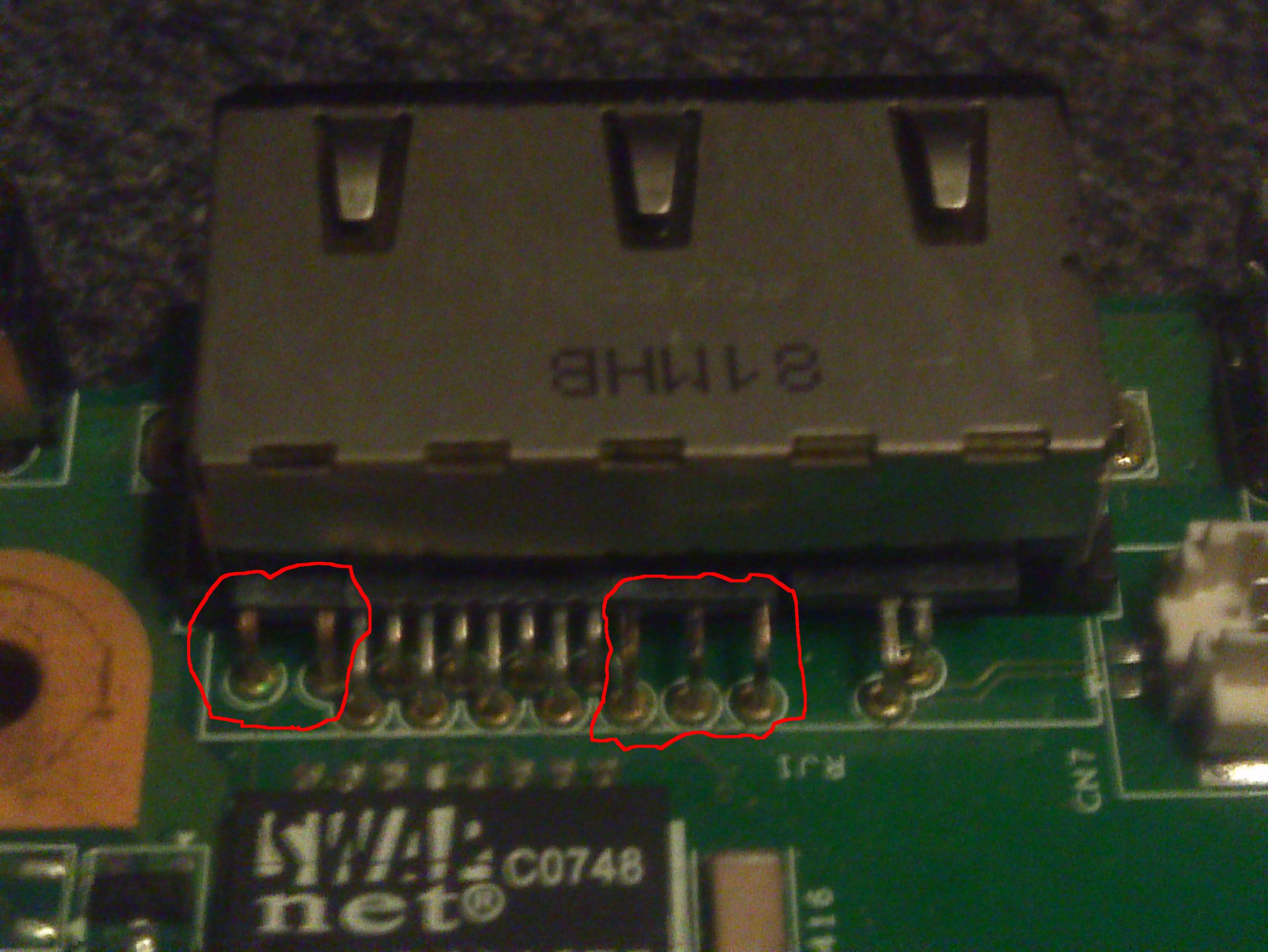

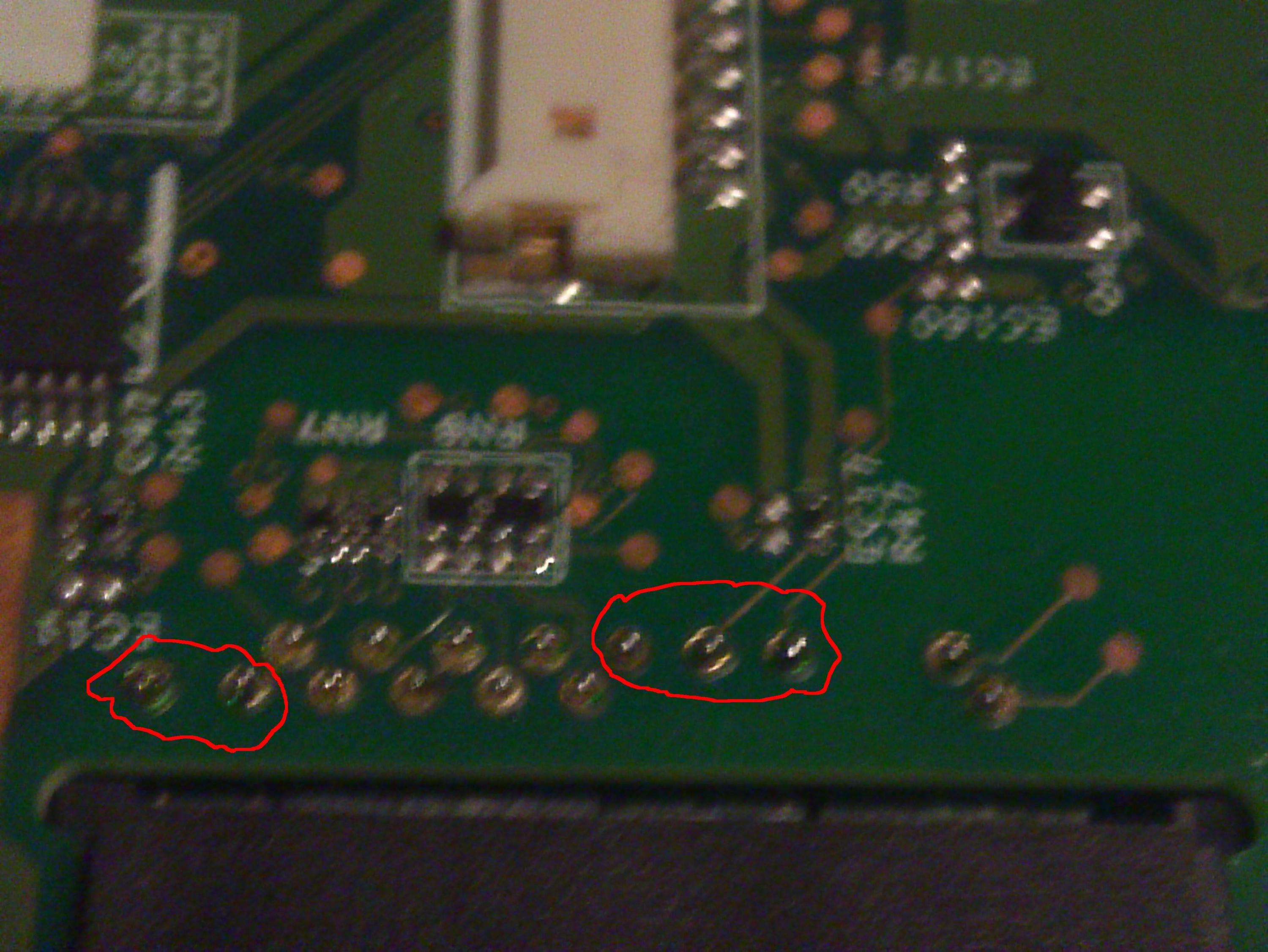

          is there any way to check an rj45 jack with a dmm? the back pins going into the motherboard look burnt. not the 8 that come from the cable but the other 2 that i believe go to the light when it is plugged in. will this cause it to short out the ac adapter if it is shorted? it also has the phone line cable on the same jack and there are 3 pins that look burnt between the rj45 and phone line. any help is appreciated

            here are some pictures i looked all over the internet to check the rj45 jack but everyone only shows how to test the cable.

              has anyone ever attempted this or isn't it possible to cause the problem i am having with a shorted out rj45 jack?

                why not connecting a cable with one end and then checking the connections on another end on bare wires to the MB?

                  if i am understanding what you are saying i can't do that because as soon as the motherboard connects to the power board it trips the ac adapter and no power can be sent to the motherboard because of a short somewhere i am guessing!
