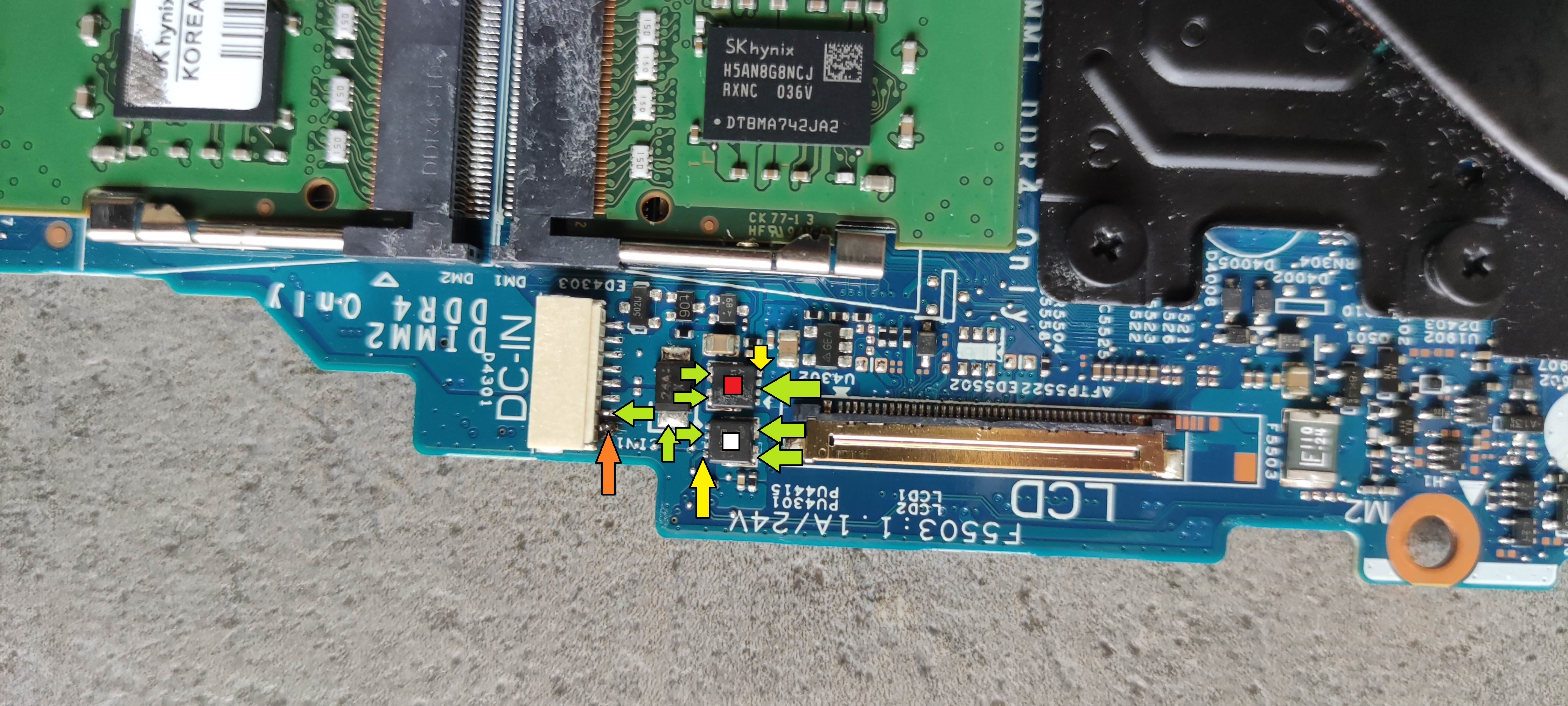

    Hi, I have this Dell Inspiron 15 5000, label says P102F and P102F002. It is completely dead, no charging lights. Any help with troubleshooting? I'm not even sure about the motherboard version, maybe the attached photos could help.

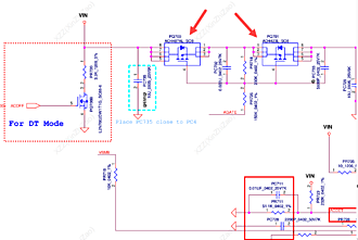

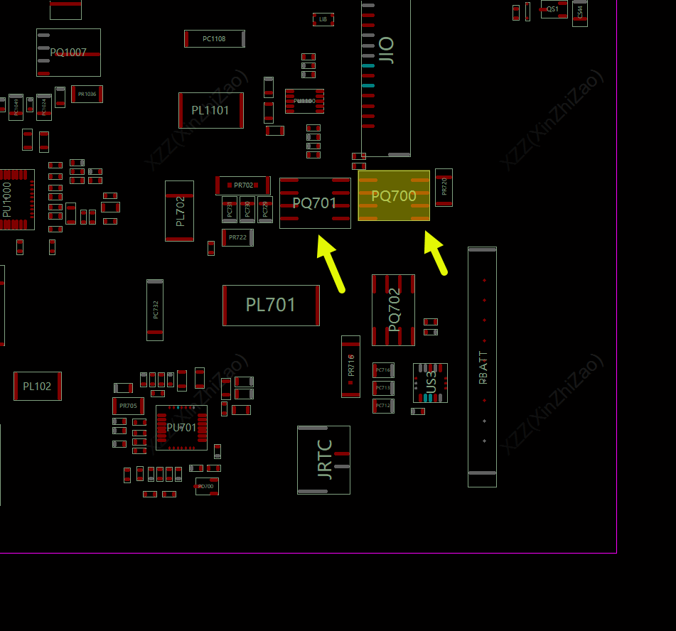

    See attached. Locate these 2 x DCin mosfets. You will need to check the voltage to ground of:
    source (1-2-3)
    gate (4) ; should be ~25v if all is well and the charger IC is enabling the power path to the logic board
    drain (5-6-7-8)
    measure both DCin mosfets. Post all measurements.
    Update - the BV may not be matching yours. Checking my database for other board views to locate a suitable one..
    Click image for larger version  Name:	dell_bv.png Views:	0 Size:	43.1 KB ID:	3288383
    Click image for larger version  Name:	dcin_mosfets.png Views:	0 Size:	129.5 KB ID:	3288384

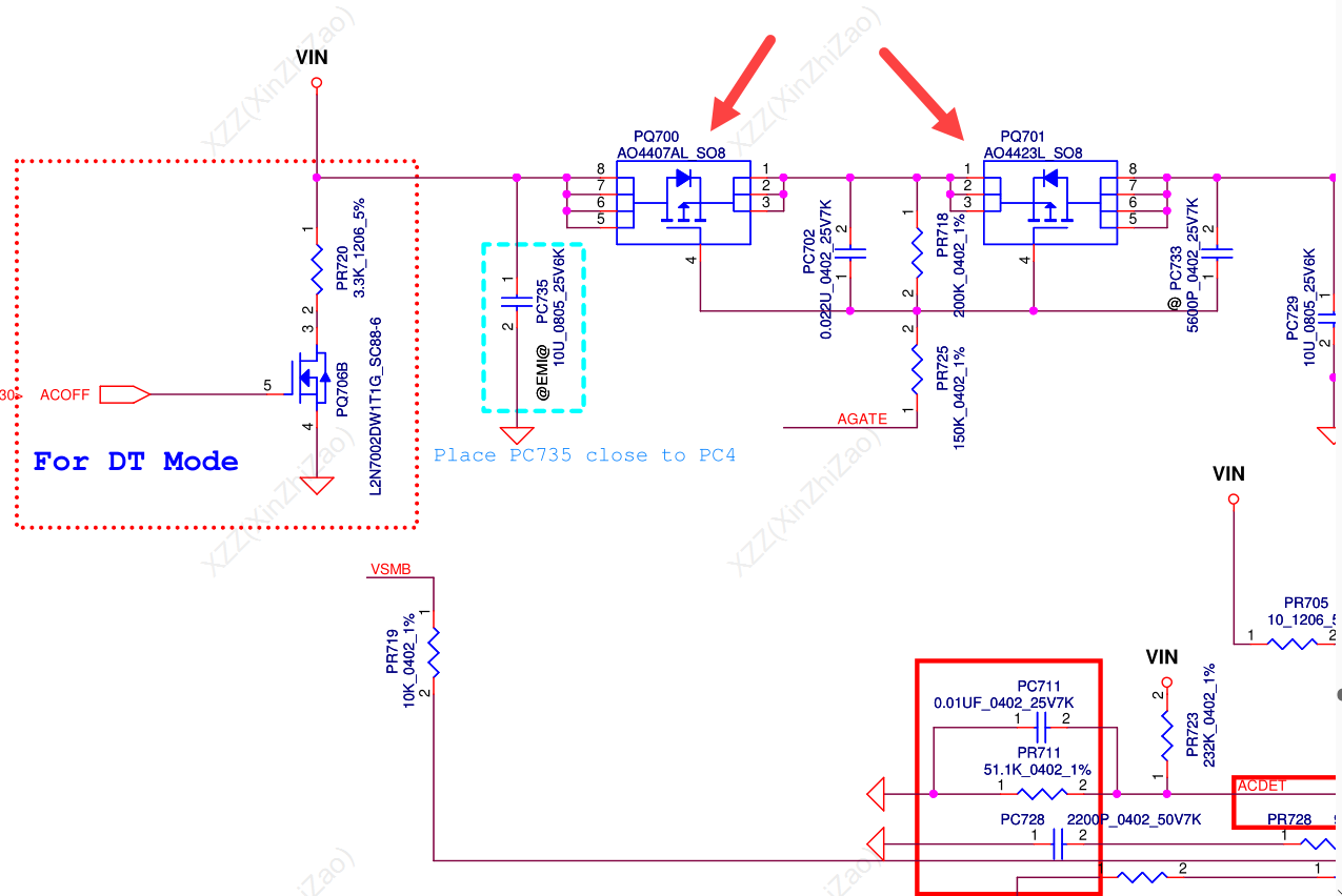

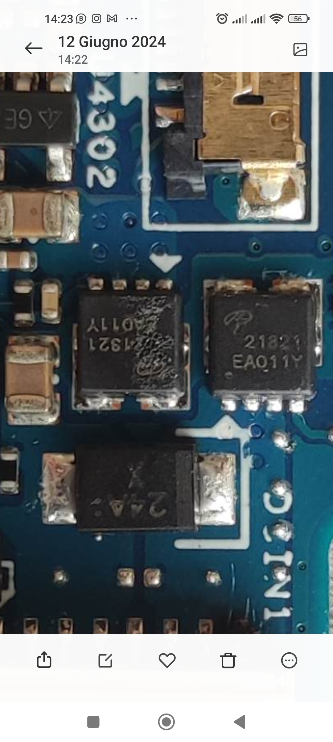

      I took a picture and I made a few checks with multimeter:
      mosfet with white square:
      source pin 1-2-3 20v
      gate pin 4 3v
      drain pin 5-6-7-8 20v
      mosfet with red square:
      gate pin 4 15v
      20v also on the first big diode and the second pin of dc-in cable.
      weird thing..if I try to measure voltage on the first lower pin of the dc-in cable connector (orange arrow), a short occures (you can tell there is a little burn mark)

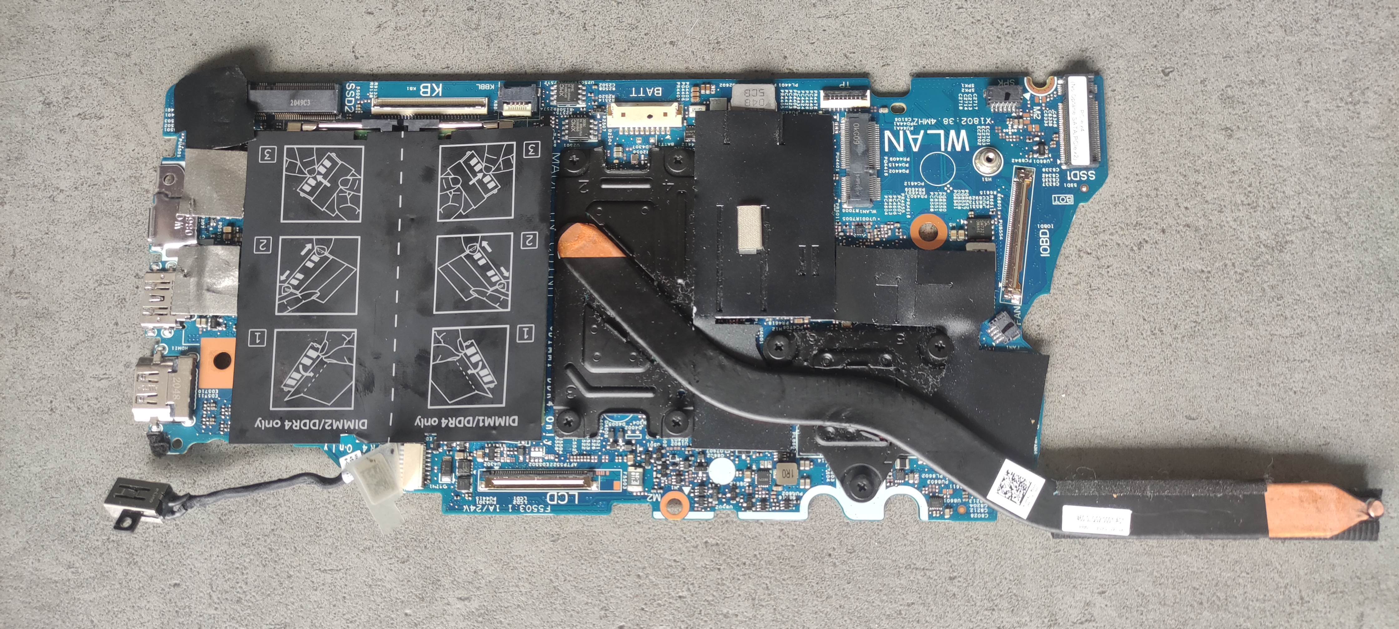

        if needed, I could also measure this part of the motherboard in the attached photo

          Share the topside markings of the mosfets (white & red squares) that you have measured in your post # 3. We need to know if they are P-channel or N-channel types.

              Both of these appear to be P-channel mosfets from Alpha Omega AONR21321
              AONR21321_Rev.1.0_Rohs (aosmd.com)
              To avoid shorting events, better to study the circuit without power to the logic board. Locate nearby these mosfets the charger IC that is driving both of these DCin mosfets. The charger IC will usually be a black square device with pins on each side. Given that the DCin mosfets are P-channel type, the charger IC is probably NOT from Texas Instruments or the 'BQ' style. TI likes to use N-channel mosfets.

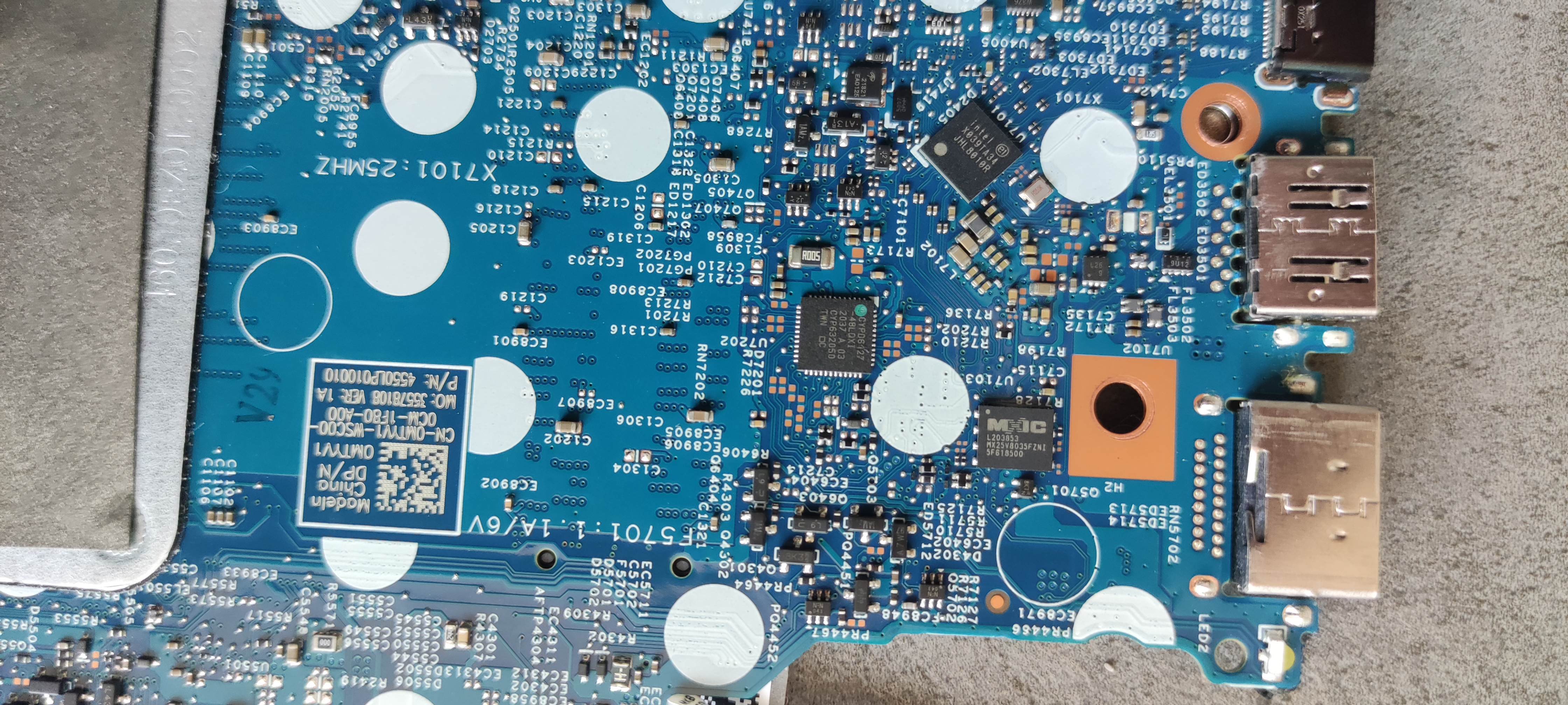

              Hunt around also the other side of these mosfets. Share more pics of that area and the topside markings of the charger IC. Essentially you are reverse engineering the logic board's power path. Somewhere along the way, the power is stopping to travel to turn on the board.​

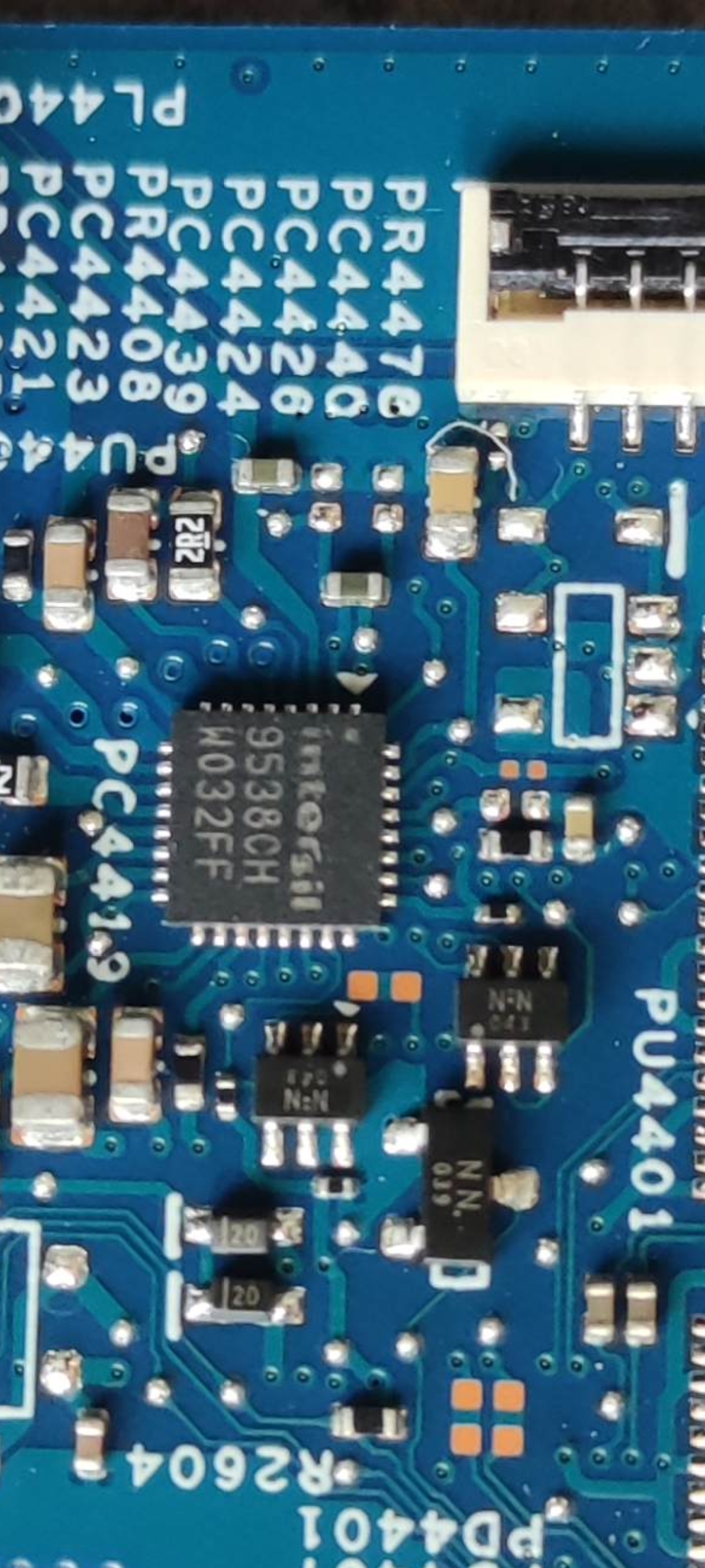

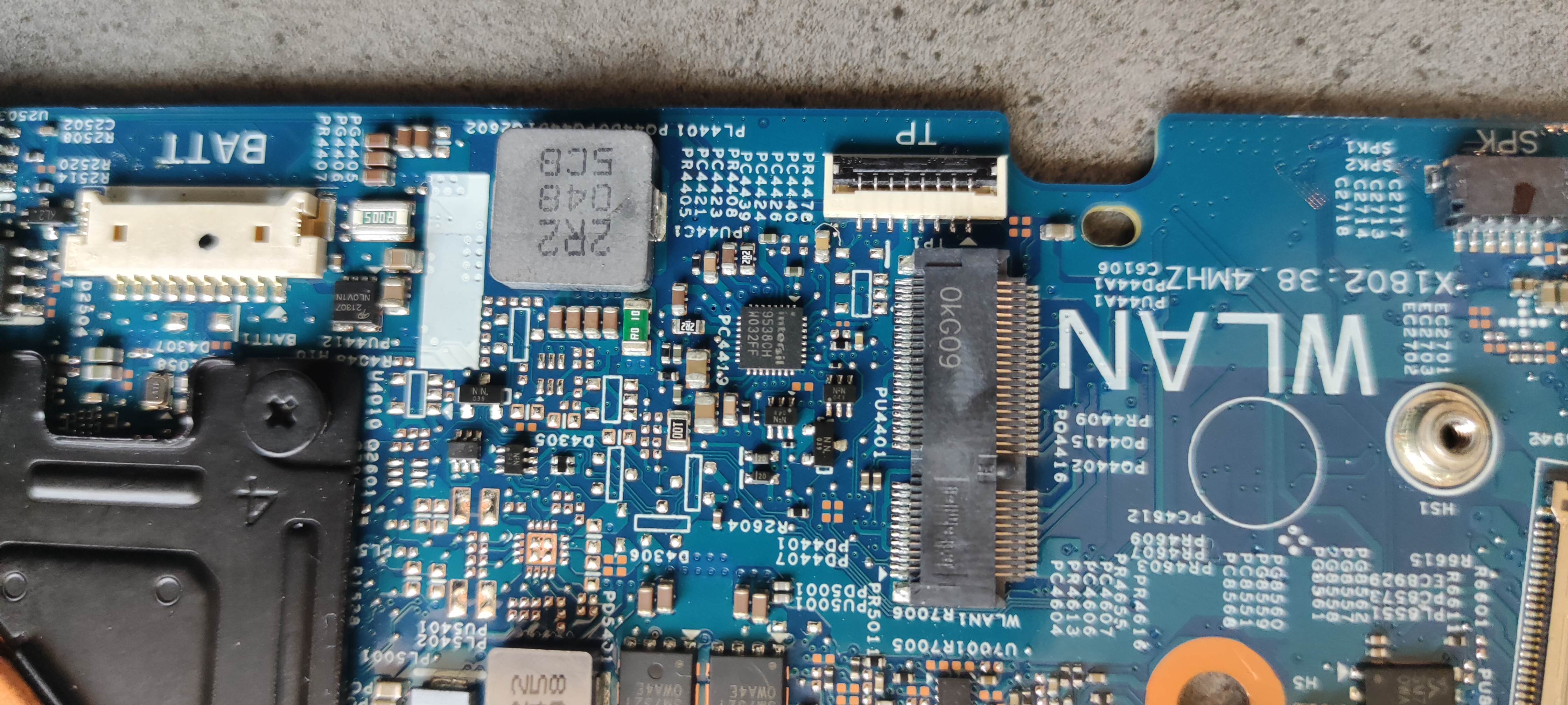

                here some pictures. please help me locate the charger ic. Maybe the one with the green dot?
                • mon2
                  • Dec 2019
                  • 14677

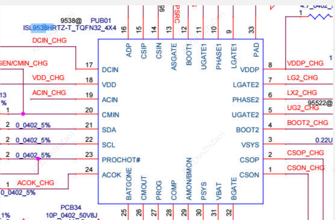

                  The charger on your board is the Intersil (now Renesas) ISL9538CH
                  ISL9538C - Buck-Boost Narrow VDC Battery Charger with SMBus Interface | Renesas
                  The full datasheet is protected so sharing a pinout from my database.

                    thanks, found, is there any voltage I need to check?
                    ps when the motherboard is connected to the original power supply, that component is the only heating if I use my thermal camera.
                    • mon2
                      • Dec 2019
                      • 14677
                      Start with checking very carefully the ACOK pin voltage on this charger ic to ground. This line should be a logic ‘1' and perhaps about 3v3 if the power adapter is considered to be ok.
                      Also note the pin #1 on the chip is where there is a topside dimple and white arrow in the silk screen.
                      • vpower
                        • Sep 2022
                        • 116
                        • italy
                        ACOK as pin 24 is 3.3v

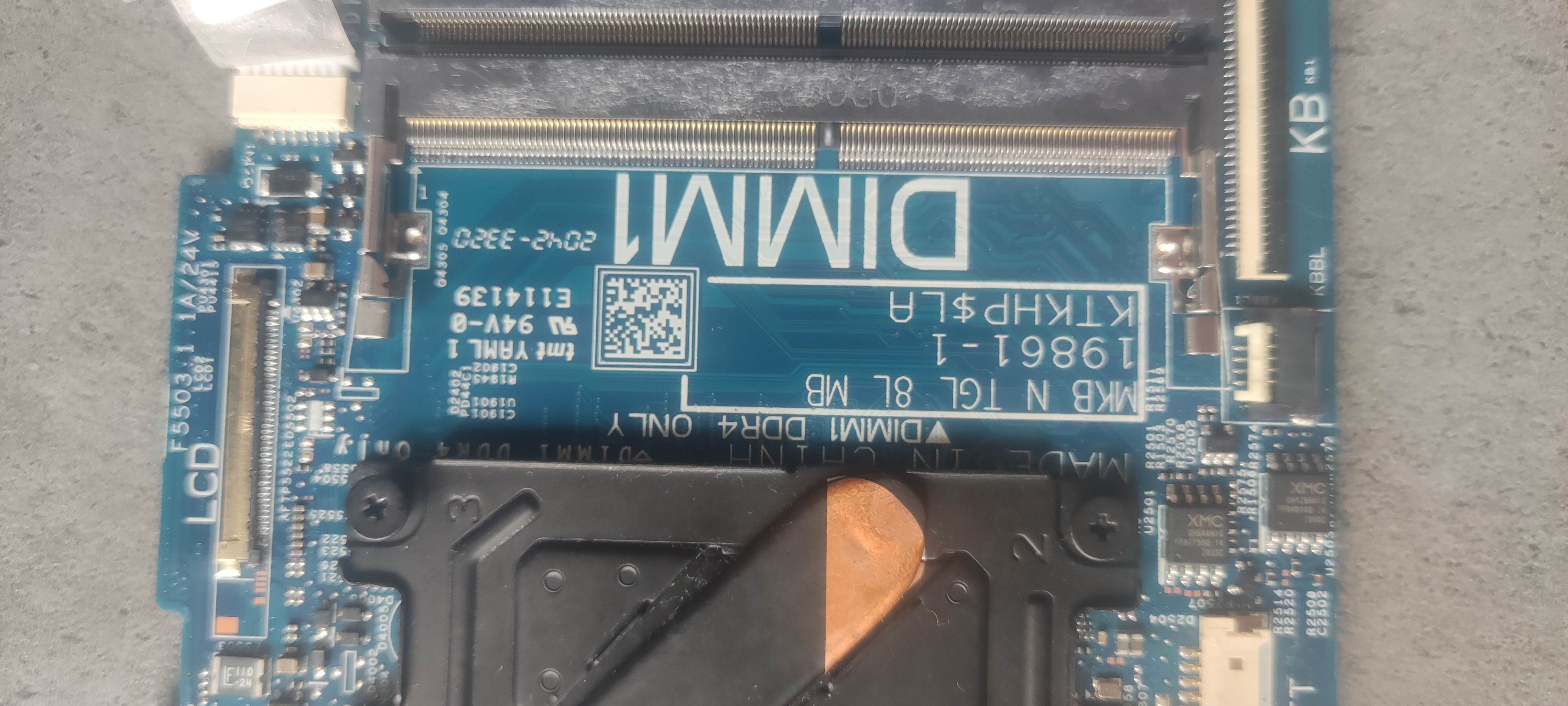

                          First of all mention the mb markings. Remove the stickers on the ram slot and its likely silk screened there. Link schematic,if available.
                          • vpower
                            • Sep 2022
                            • 116
                            • italy

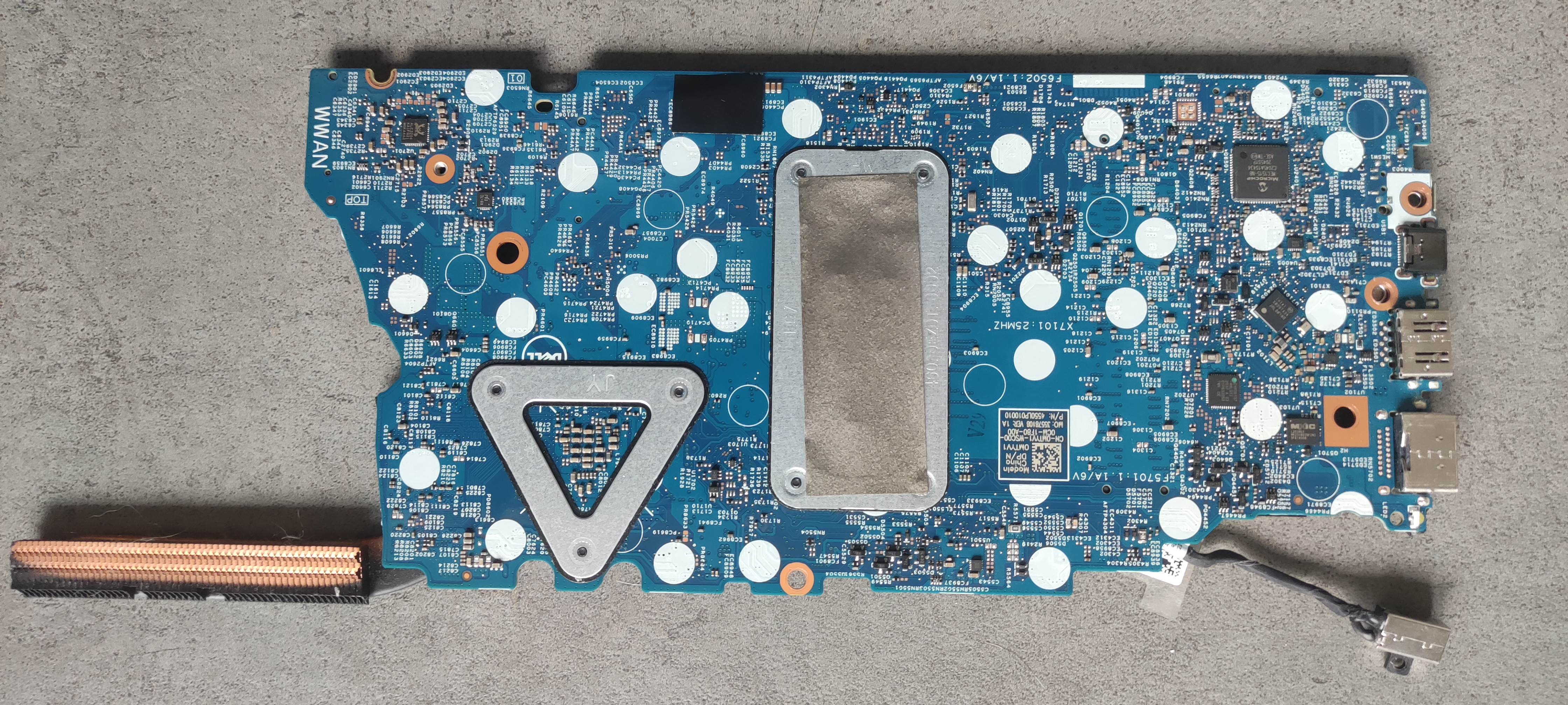

                            I have this under the ram slot
                            • vpower
                              • Sep 2022
                              • 116
                              • italy
                              I think this is the motherboard:
                              MKB N TGL 8L MB 19861-1
                              KTKHP$JA
                              I cannot find any schematics
