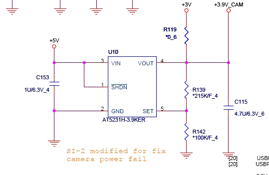

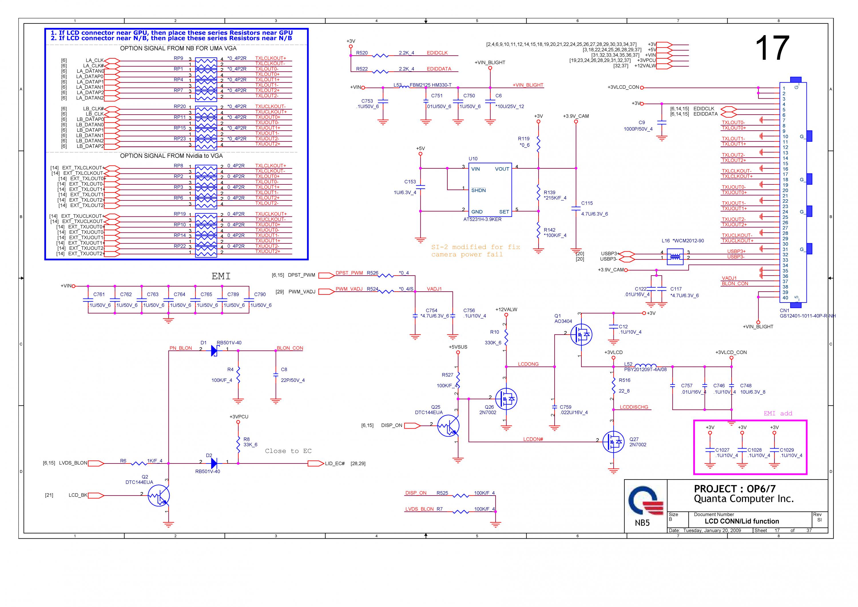

    Hi All! I have one problem at Hp G61-415EL MOBO DA0OP6MB6D0, when my colleague tested Flat LCD, he has burnt IC U10 (5 Pin) at the schematics AT5231H-3.9KER, but i havn't found any datasheet, either no Ic found for sale, only on one site china without image for sale (wrot manufacture: iat, Type: Voltage Regulator, Application: Wireless control) it's all. But the schematics Pin n°4 (VOUT) is the connected to (+3.9V_CAM). Anybody have any ideas, or any information about this IC? thanks!

    I have search in Google, and found many references for that IC. It is a voltage regulator. (+5V-->+3.9V_CAM)
    It only feeds the camera section, (+3.9V_CAM voltage) and you can find it, searching only by first part of its name, (AT5231) but there is many version of the IC, depending on the output voltage.
    Good luck.

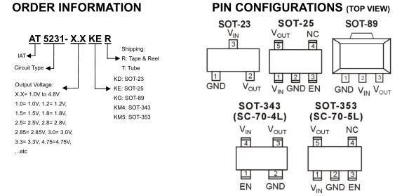

        I have found this data-sheet for AT5231.(Low Dropout Voltage Linear Regulators)
        There are many different packages and pin configurations.
        I hope it helps you.

          Thanks again! It's very useful. Yesterday i have found at Texas Instruments Incorporated TPS79901, TPS78101 and TPS73401, all have same configuration, VOUT 6, 3 or 3.3V, but HP IC the Vout for the Cam is 3.9V. What tou think, which i can select?
