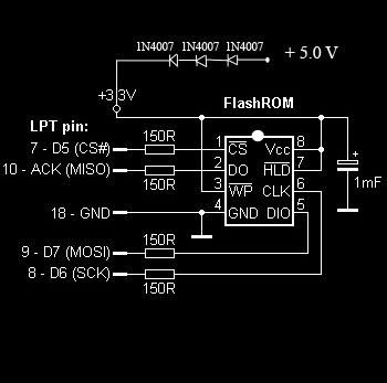

                    you could build the LPT programmer
                    https://www.badcaps.net/forum/attach...1&d=1377112567
                    its cheap and it works pretty good using spipgm. just make sure to use short cables and include a /d=10 when programming to avoid errors. the main problem is getting a good bios dump or modifying the bios downloaded from HP since Insyde H2O BIOS are a bit tricky. try googl*
