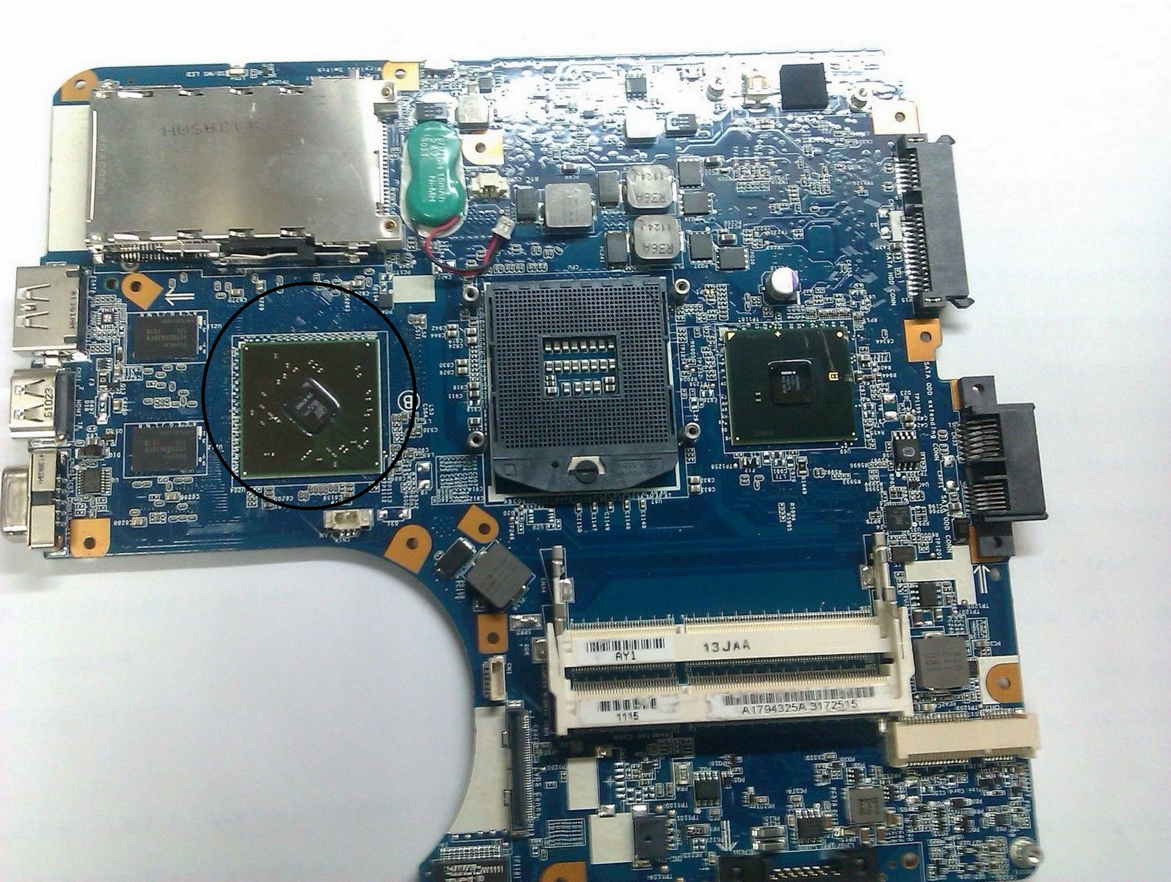

          Hello Friends I bought second hand Sony Vaio PCG-41213W yesterday, It worked well doesn't showed any error or activity for 4-5 hours. But today when I turned it on,it doesn't start, after the windows logo, all lights and display turned off, but processor fan continue running, only stops after removing battery. when I turn it on it runs for 30 seconds, first keyboard's light turns to dim and off, then it produces a sound of spark(short) then all lights goes off and fan still running, please suggest me solution,, thanks
            that`s why they sold it!
            they knew the video chip its bad.
            you need a reball for that chip or swap

              hey thanks dj_ricoh for support, can you please tell me from where I can get that video chip? and is it easy to replace that video chip?? or should I swap the motherboard? please suggest any online web store for both solutions, that can send items worldwide.
              thanks..

                  jaspr> do a reflow and u have it worked for few month/s
