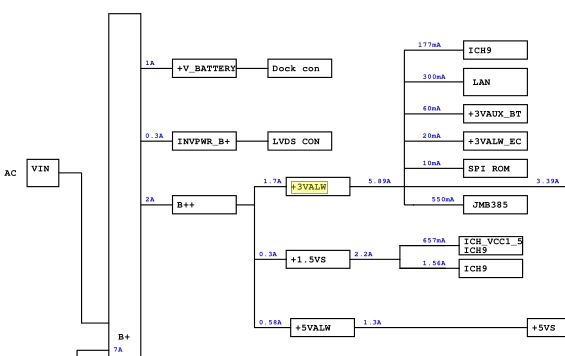

    Has anyone ever worked on these laptops before?
    Power supply works 100%. Tested various connections on the MM and I get my 19v; ground connection, on MM, and + terminal on dc jack . Any pointers of where else to check?
    Regards

    Re: HP Compaq 2710p: No Power; No Sign of Life
    Do you know if it is able to charge the battery?
    Is there 19 volts in the output mosfet of the charging circuit?, also check the 3,3-alw and 5-alw voltages.
    Check also if there is voltage in power button terminals.
    Post results.
      Hi.
      I cant seem to find a schematic to locate the mosfet. Also what is 3,3-alw and 5-alw voltage?
      And yes I get voltage at pwd button switch pins (19v)
        I can´t find the schematic either, but all laptops have a regulator circuit that feeds +5VALW and +3VALW like in the follow screen capture.
          Do you want to say that you have 19 volts in power button switch?
          I think there'll be a mistake, 19 volts is too much.
          And what about charger circuit?
