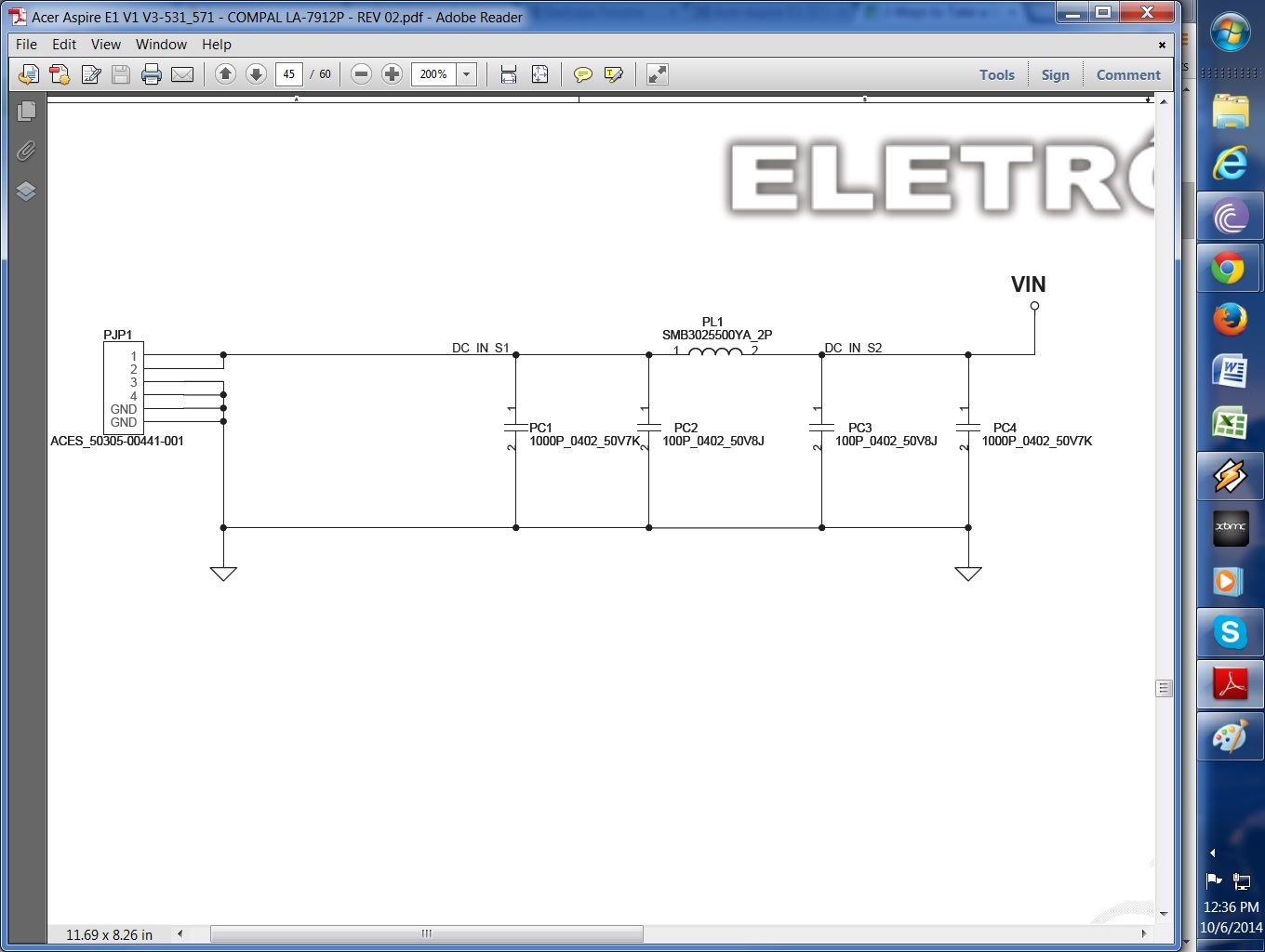

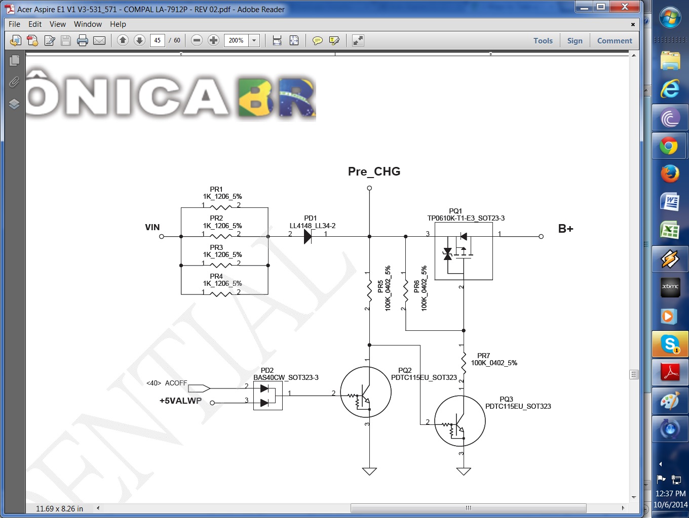

                                    Hey Guys,
                                    I am also working on an Acer E1 531 with the same board as above. No power whatsoever but I do get 19 v to the 4 pin connector labeled PJP1. I'm getting ready to test the individual components of the DC In and charging circuit and realized I don't know what outputs I'm looking for once I get past the first few capacitors and the one inductor. Once i'm into the charging circuit and things get ugly for me. Limitations of my knowledge really start shining. What kind of voltage should I expect once I get through the 4 parallel resistors? lol I know newb right. Here I am with pen and paper ready to rock out a power formula ( P=V2/R) . Any guidance would be greatly appreciated.
                                    • GSAW
                                      • Oct 2014
                                      • 3
                                      #38
                                      Re: Acer Aspire E1-571 no power
                                      Just an update on my findings, hope I'm not being a nuisance here.
                                      P09 = 19 V on one side and 0 going out
                                      P010 = .05 V one side and 0 going out
                                      P08 = 19 V one side 0 on the other
                                      PL1 =19 V both sides
                                      PR41= .05 both sides
                                      PD1 has -5.25 going in and out it fluctuates quickly from 0 all the way up to -4.45
                                      PQ1 = 0.05 v going in and 2.03 v and 4.46 going out
                                      To me this means I should be replacing P09 and P010 and possibly p08 resistor.
                                      I realize I'm prob not listing these numbers in the proper way and that my ignorance is legendary but any help is greatly appreciated, thx in advance.
