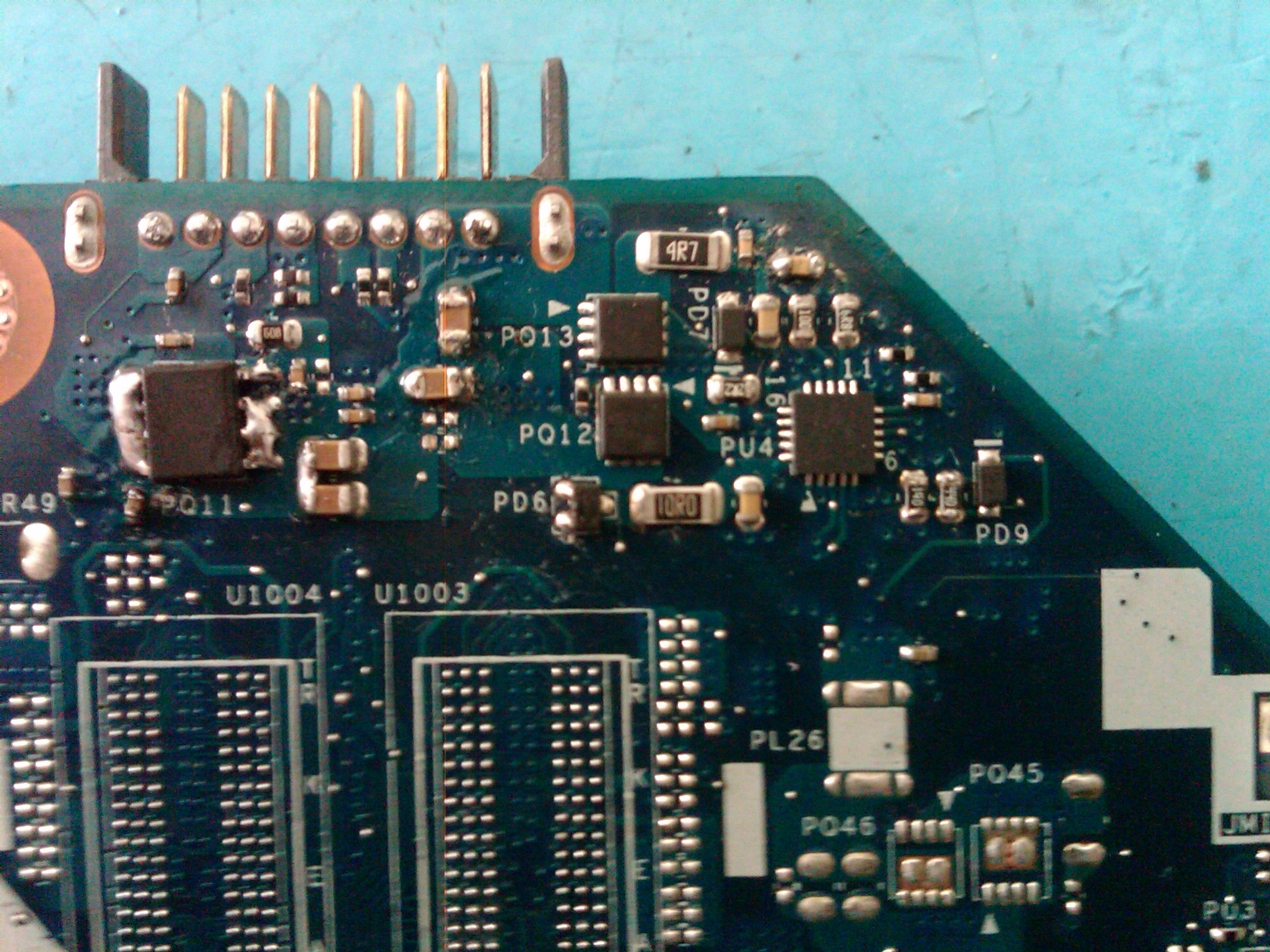

    Good day to everyone. I hope you guys can help me regarding this acer laptop. This just came in yesterday, the owner said it has no power and no blinking lights. I've tested the power adapter and it is perfectly working. I did disassembled it and found horrible images of a repair done by someone who is not careful.
    To fix the problem, I tried to look for a schematic diagram of its motherboard over the net but I'm very unlucky and cannot seem to find one. I figured that someone here might have copy or something that could help me fix it.
    Here's the exact model of the laptop: Acer Aspire E1-571-32324G32MNKS and also this is printed on the motherboard itself: Q5WVH LA-7912P Rev 1.0 2012-03-22. Hope to hear from you guys. Thanks very much in advance!
    I think somewhere here could be the fault:

    Re: Acer Aspire E1-571 no power
    Could be a shorted MOSFET near the coils.
    Anyway, here's the schematic that is closest to what you are looking for.

          Guys I need some help again, could somebody please help me identify which pin of PU4 (BQ24725ARGRR) gives voltage to charge the battery. I've been reading the datasheet and can't identify which pin that gives charge. The battery is detected but still does not charge. I can power the laptop using the adapter. The battery is confirmed working. Hope someone could help thanks!
          here's the exact image of the motherboard:
          • whaldsz
            • Apr 2013
            • 395
            • Philippines
            Here's the data sheet bro, pin descriptions are on page 12-13.

                  Which of those pin gives charge to the battery. The reason why I ask is because the battery isn't charging when connected to laptop. tray icon shows how much battery left but also indicates that it is not charging. I figure that the previous person who attempted to fix the motherboard might have damage some components which cause the battery not to charge.
                  • whaldsz
                    • Apr 2013
                    • 395
                    • Philippines
                    none. pin 11 drives the gate of the mosfet PQ11 to give B+.
                    pin 10 (ILIM) is the one responsible for charging the battery. Voltage should be above 105mV to enable charging.

                            Try to measure the voltage at pin 10 and observe the voltage if it is rising or falling. It should enable charging of your battery when the voltage exceeds 105mV.
                            Also, the resistors you mentioned is a voltage divider circuit. whatever the exact voltage of your +3VALW (which is typically 3.3V), you should have +3VALW * 100K/(100K+316K) = 79mV at that pin.
                            If PR61 (100k ohms) resistance becomes lower than 100k ohms or PR58 (316K ohms) becomes higher than 316k ohms, then pin 10 will never become higher than 105mV. This is one logical explanation why the battery would not charge.
                            Of course there are other components that may contribute/cause this problem - battery not charging. But to cover all cases, please refer to the datasheet on page 22 or see attachment, you can read the conditions when charging is enabled or disabled.

                              Good day. I measured pin number 10 of PU4 and I got .82v on the meter. 3.34v is present. At PJP2 pin no. 1 and 2 to has no output. I also placed a cap on the location that I think its missing one. Please refer to the attached image. Battery still not charging. thanks again.
                              • whaldsz
                                • Apr 2013
                                • 395
                                • Philippines
                                Do you get 19v at P2? Is ACOK pin high?
                                .82V indicates the state is not charging. This could mean the one of the resistors has changed value.

                                  After days of exhaustion, I've managed to solve the problem. The battery is now charging This is made possible because of Sir whaldsz effort to help me. Thanks again sir
                                  I cannot point to what component really is at fault because I have replaced 3 components, (PQ11) and two resistors on Pin #10 of PU4 that Sir whaldsz mentioned. I also reflowed IC PU4. So I guess 1 of those might have fix it. And also I kept reading reply #14 of Sir whaldsz and the attachment he included. Understanding it is very hard for me considering I have no idea how to read schematics and don't know how to identify components.
