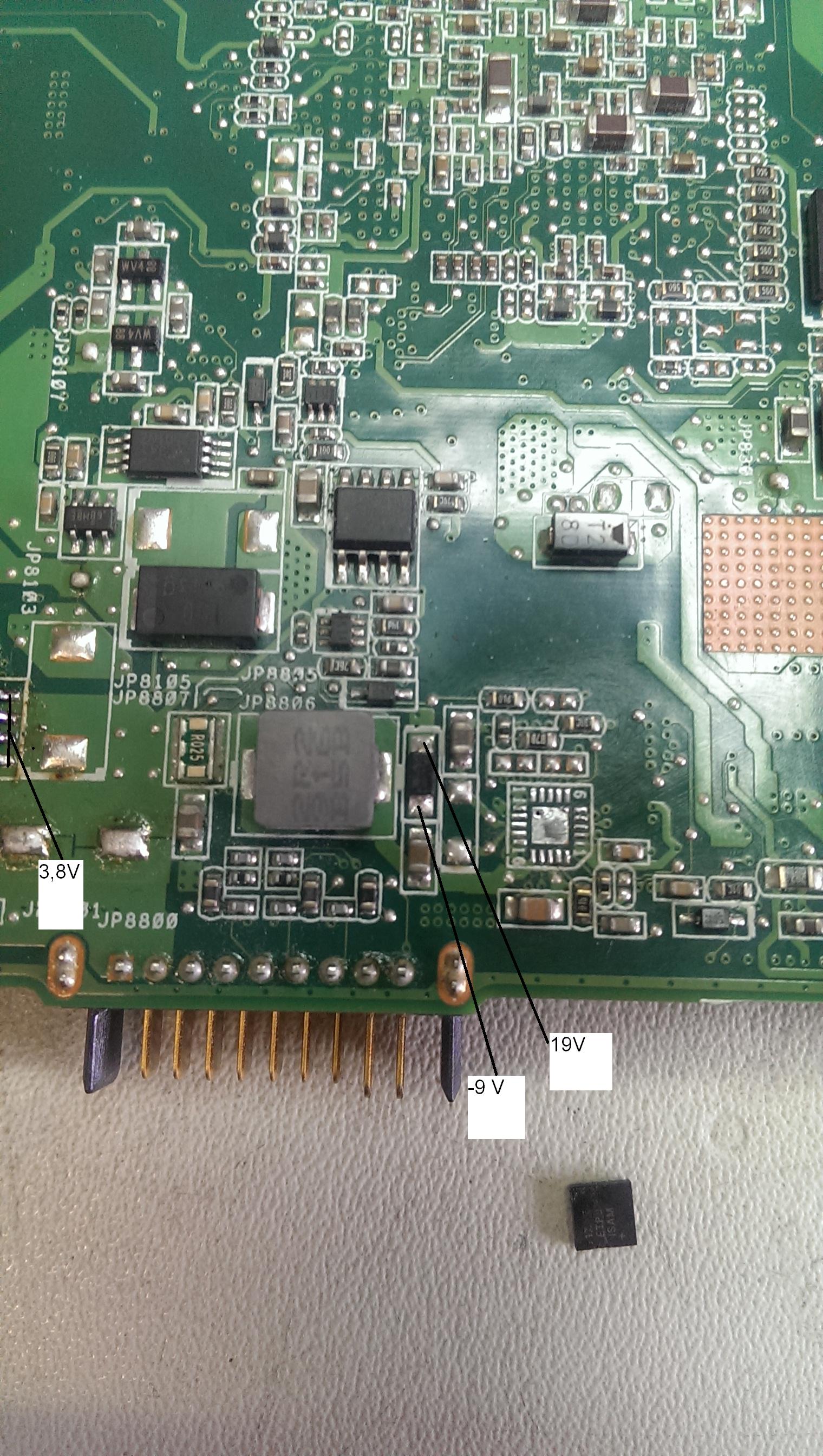

    I have a Laptop and missing 3.8V on mainboard.

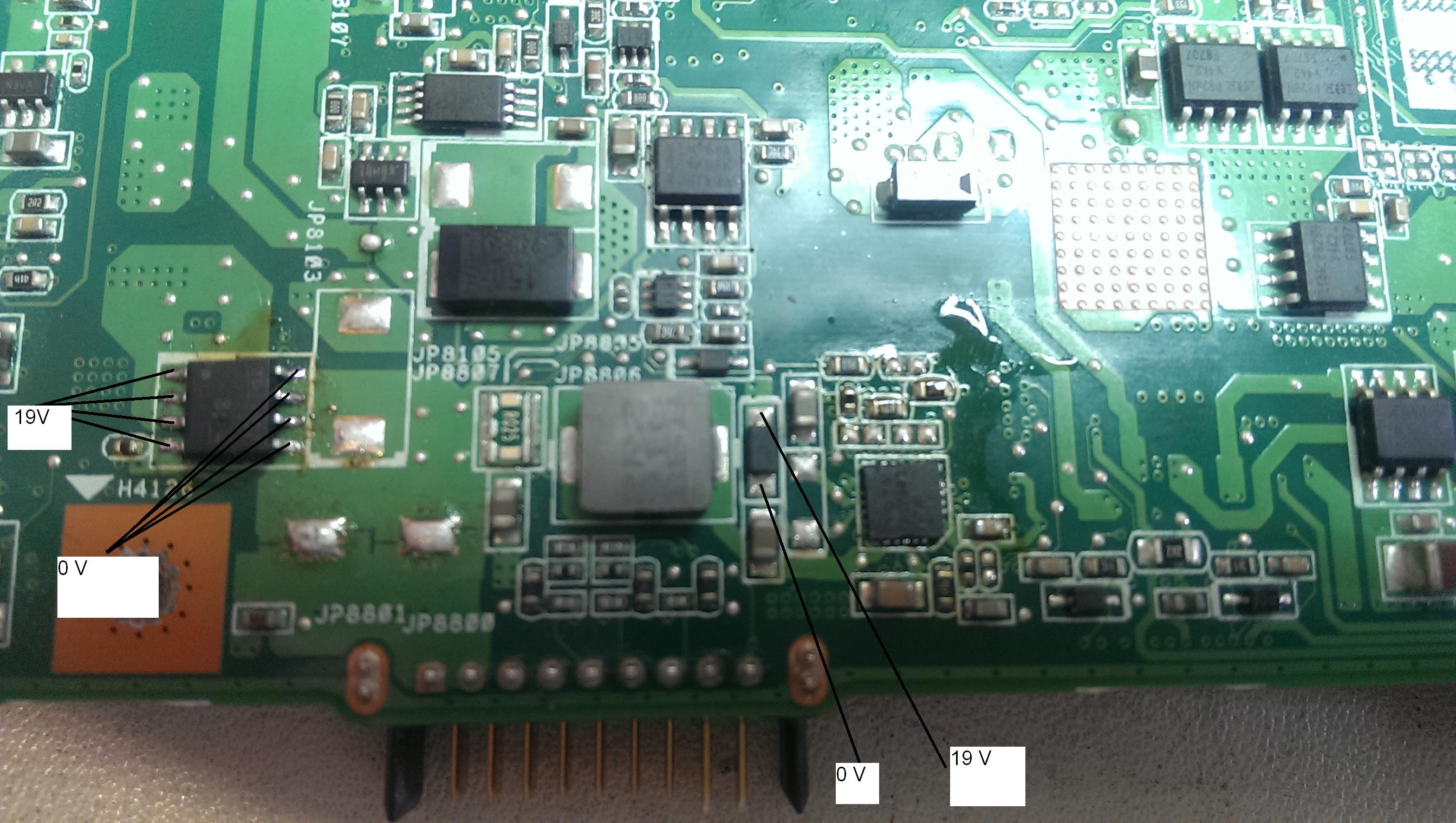

        Hello
        here is an Image and Voltage before i removed the QFN.
        (No power, no Leds and no Fan goes on)
        and here is the Voltage after i removed the QFN
        (Power goes on and green leds to be glimpsed)
        On the QFN i can see following Information:
        • 17015
        • ETP 915 (or 916)
        • ISAM
        I think its a power QFN but i'm not sure.
        It can be a MAX 17015 ?
        I can not say anything without schematics.
        thanks
        erkan

          Re: Asus Pro61S dont power
          it is maxim 17015A. it is charging ic.(şeması yok ama bom var. ordan baktım max17015A)
            I also thought the same thing that this is a Max17015A and this morning i ordered 5 pcs.
            Hopefully i get my order on Wednesday.
            I'll tell you after I've changed this part.

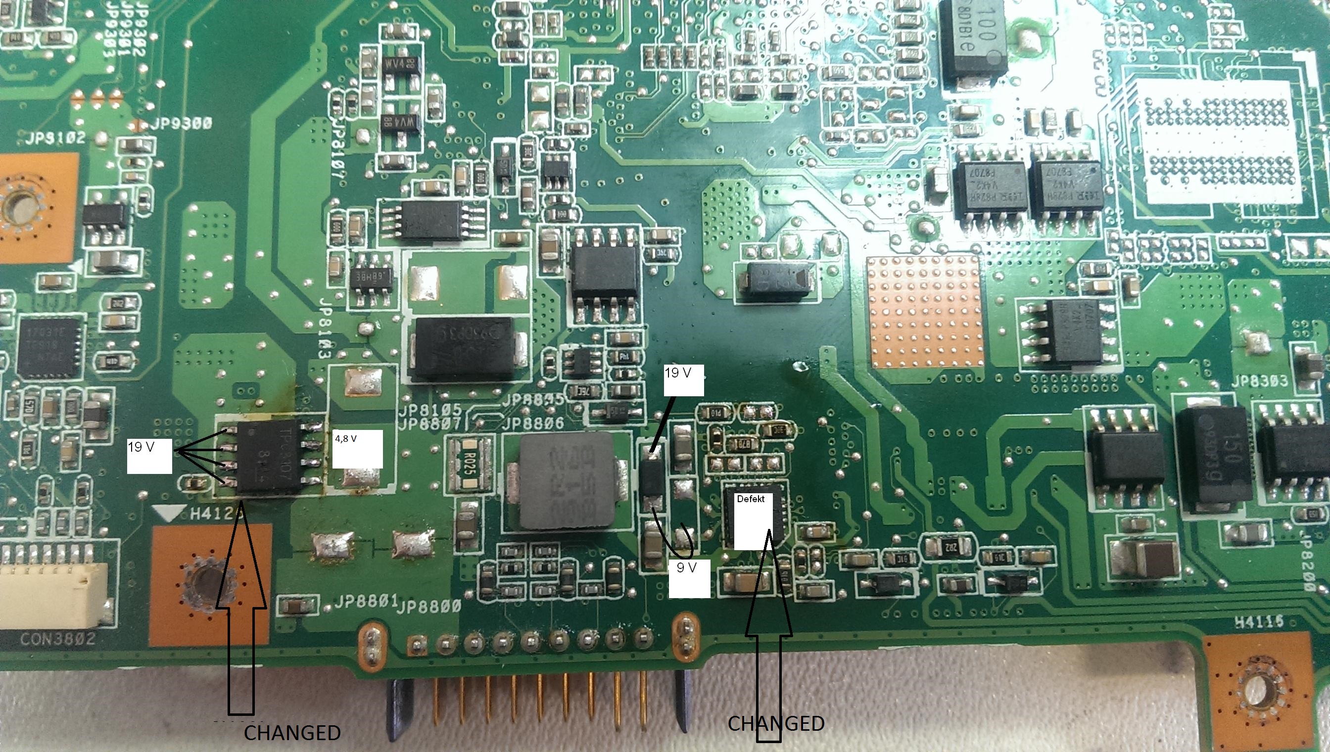

                  i have changed 2 components: look at the picture and Laptop lives again.
                  Power goes on and charging is ok.
                  Now I have not 3.8V but ~4.8 V
