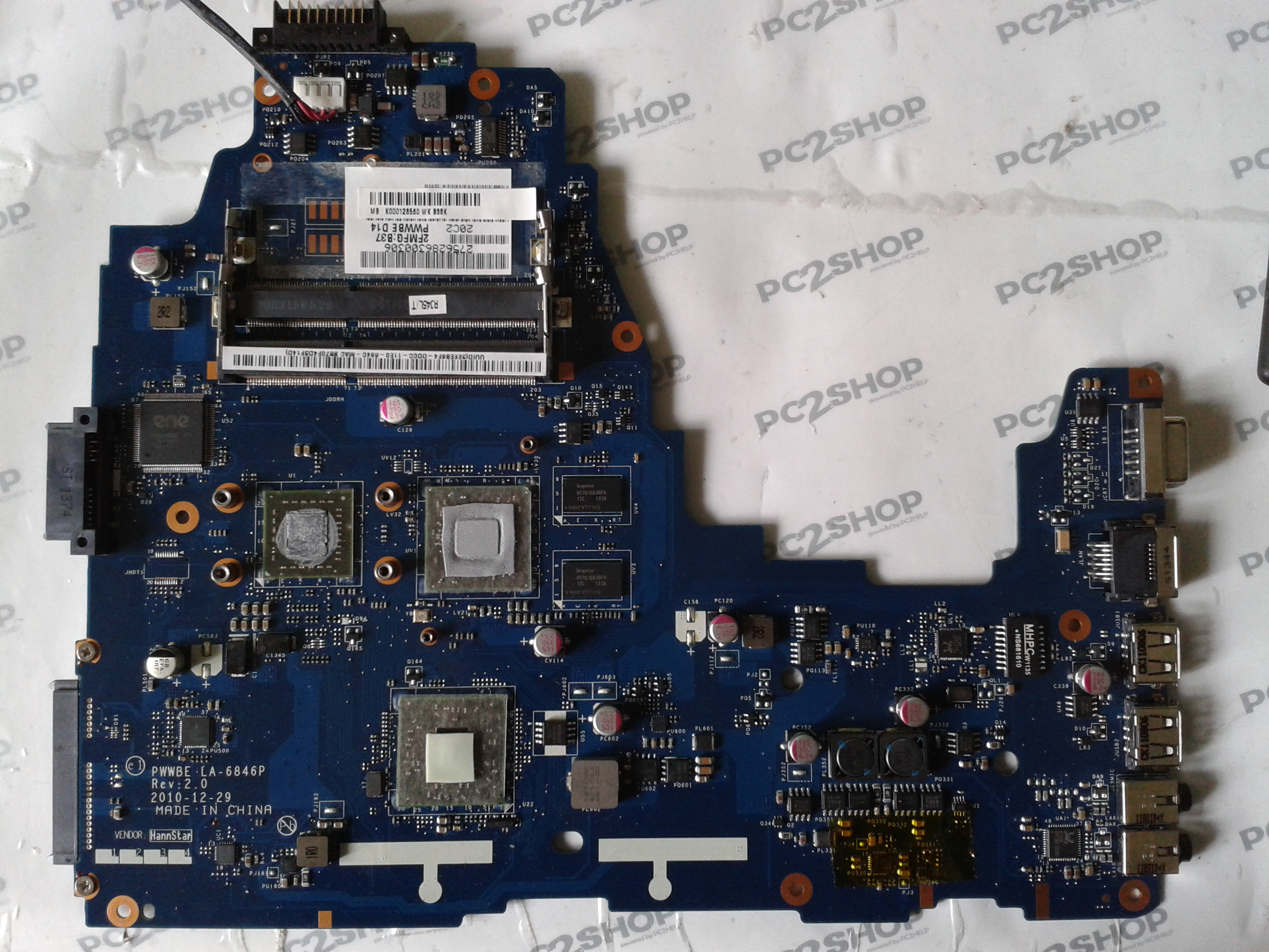

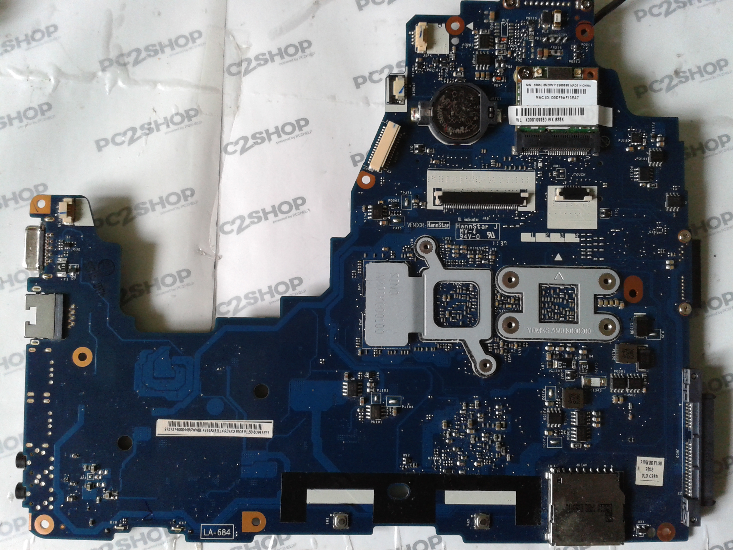

                          Greetings,
                          I am facing the same problem here and I am not able to find the exact schematics for this mobo ( PWWBE LA-6846P REV:2.0 ).
                          I tried to solve it via LA-6842P Schematics but it seems to be different.
                          Has anyone located the fuse or the schematics?
                          Thanks in advance.

                              You got any hi-res pics of the board? Some Toshiba boards I've repaired recently have had odd sort of fuses that look like resistors.

                                  Re: toshiba c660d laptop
                                  Hope these attachments help.
