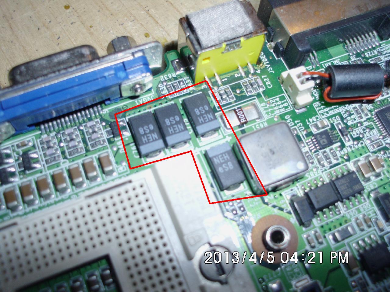

                I do wonder, what capacitors are used in laptop VRM's... It looks like they never did failed...

                  Contrary to the problems with the capacitor made by 'nec-tokin' in toshiba laptops, my laptop doesn't have one. It has a handful of smaller rectangular, black capacitors.

                                  Re: laptop died - GPU needs reflow?
                                  @ben7
                                  Something like this, see picture, they're probably the same (or very similar), some kind of poly, but (pictured) ONLY 1000 h at 85 degC, those on the picture are NEC-TOKIN, so called NEOCap....
                                    HA yes they look just like that. 1000 hours?! That isn't nice. I'm sure they ran quite close to 85C, if not more!
                                    Now I do wonder if one has gone short, or the like!
