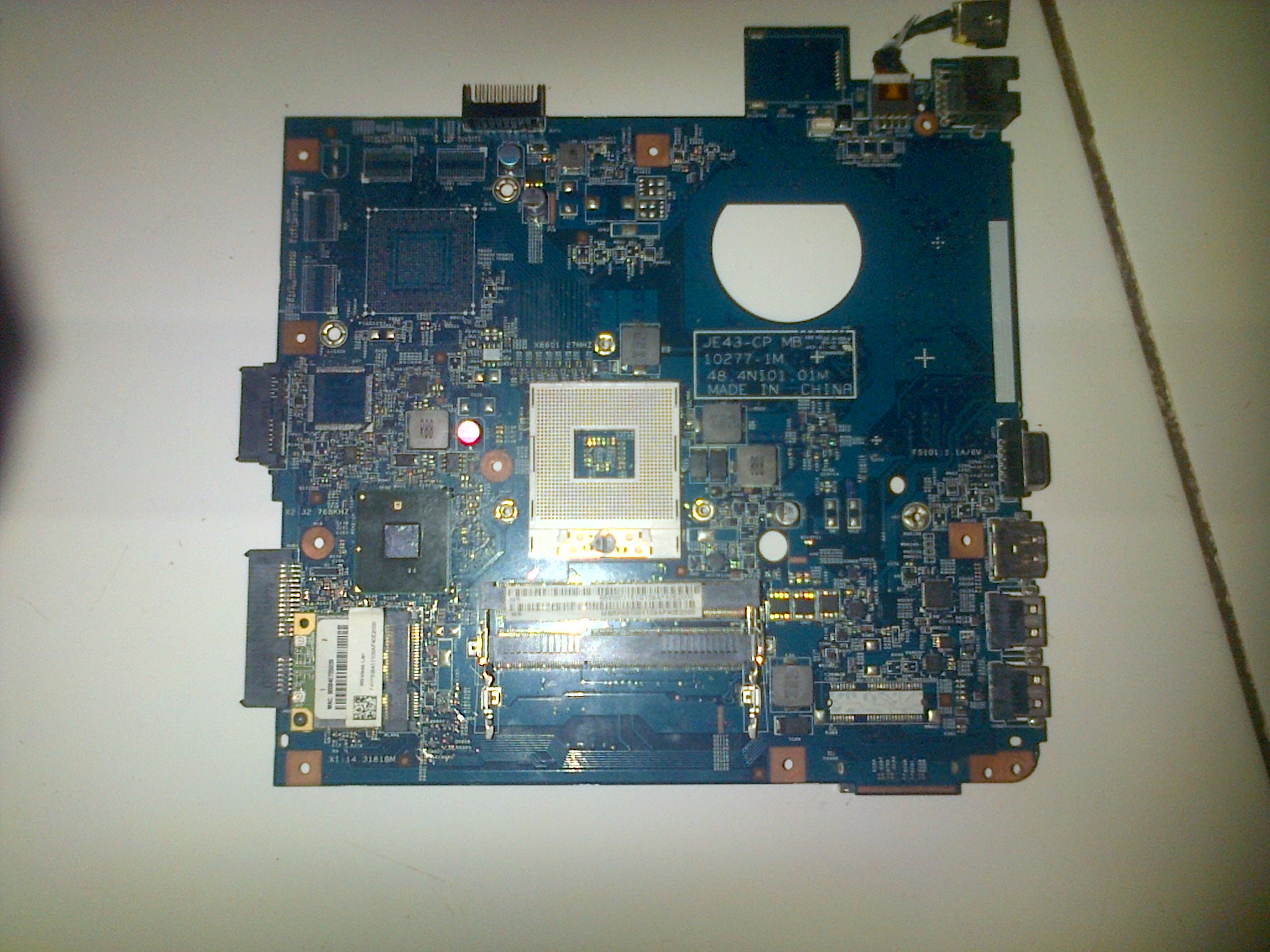

    hello
    how are his best friend
    I have a new problem.
    acer 4743z not live
    I press the on / off
    handy with a time of 1 second and then turns off again

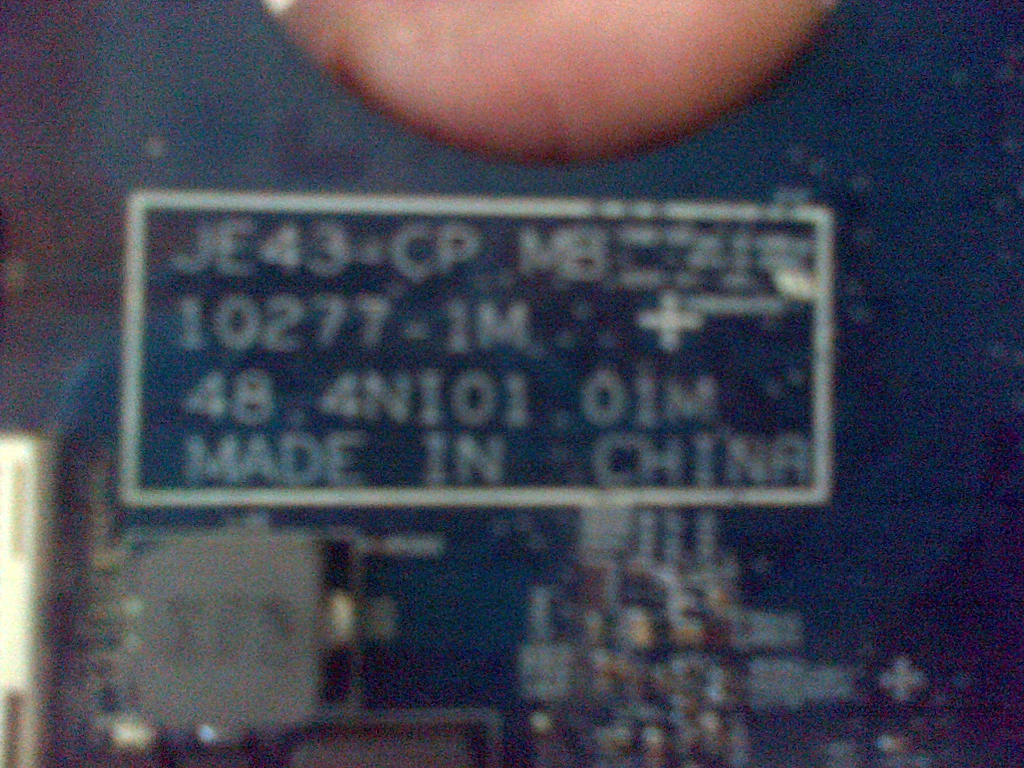

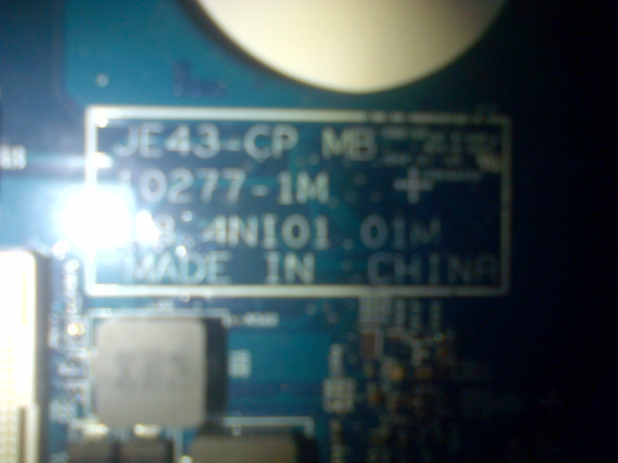

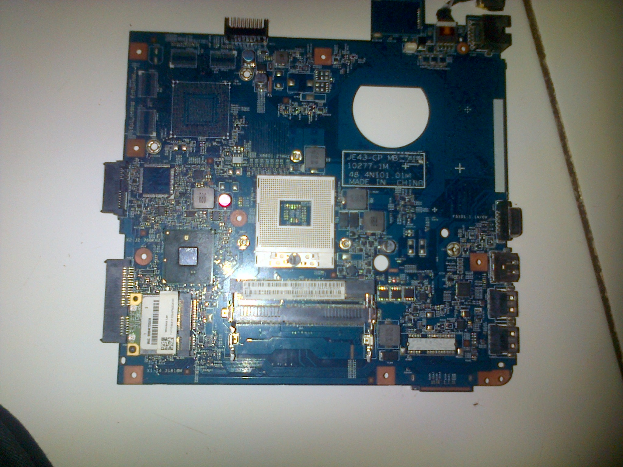

            Can you post the schematic or the code number of the motherboard?

              Re: Acer 4743z power button problems with one second
              sorry pal
              I just come back online
              I am posting some pictures that you requested
              sorry if the picture is not good

                • Francisco.s

                  In this link, you can know how to identify the motherboard, in order to obtain the right schematic for your motherboard.
                  http://laptoprepairegypt.com/blog/2012/11/27/test/
                          ok
                          thank you Francisco.s
                          I have found the source
