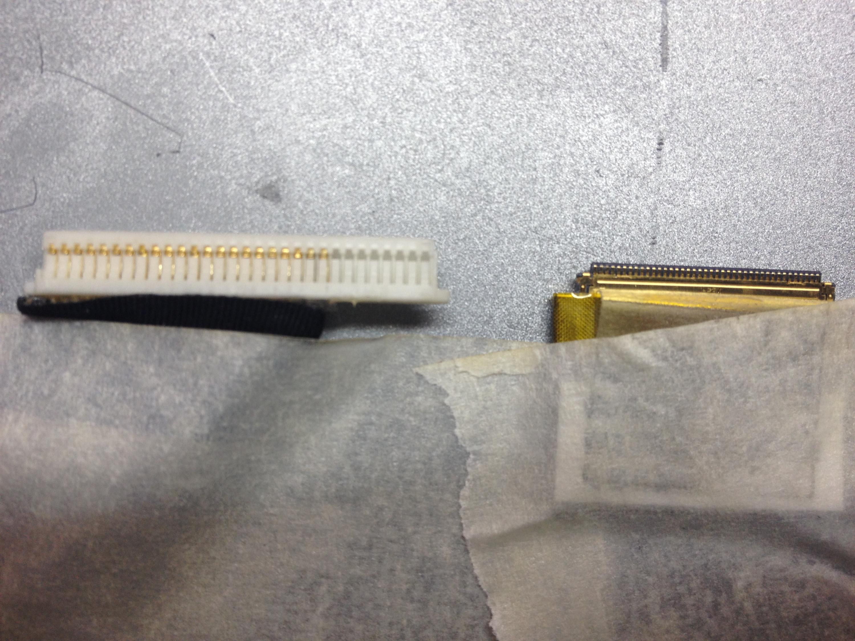

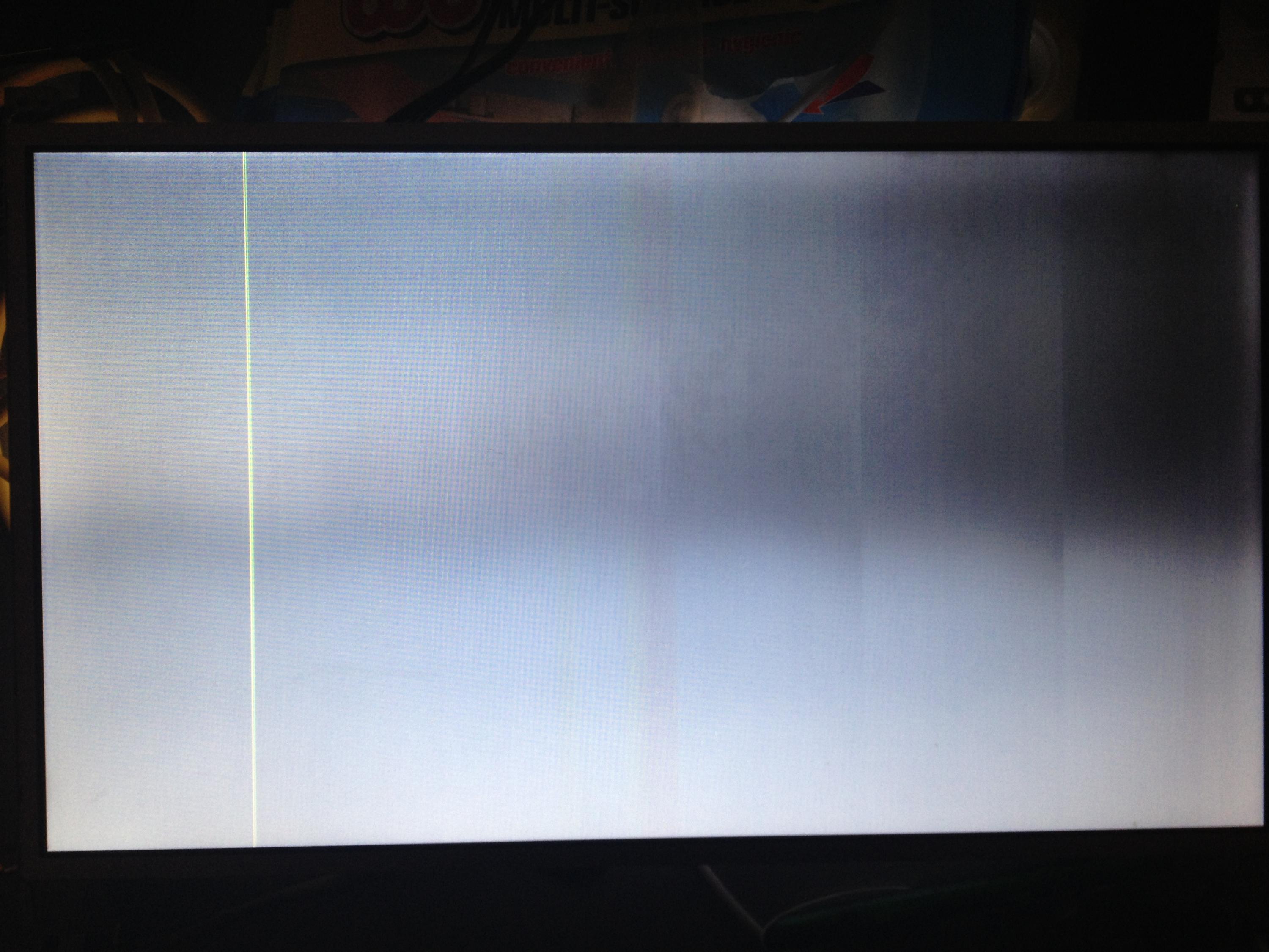

                          Re: Compaq 610 white screen
                          i check them, but they are not parallel, and for one wire i could not find a match. I uploaded the picture of LCD when ON, maybe it would help to find problem.
                          ...the quieter you become the more you are able to hear...
                          • selldoor
                            Slow Learner
                            • Dec 2010
                            • 7870
                            looks like a bulb is failing at one end -does it always look black there.
                            There is one yellow pixel line which is possibly panel damage - is that always in the same place - does it move at all if you wiggle the cable?
                            Perhaps a picture of the cable and close up of the connectors would help.

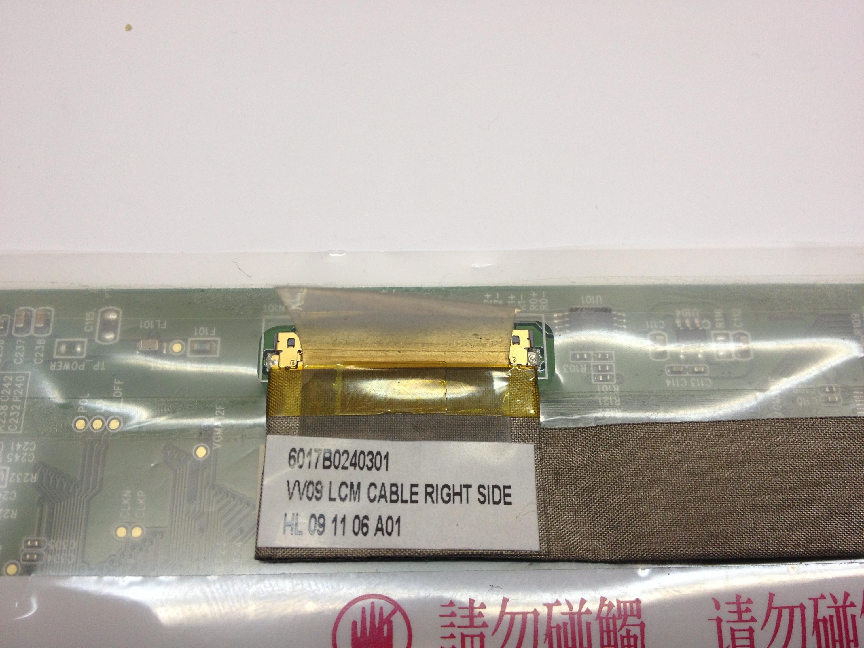

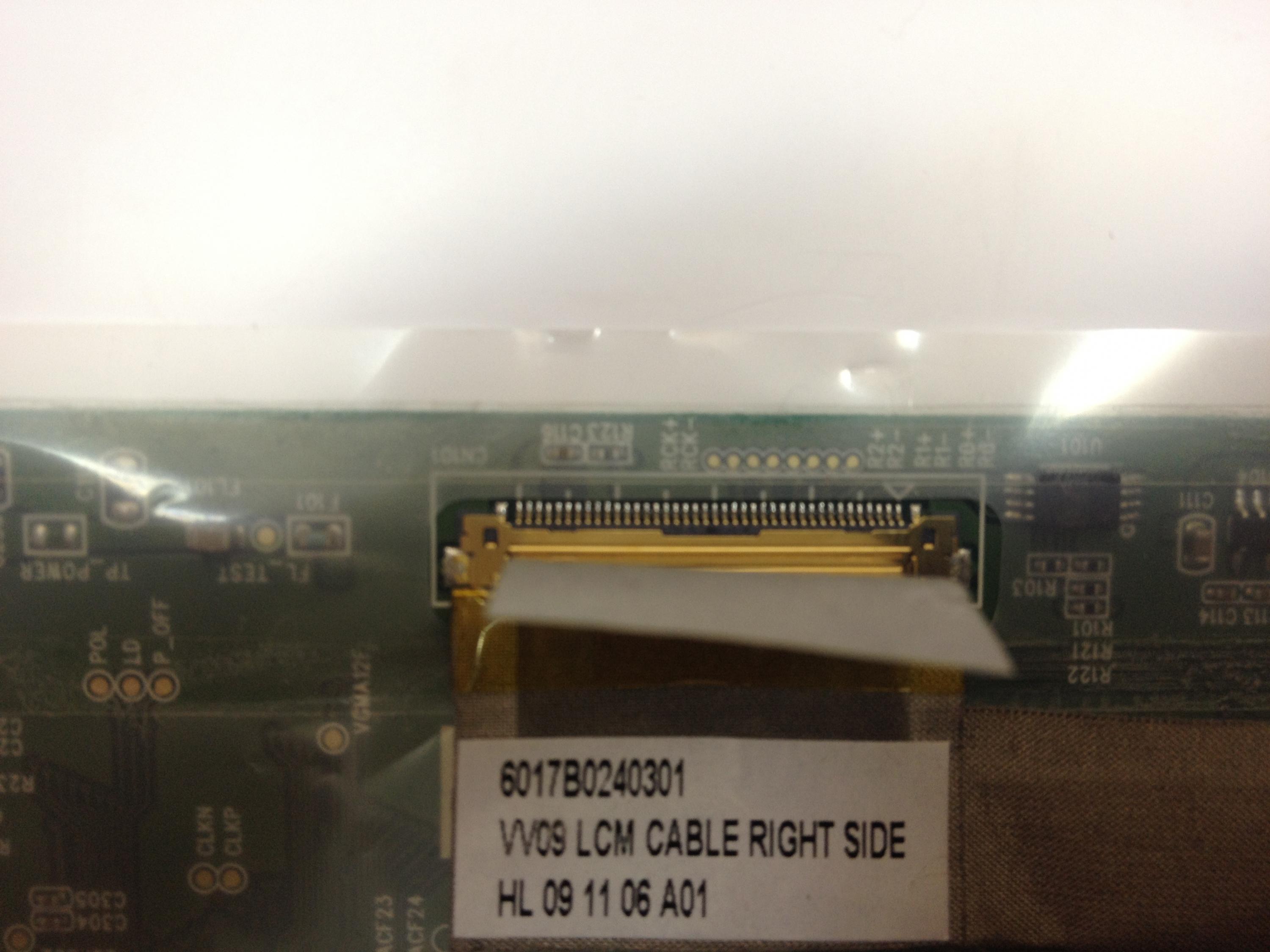

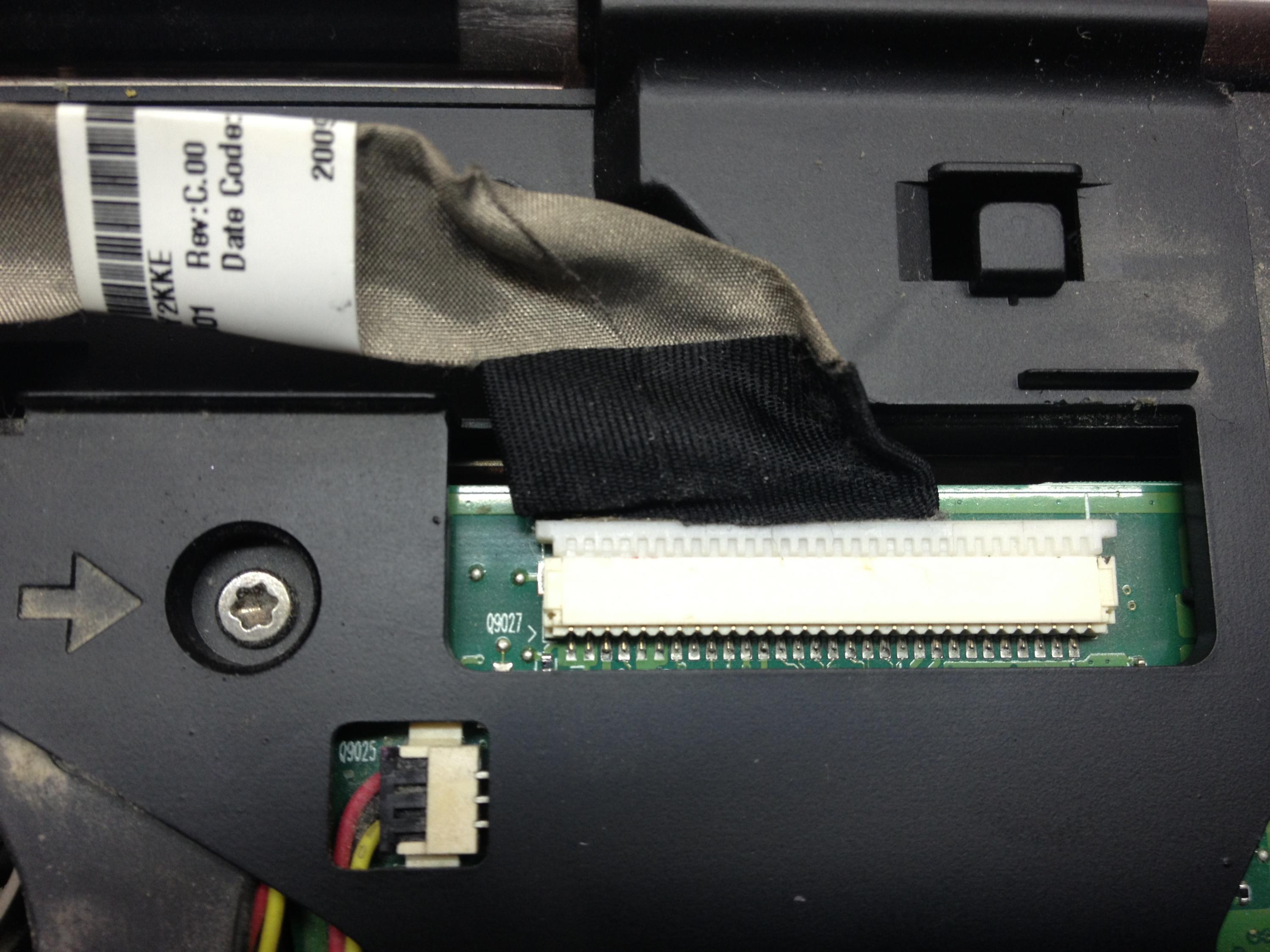

                                  My friend (owner of notebook) say that problem first begin with that yellow line, and after a 2-3 month whole screen is white.
                                  Yes it is always on the same place every time when i start it. I try to wiggle the cable but no effect, nothing changed.
                                  This lcd do not have bulb as it is LED, no inverter.
                                  Here is more picture.
                                      So i need to change lcd pannel, just wanted to be shure what is bad lcd or flex.
                                      • trebo
                                        • 514
                                        • Wales, UK
                                        could be faulty screen or flex cable
                                        my guess its screen failure
                                        can you swap a screen from another unit just to try, before buying one
                                        EDIT, daft question but have to ask, can we take it that you have cleaned and reseated connections to screen and M/board???
