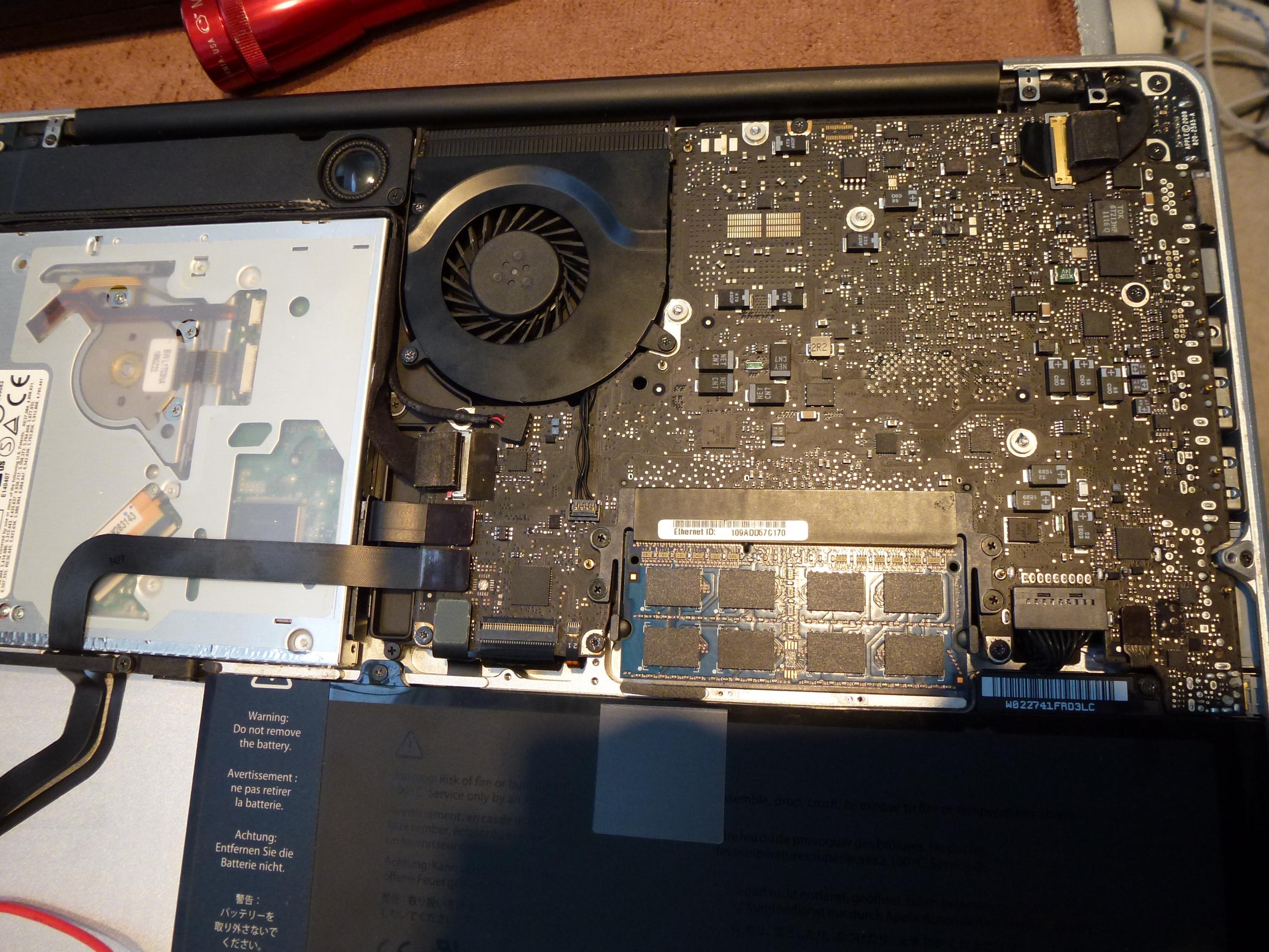

    I have another one of those 13" Macbook Pros (2010) that have no power.
    Pressing the power button does nothing. No fan spin, lights, nothing. I have checked the power button operation (pins 5 and 29 on the keyboard socket) and it drops the 5v on pin 5 to zero when pressed. I guess its working.
    The fuse near the power plug is good as well as the other 3? green fuses.
    The charger seems to work normally. Green, then orange, then green again, showing a charged battery (I guess). Tried two chargers.
    I get an occasional 19v at the battery. It seems that the charging circuit intermittently checks and sends a burst to the fully charged battery.
    I tried a reflow of the Nvidia chip and no change.
    These boards are selling used for about $300 and it seems to be a widespread problem.
    Could it still be the Nvidia chip?
    Any other ideas to diagnose this?

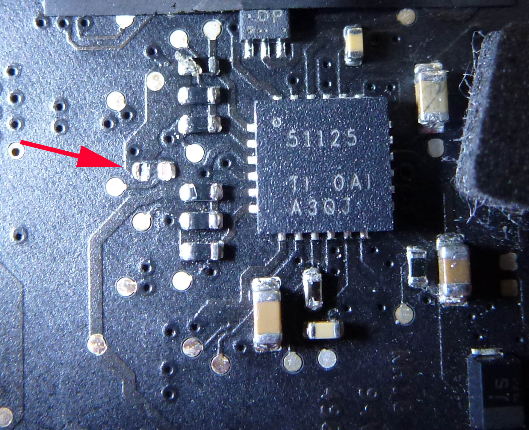

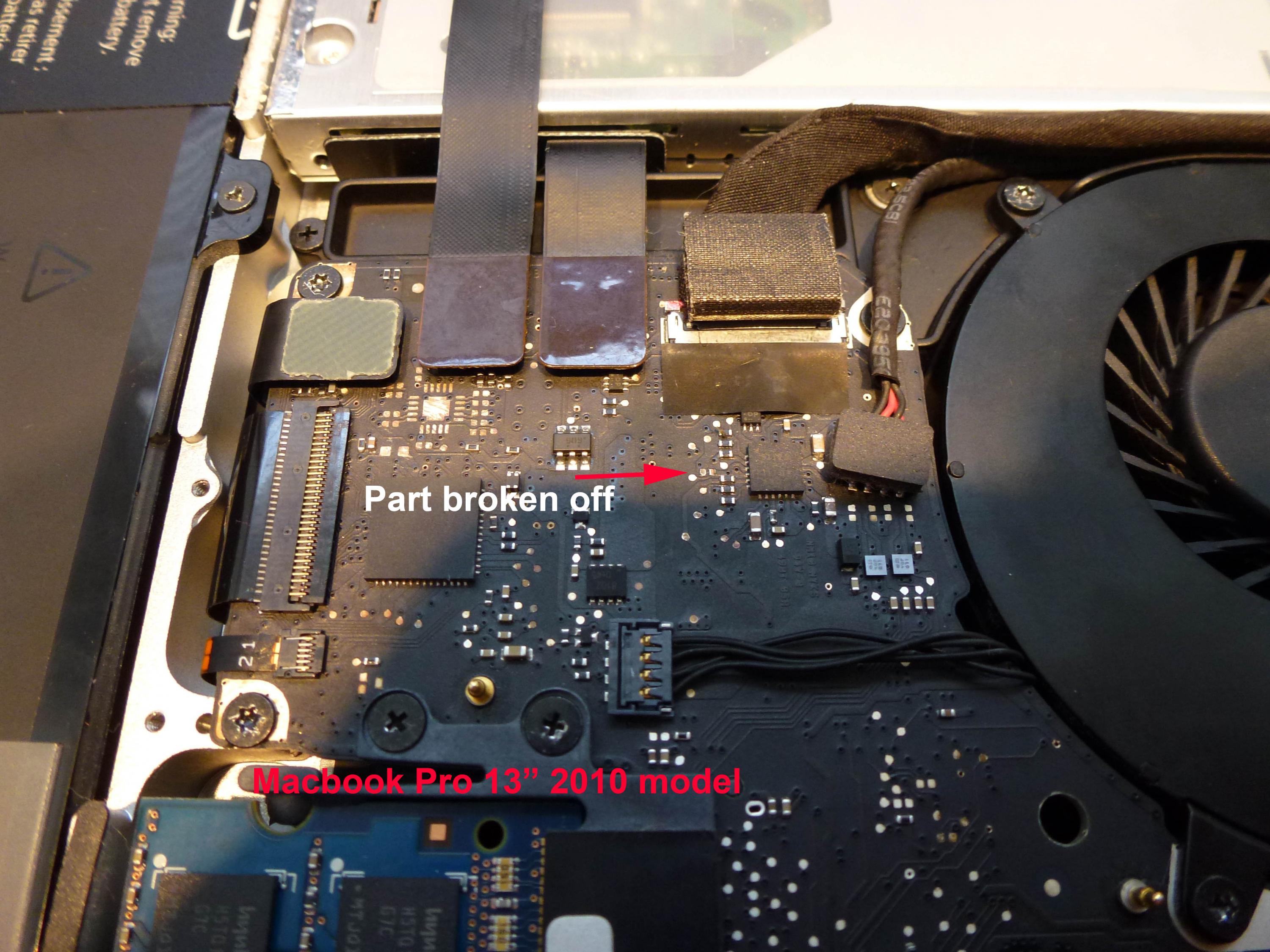

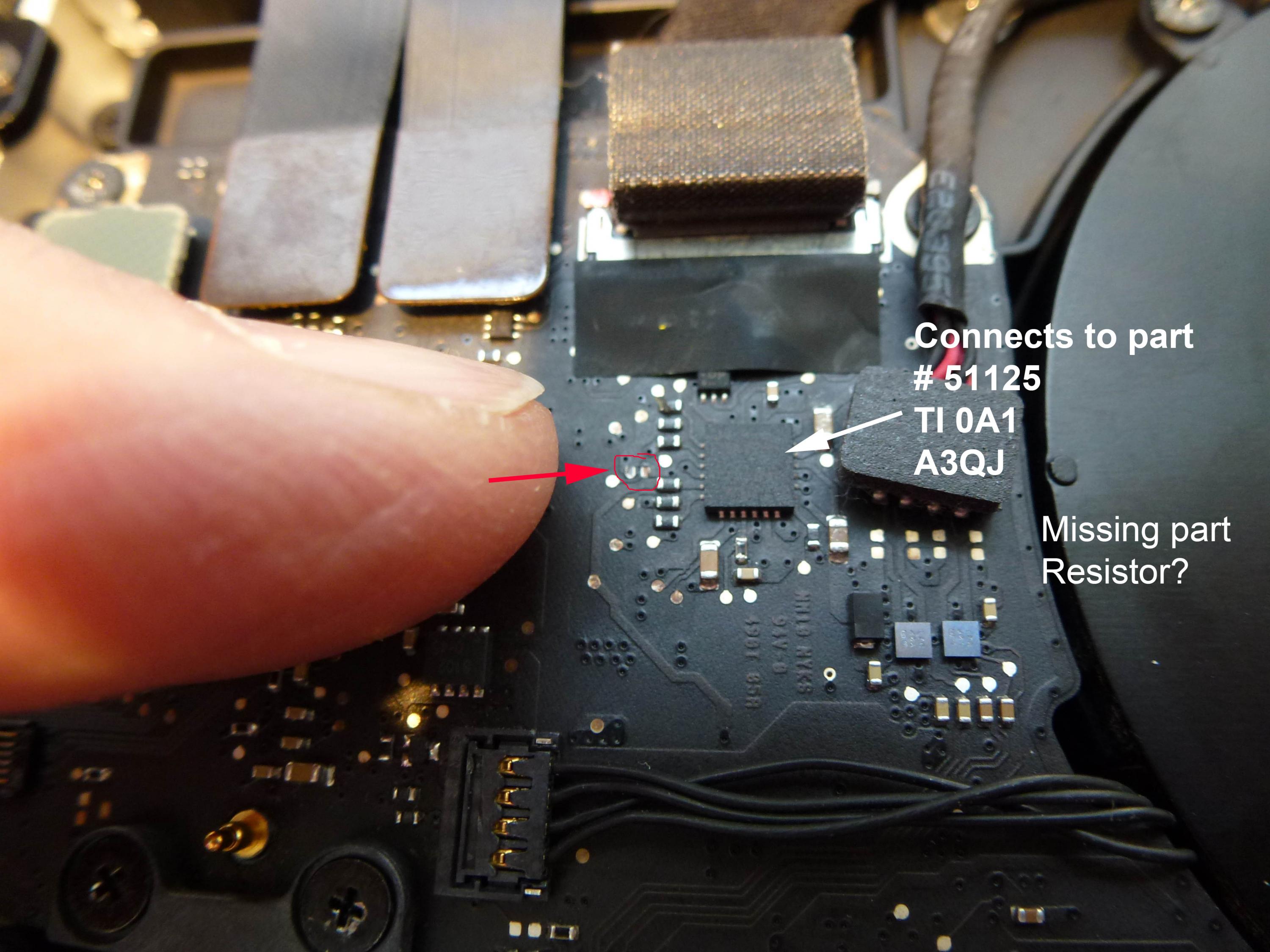

    Just by chance, I see a tiny resistor (?) is broken off the motherboard.
    If I did it, then it's an additional problem.
    I don't think I did it, so maybe this is the whole problem. I bought this laptop like this.
    It is part of the circuitry for part #51125. There are other resistors also connected to #51125.
    It's clear to see in my photos attached.
    I'm willing to try soldering a microscopic piece on again, if I can find a replacement. I do have a number of motherboards around that I could get it from.
    I would need to know what it is and its value. I assume it's a resistor.

      Maybe you can start from here http://www.ti.com/product/tps51125 if you don't have schematic for this model. It's look like resistor 20K Ohm if we read the datasheet. I Hope it help

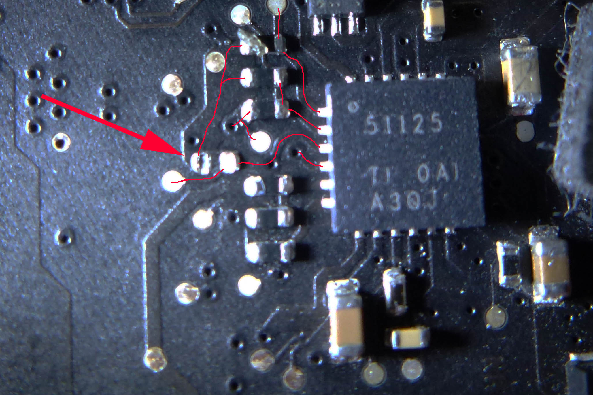

          I'm having a hard time trying to decipher the datasheets.
          It looks like my "resistor" is connected to pin#3 (vref) of the chip, but another datasheet rotates the thing 90 degrees and confuses me as to which pin is which.
          Usually pin #1 is at the "dot" on the chip. Right???
          Anyway, if this is pin #3, then it has a .22uF Cap connected directly to it.
          Pin #2 has a 20k resistor.
          Can I verify anything by measuring a voltage there?
          Thanks much.
          Richard

            I measure 2.6v dc on the missing component connected to pin #3.
            And 0v on the other side of the missing component space.
            Any help?

              pin #16 is VIN , measure if you get adapter voltage, start from there to find pin direction #1 . But if you get 2.6v on pin #3 ( VREF ) maybe you are on the spot , I think . Good luck

                The component you are missing is an .22uF Cap
