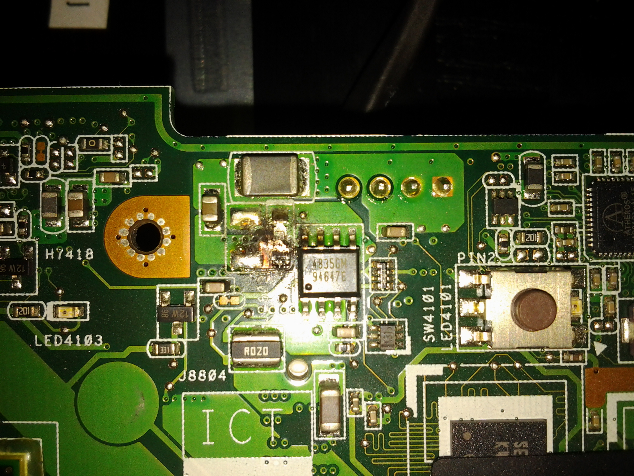

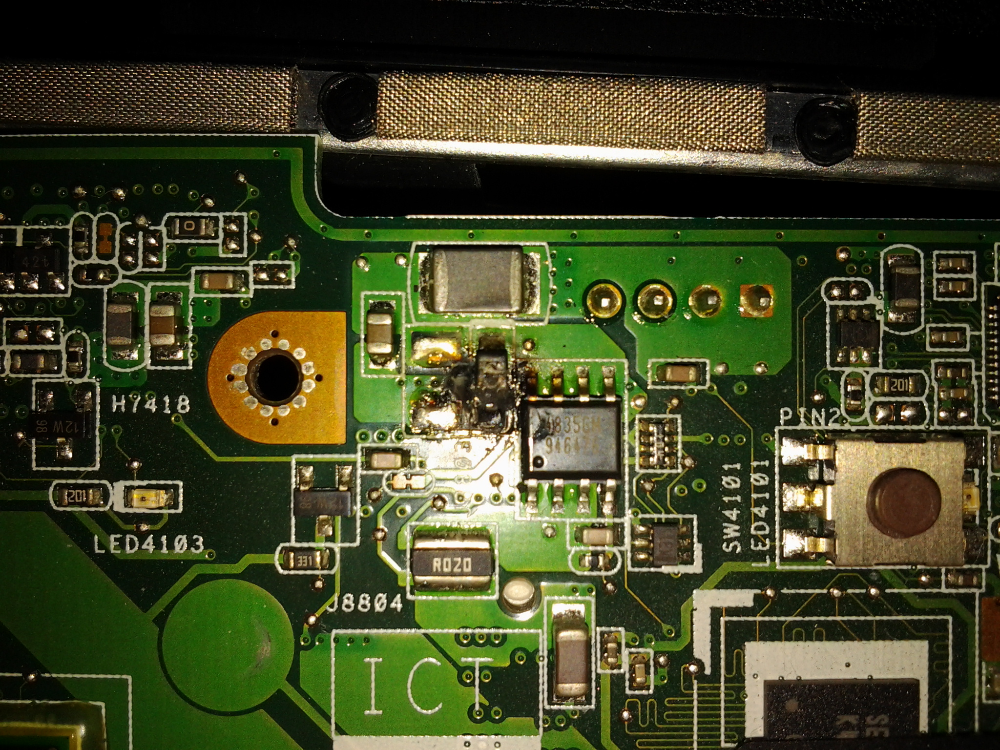

    I'm terribly horrible at reading these schematics..
    Heres a macro and enhanced view of both the front and back side of the burnt out area of the board... Maybe this will help with identifying the part.

      Originally posted by rockxstar89
      I have the same problem here. I was running a third party power supply (antec 65w universal adapter) and when the girlfriend plugged it in it sparked and left a burning smell.
      I took it apart to find the very same component burned out, and am pretty sure it's a TVS diode. Mine was actually charred enough the silicon blew right off and I could see its innards without the insulation.
      I was running the laptop off of battery, however it was slowly dying. Didnt get a chance to run a full diagnostics, however it seemed as though it would run off ac. It was running off battery with the power cable plugged in, but it was not charging the battery, and any time I removed the power cable it shut off.
      I have a friend who can do the repair work for me, but I need to know parts first.
      Should the diode be replaced??? obviously it served some purpose, had some type of current running through it if it burned out the way it did.

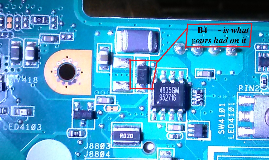

              Here is exact issue enjoy its a diode here is the link http://www.laptopish.com/89/asus-k50...d-replacement/ he does not replace the diode just replaces the motherboard but this should help you get on right track but i would check that power mosfet and make sure its not shorted seems to be common to short due to power spikes and seems to happen most with aftermarket power adapters, i had same exact issue with a Toshiba c655d few weeks ago and luckily all it took was the power mosfet , when i replaced the fet i used a higher rated one to handle the spikes from the aftermarket adapter better so far been solid and no issues....
              also the diode is marked b-4 good luck fellas

                also here is the more info on that diode "SS0540 Diode smd code "B4" and here is the link to the data sheet http://www.alldatasheet.net/datashee...TE/SS0540.html its a "SURFACE MOUNT SCHOTTKY BARRIER DIODE"
                but diffidently check that neighboring power fet to make sure it did not cause this diode to blow it will have source and drain and there cannot be any kind of short or it will keep blowing that diode....this should be a fairly easy fix fellas.....

                        to prevent it blowing the diode again if the mosfet checks out you should be able to install a 4 er 500 ma fuse or just keep it the way but if it works for awhile and blows that diode again there may be a need to do some modding er upgrades. Can you point out where exactly power comes in at having a hard time telling exactly where its at...i think i see the bottom side of the pins right above where it fried but not 100% percent sure...

                                  b4 ---> SS0540
                                  http://www.digikey.com/product-searc...=0&pageSize=25
