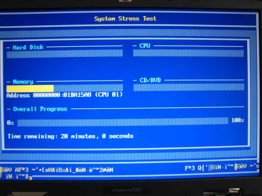

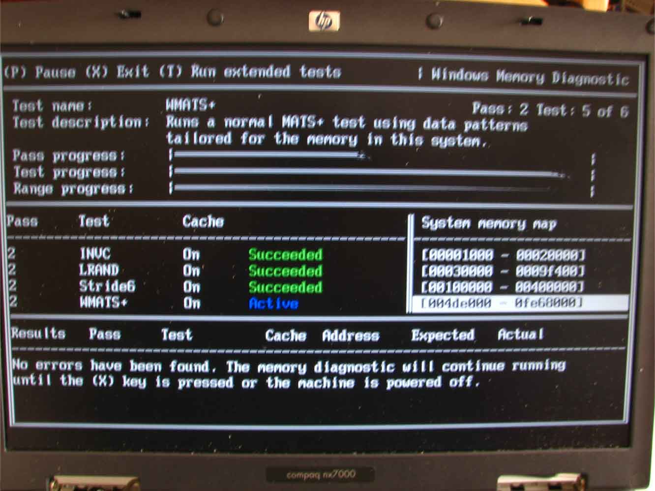

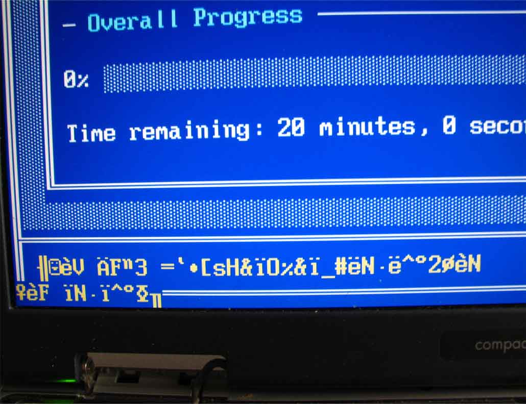

      1. if I start ram-memory test it stuck immediately (see on first picture) and sometime show distorted text on bottom (pic 2)
      But if I use Memetest or other program it show no problems with Memory (pic 3) I must find some bootable software for VRAM test, maybe is fail there, because this model has a big problem with Graphic card.

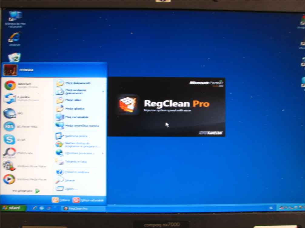

      it take a year to get in windows (xp) and then for anything take another year, I susspect some malware-virus etc. or bad Hard Disc, I will try to go back for month and will se what will happend, if is malware maybe it help.

          I start with fresh install winxp, and for now work like new But Im not shure what cause this error with system stress test, maybe is some problem with software or is hiren's boot CD damaged ?

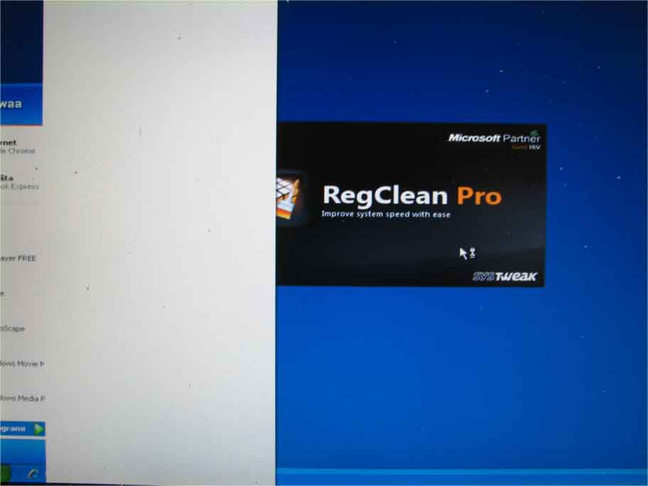

            Update. O god Im freak out with this laptop, after install fresh copy win xp, it work just fine, after I install kingsoft free antivirus and wifi card driver, first stuck and after restart allmost got in windows and got BSOD and restart, and this work in loop-cycle. I dont know, I test disc and is healthy 100%, ram is changed for 100% working, I change processor too.
            Must be something on Graphic card or Motherboard, because it will not start allways, sometime must push power button 10 times, sometime hold down and wait few seconds etc. So must be some fail to board or video card.

                  Hi. I reball all 4 VRAM chip's on video card and for now work, but still has some failure with starting, maybe is power button, it start sometime on first push, sometime must hold button down for 5-10 seconds, sometime start when release button after 5 seconds. I dont know maybe is someone else, but for ow it work. I will return this laptop with free of charge, or maybe I buy crap and use LCD panel for another laptop
