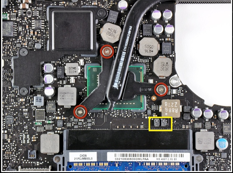

Hello, I'm needing some help identifying a component on a logic board for a macbook pro A1278 13.3.
Looks like a small tantalum capacitor.
Did one of these burn up on your MB?

yes, one of them is burned, the other is apparently well.
the meter reading is:
3.5 ohms on both sides
3 nf
I can replace it with a standard capacitor?
any ideas?

Could we possibly get a close up photo? I'm not sure whether if it is a diode or a capacitor.
He can indetify the good component with multimeter and he will know if it's a D or C.
Thats true!
I'm not familiar with the markings on it, so I might have to do some research.
