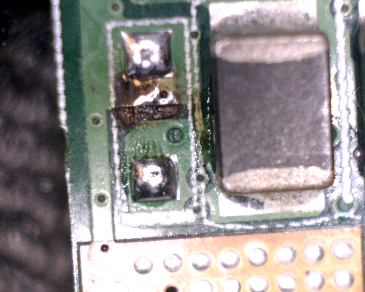

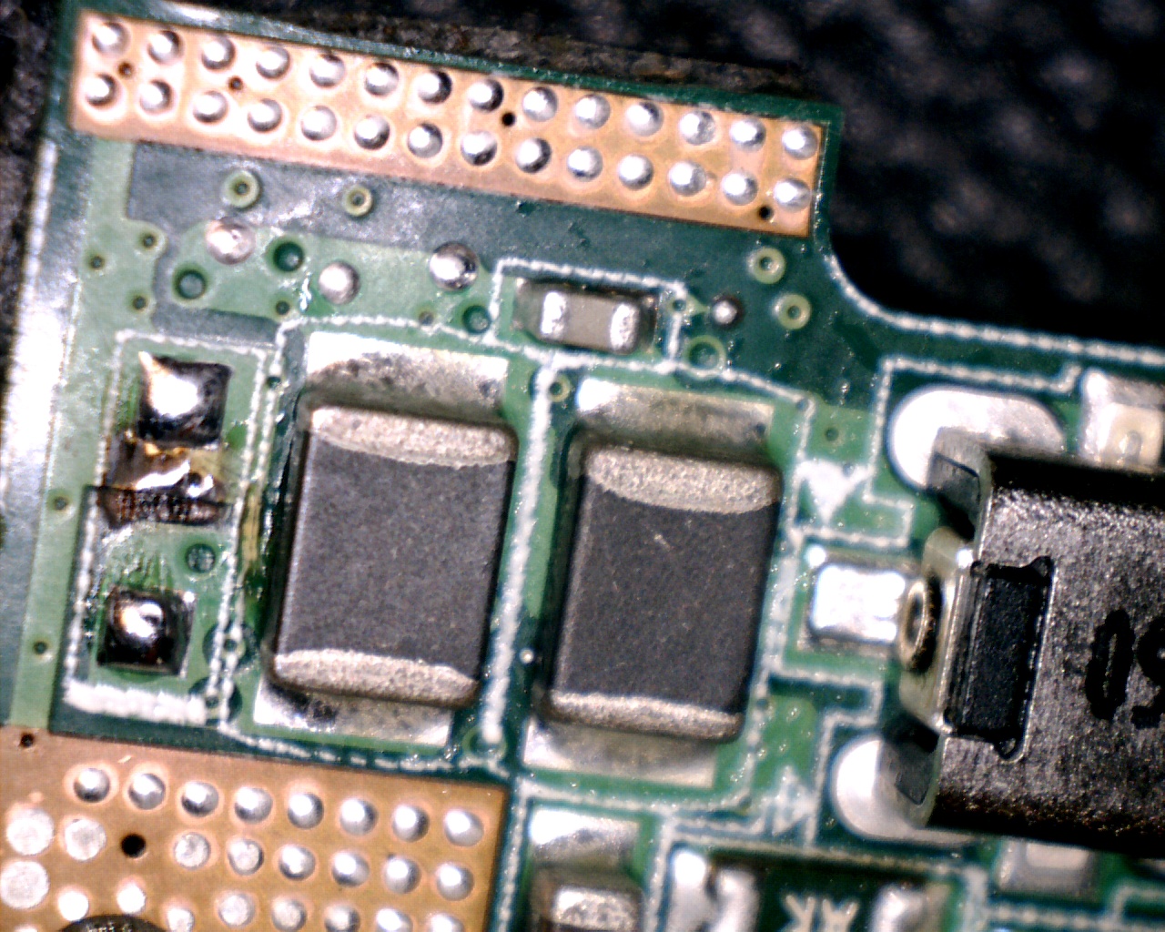

    So, I have this Asus Eee PC1005HA that's not powering on, not getting anything from the charger being plugged in all of that good stuff! I cracked the little guy open and pulled out the board and found a crusty little ____________ right near the DC input. I cleaned up where the ______________ once was and I have posted a picture below.
    Can you help me fill in the blank?
    Or does anyone have the schematics for this board?
    Thanks guys!!!!!

      I wonder if thats a fuse. not sure I can see the traces enough to tell if its parallel to those two smd caps.
        Re: Asus Eeeeeeeeeeeeeee 1005HA
        I was thinking it was a fuse, but how would I even go about trying to find out the specs on it? I just took it off, there was nothing but blown remains, This thing really popped! I wish I could find some schematics for this, unfortunately all I was able to find it for was the rev. 1.1. Well, I will continue my search in the morning. Thanks for your post though!

          one way you can tell, albeit may not be a good idea (see: last resort). Is to jump the connection with a blob of solder. If it works, its probably a fuse. If it catches fire/explodes or in any way destroys the power adapter or board components, suffice it to say its not
            True! I think I'm going to hold off on that for now... lol! I'm going to see what I can find on this and go from there. I think I'm going to email Asus as well to see if they would be willing to supply any information. Even if I can narrow it down to a fuse, I have no clue what fuse to put in it's place.

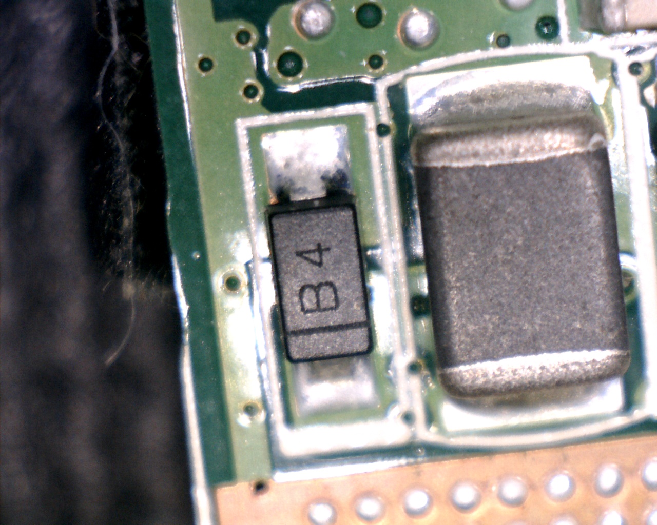

              So, as I'm sitting here looking around for additional information regarding this board, it hit me! I think I have a similar Asus Eee PC1005HA in my computer graveyard. So, I go take a look and to my surprise, I do have one! I crack the thing open and it's my lucky day! The motherboard is Rev. 1.3! Well, here is a shot of what is intended to be in the place where the blow out was!
                Seems to be a common fault with Eeeeee PCs:
                http://zaverio.com/~asbesto/lab/701/
                Looks like a small 1A SMD SOD323 diode. What is the input current rating of the laptop?
                  2.1a

                      OH MY GOD I FOUND IT!!!!!!!!!
                      That only took 2 hours!!! Now I have to see if I can purchase it somewhere... I'll be back with results in another 2 hours! lol!
                        Here it is:
                        http://www.mouser.com/Search/Refine....eyword=mbr0540
                        For anyone who may be looking for these parts, I just saved you hours of work looking for it!!!!
                          Here is the DC power schematic for the Asus Eee 1005HA. This is REV. 1.1 but the diode is the same for REV. 1.3.

                                  I have the same issue with a 1005ha....burned diode caused by reversed polarity charging...( that is the function of this diode ).
