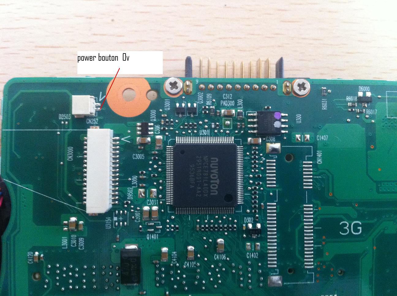

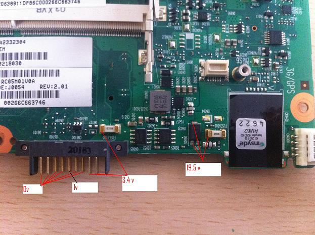

    i have dead toshiba l650-108
    -charger is ok
    -power jack is ok
    no power no led when put charger but when i mesure battery connector on motherboard i found v 3.4
    - 18.5 v its ok on motherboard
    plz help
    thanks in advance

    can you measure 3.3 or any other voltage on power on button ? and did you try clear CMOS ?

      5v rail is damaged probably. You'll probably need a variable power supply to "smoke" out the bad component(s).

          here attachement for toshiba
          cmos cleared
          explain me * 5v rail
