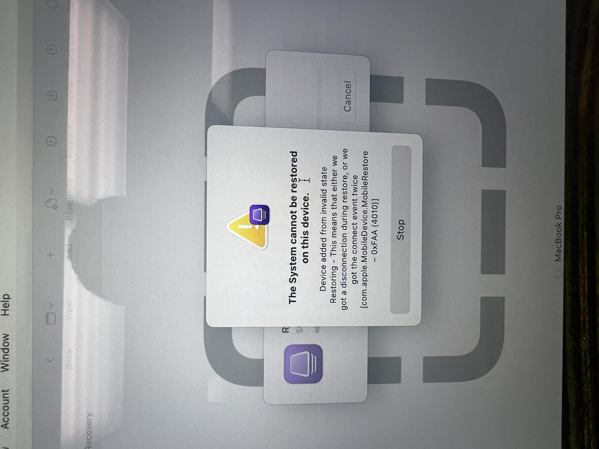

    A2442 MacBook Pro 14" M1 Pro issue
    Customer came in with computer consistently restarting and shutting down, they took it to Apple and they said DFU restore should fix this computer. Attempted the DFU restore but it refuses to restore. I was curious if his board was water damaged so I took it out and inspected the board, no water damage or liquid damage. Put board back in, battery holds a charge it seems and works fine without power. Tried DFU restore but no avail, it goes into DFU but it won't restore, it resets then it goes to RESTORE screen on computer. But it keeps restarting. I was wondering if his lid sensor is faulty because when I close the lid, it does not shut off and stays on, would the lid sensor cause issues with restoring the computer if its faulty? I am ruling faulty board or bad lid sensor. Would like some input.. so far nothing can be done to this computer at the moment.

    Re: A2442 MacBook Pro 14" M1 Pro issue
    This is the error message I get when trying to restore.
    Failed to restore device in recovery mode, libusbrestore error:21 [com.apple.MobileDevice.MobileRestore – 0x15 (21)]
    Researched this, and it seems it is going back into recovery once it starts loading the installer to restore. It goes in DFU then it goes into recovery once it tries to restore. Why is this?
        read that thread doesn't seem to address a way to resolve this issue.
        Going to try MrMacintosh method with IPSW being dropped into DFU. Crossing fingers and making a sacrificial lamb to the Apple Gods.
        UGHHHHHH....now the DFU keeps disconnecting and connecting. WTH Apple
          The operation couldn’t be completed. (AMRestoreErrorDomain error 9 - Failed to receive message from device, might be connection problem with USB host. (Communication error, possibly USB disconnection)) [AMRestoreErrorDomain – 0x9 (9)]
          Did MrMacintosh restore saw a progress bar for the first time (progress) but then the device cancels....
          this is the message at the top
              Ok I read post 26 but it is in a different language. So I’m assuming I need to run terminal on the computer with AC2?
                Did an update on our M1 13” to Sonoma and installed AC2. Almost completed the DFU restore then….this happens 😑

                  Have you solved this problem? My MacBook pro 14'' M1 Pro also has the same problem. The error code of my Mac is "SOCD report detected: (Ap watchdog expired)".
