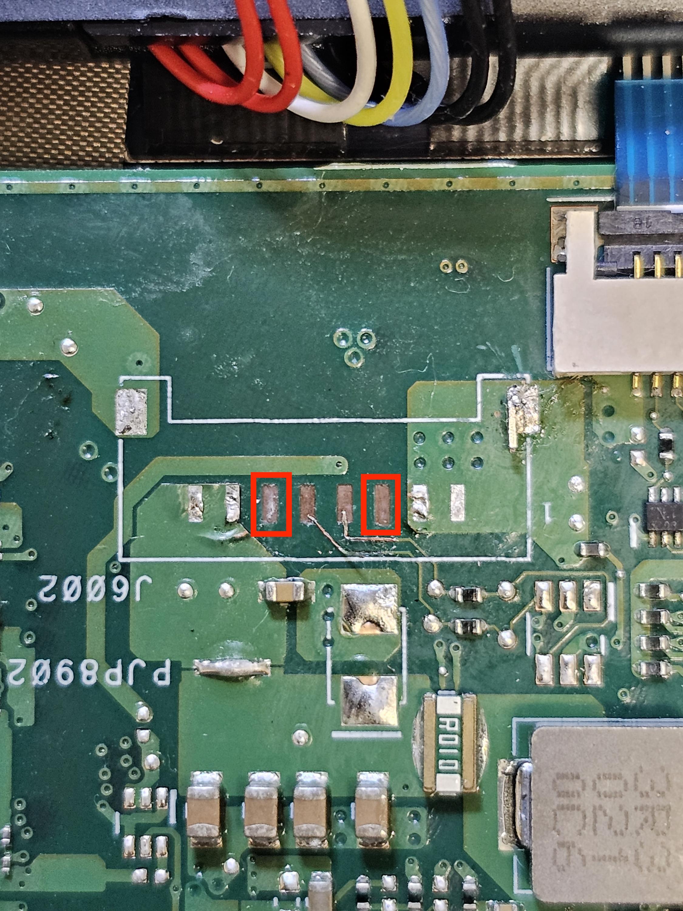

    Good morning,

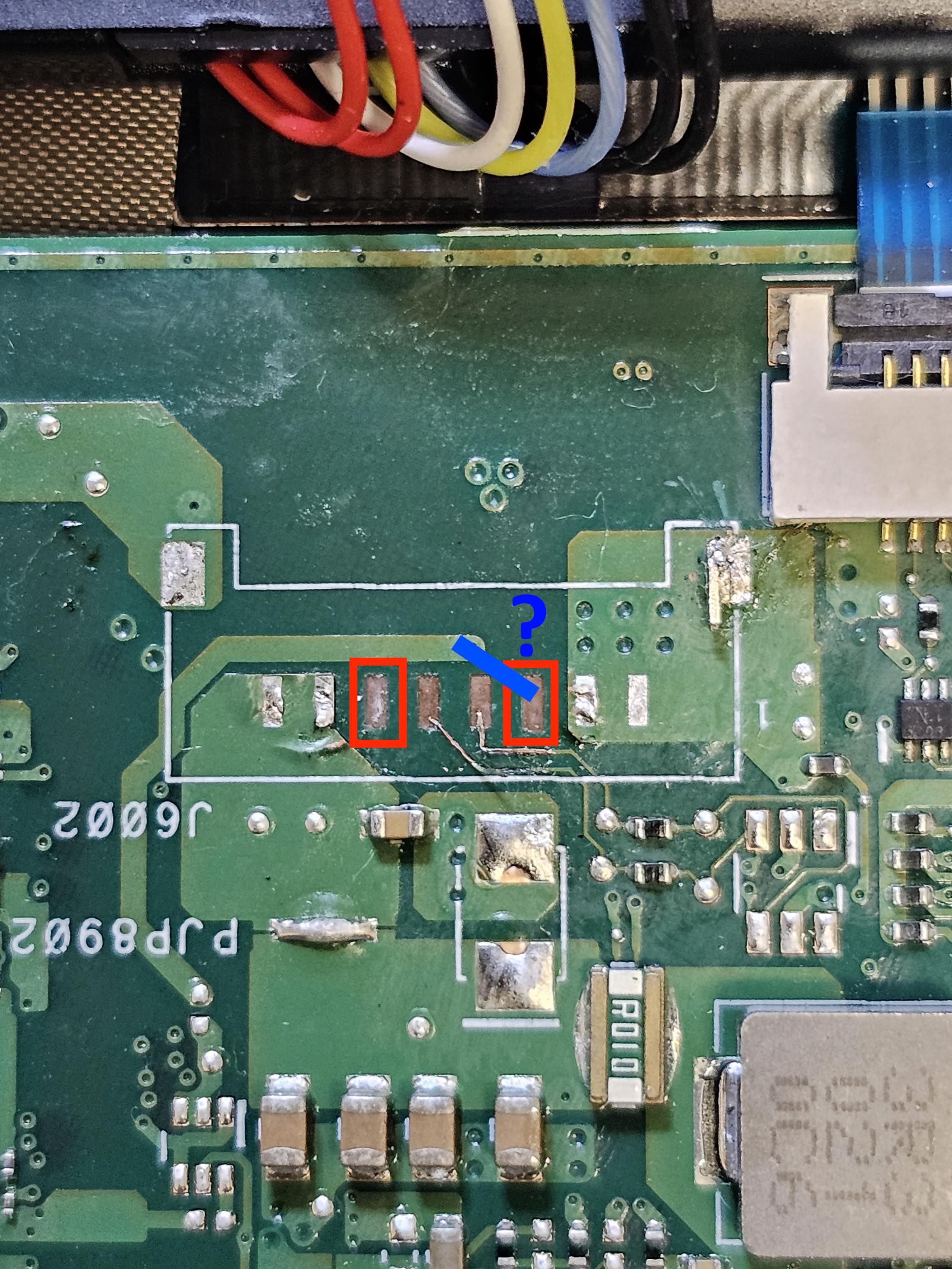

    I have a friend who dropped off his Asus just now. He tried to change the battery but tore off the connector.
    I can catch up on both tracks but I'm missing two pads that don't have visible tracks to bridge.
    Can you help me please ?
    Thanks in advance.
    The laptop is a S413DA , i don't find any boardview.

    These are probably simply not connected then. Any clue from the battery pins?

      Ah yes, I feel stupid for one out of the two... Indeed, the first from the left is not connected, on the other hand, the one on the right is on a blue wire on the battery side.
      I tried before desoldering everything to connect the battery without these pads and it does not work.
      I wonder if it's not connected to this track but I wouldn't want to do that randomly.
      Thank you for the answer

        From my experience, without "via" not connection. And I don't see either a via nor a broken track related to these two pads. Does the boards has other issues beside battery not working right now?

          Re: [REQUEST] Asus battery connector : Pads issue
          The card works well on the mains, the PC shows no other signs but perhaps the problem comes from the load management chipset?
          He changed the battery with an original manufacturer because the previous one no longer worked.
          Why have a blue wire on the battery and not a blank like on the other side if there is no connection?
          Do you know what this thread represents by any chance? It's just for my personal culture
          Thanks again.

            Re: [REQUEST] Asus S413DA battery connector : Pads issue
            All is allright now. You're right, the pads wasn't importants.
            Thank you.
