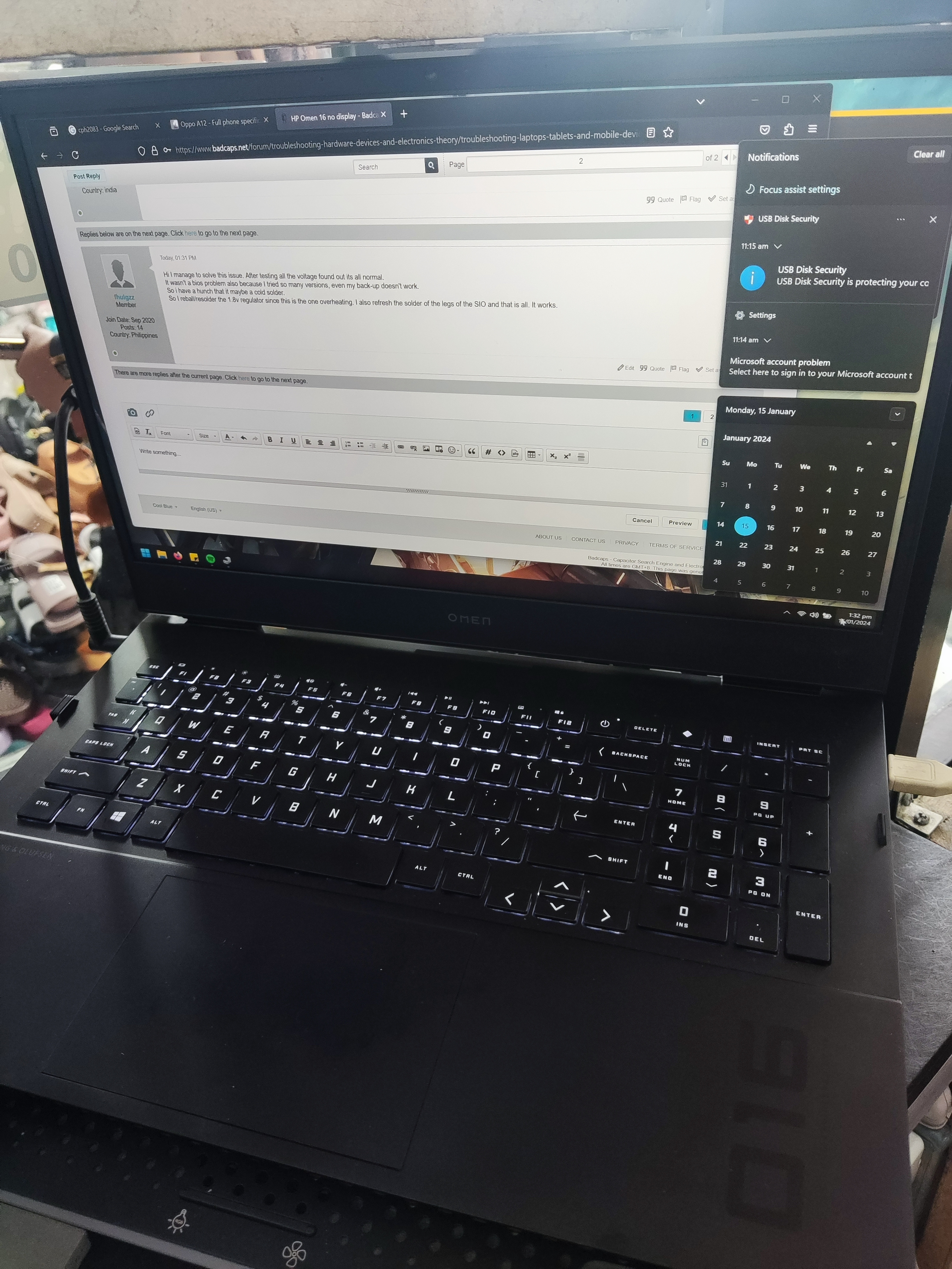

                Hi I manage to solve this issue. After testing all the voltage found out its all normal.
                It wasn't a bios problem also because I tried so many versions, even my back-up doesn't work.
                So i have a hunch that it maybe a cold solder.
                So I reball/resolder the 1.8v regulator since this is the one overheating. I also refresh the solder of the legs of the SIO and that is all. It works.

                  Sir Is this the ic you reball near in the wifi card? Thank you
