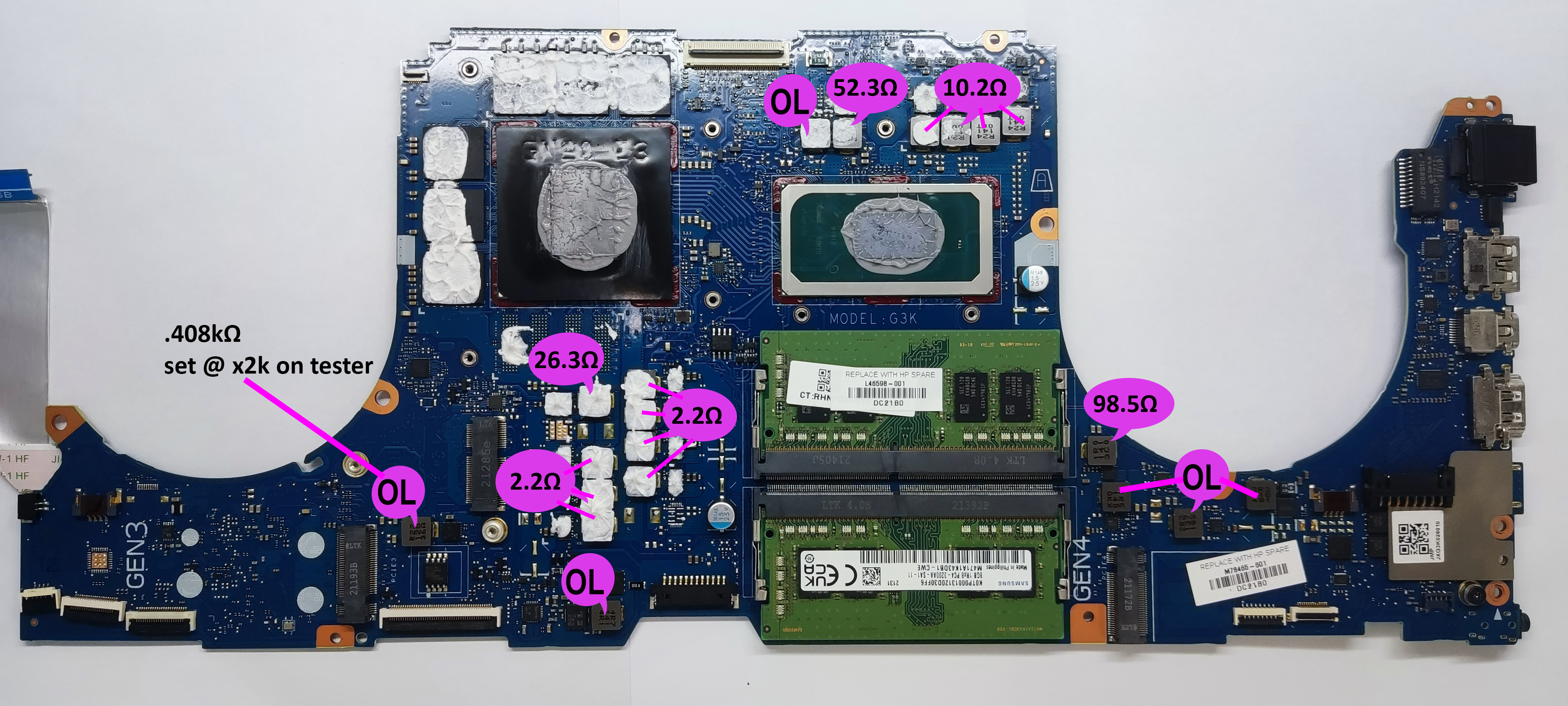

            Hi, here is the resistances to ground on all coils.

                    Regarding the OHM measurements you've taken, please take them once more. Set your multimeter to the 200 range. Any reading above 200 ohms should display as OL. For anything below that, share the readings rounded to two decimal places. For instance, the GPU might show as 0.23. Also, measure the resistance of your cable by connecting to two ground points on the board and share that reading too.
                      Hi here is the measurement at 200 ohms range on multimeter.
                      Ground to ground resistance is 2.2 ohms.

                            This looks all fine to me. Since even the RAM supply is up and running it's the time to take a look to the coils above the CPU and GPU. We need to know the present voltages there.
