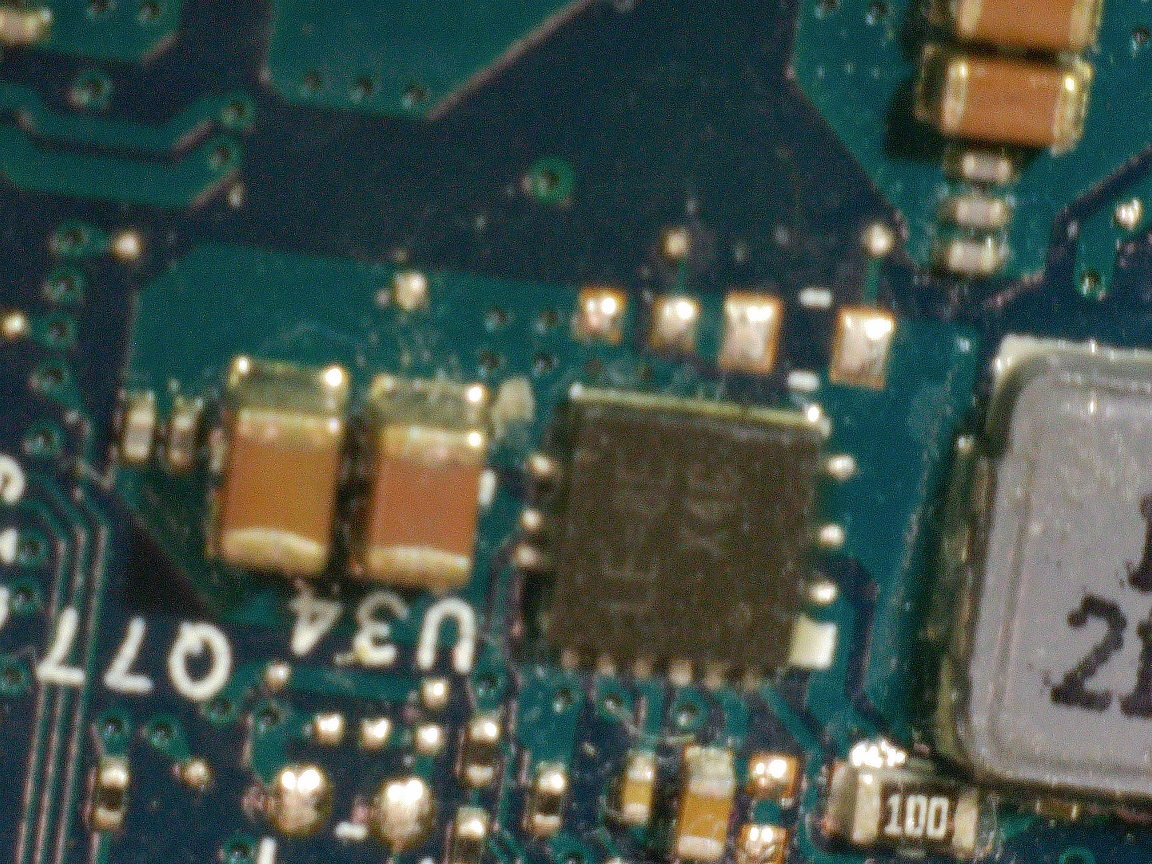

    IC chip id marked LE=8E
    hello,
    can anyone please ID this chip. It's from a dell 3100 ChromeB. LA-K991P GDA10 Rev 1.0. Not much info on these boards.
    Thank you all..

    Originally posted by pdblues2231
    hello,
    Thank you all..
    LE= RT6258B (Richtek)
    https://www.richtek.com/assets/produ...S6258BC-03.pdf

      Hey,
      Thank you so much. awesome stuff.
