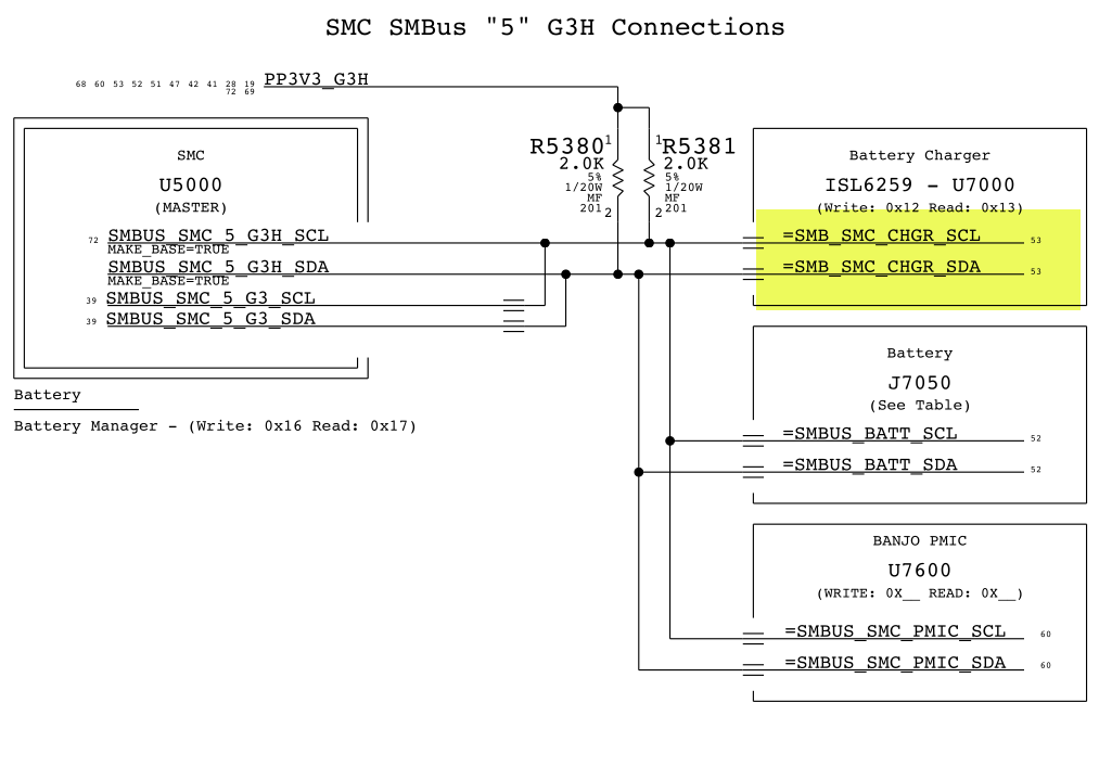

                                Measure the voltage to ground of:
                                SMB_SMC_CHGR_SDA
                                SMB_SMC_CHGR_SCL
                                Post each measurement.
                                • obelix24
                                  • Jun 2023
                                  • 291
                                  • Slovakia
                                  #36
                                  Re: Macbook A1708 - 820-00840 20v 50ma
                                  I'm not able to find this in board view for this board.
                                  SMB_SMC_CHGR_SDA or SMB_SMC_CHGR_SCL
                                  I'm only able to find
                                  SMB_PMIC_SCL
                                  SMB_PMIC_SDA
                                  • mon2
                                    • Dec 2019
                                    • 14666
                                    #37
                                    See attached.

                                      #38
                                      I've tested R5381 and R5380
                                      pads : SMBUS_SMC_5_G3H_SCL and SMBUS_SMC_5_G3H_SDA
                                      There is no test point or any component for SMB_SMC_CHGR_SDA or SMB_SMC_CHGR_SCL
                                      both when charger connected show voltage 3.420V but it's not stable it drops to 3.3V and then back to 3.42V
                                      see attached board view file

                                        #39
                                        The 3v42 rail needs to be stable. Remove all power. Meter in resistance mode.
                                        Measure the resistance to ground of the 3v42 power rail. Test anywhere you can.
                                        What is the resistance?
                                        • obelix24
                                          • Jun 2023
                                          • 291
                                          • Slovakia
                                          #40
                                          resistance to ground on R5381 and R5380
                                          Is in Mega ohms (2Mohms and falling down)
