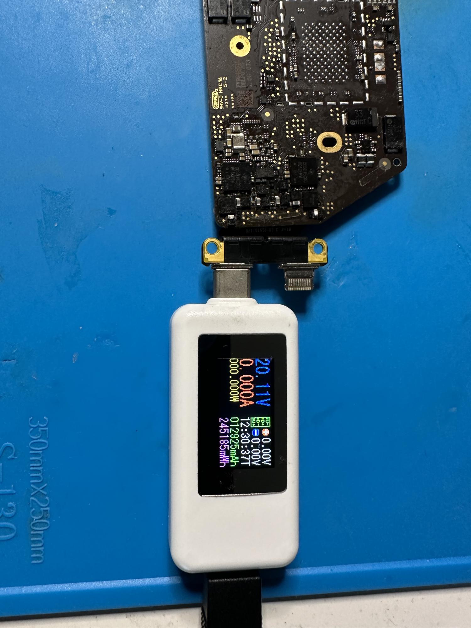

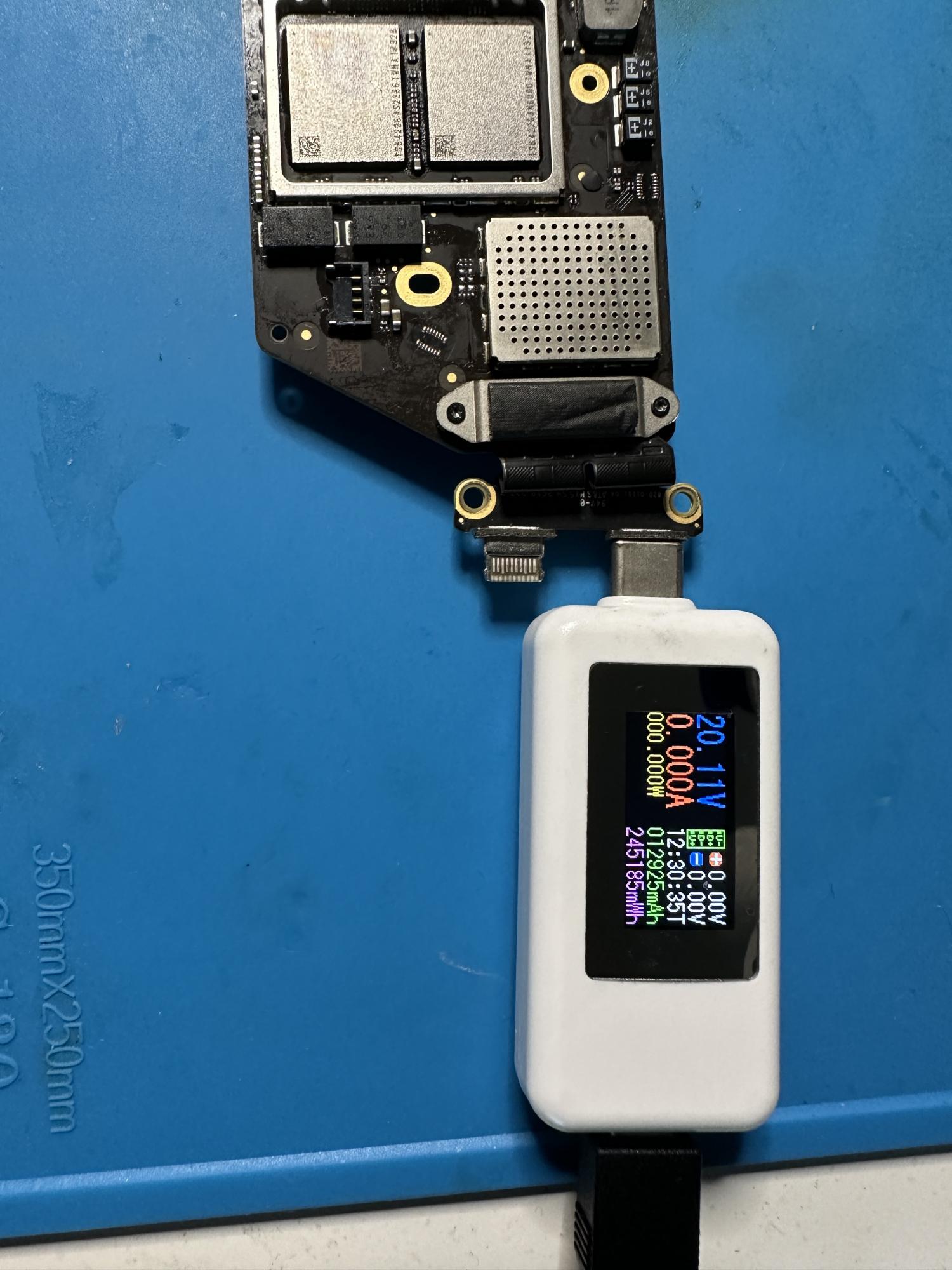

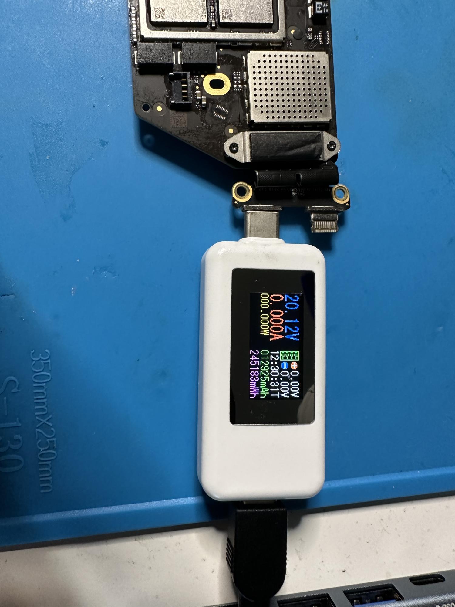

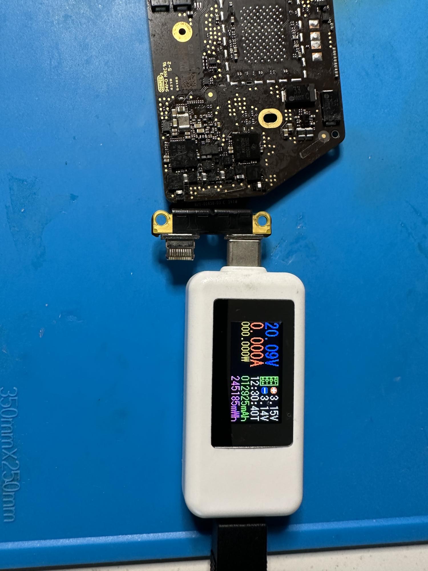

                      Something does not look right if you are reading 0A current draw yet you have PPBUS_G3H voltage rail.
                      How is the current draw being measured? Is it a USB Type-C meter? Be sure that the meter is bidirectional in design. We know that we picked up at least 1 meter from Aliexpress that is unidirectional so it reports 0A current draw due to the way it is connected to the power source and the load.
                      Post a pic of the USB-C meter. Also review if there are arrows on the opposide side of this tool. If the meter is used in reverse, the meter will not properly report the current draw.
                      • obelix24
                        • Jun 2023
                        • 291
                        • Slovakia
                        Re: MacBook Air A1932 820-01521 no boot 5v only
                        I'm measuring on USB-C meter (KEWEISI)
                        see photos both ports from both sides
