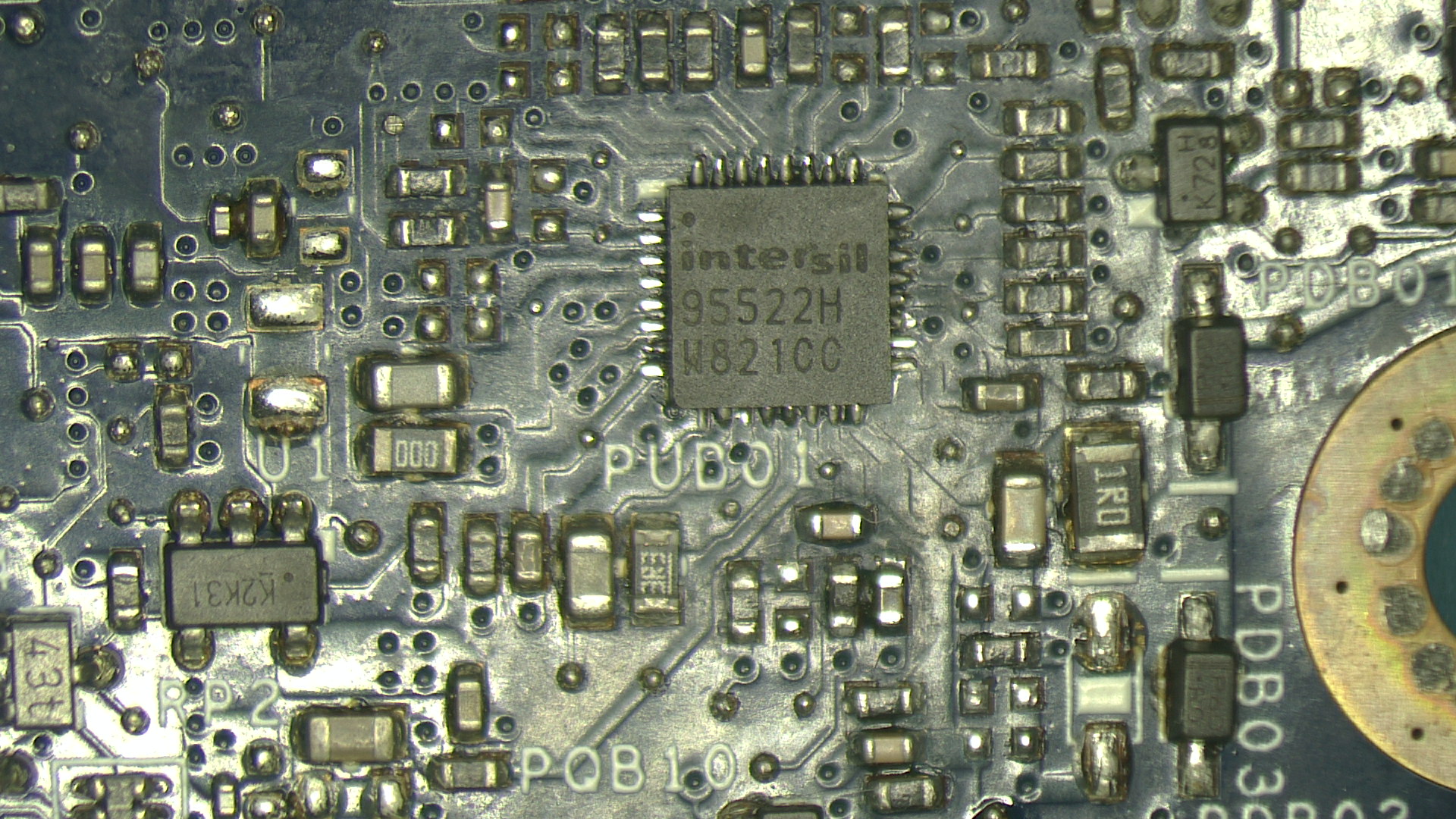

                                So what do you think, how possible is it that SMDs were mixed or got lost through the soldering process of PUB01, like PRB07 with wrong value and PRB05 missing for example?
                                Any pictures of your work available?
                                FairRepair on YouTube
                                • CIT
                                  • Apr 2020
                                  • 12
                                  • South Africa
                                  Re: Charging Issue on Dell G3 3579 (LA-F611P)
                                  I don't think any SMDs were mixed, my soldering skills is fairly good. I also found it strange that PRB07 tested wrong and that PRB05 was missing. I am not so good with understanding schematics yet tho, so at this point I am assuming its some configuration thing with the board model?
                                  Here is a photo of ISL95522 (PUB01)

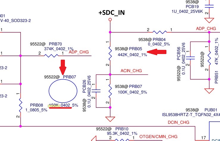

                                    In my limited knowledge, PRB07 and PRB05 -both should be there as 95222 controller is used. You have measured PRB07 at 149 Ohms at post#11 which now stands changed at 149K Ohms.
                                    • CIT
                                      • Apr 2020
                                      • 12
                                      • South Africa
                                      My apologies, that is a typo. PRB07 tested 149k ohm on and off the board.
                                      I had a look at the schematic again now and I can see according to the schematic PRB07 should be 150k ohm on the ISL95522. The schematic also only shows PRB05 on ISL9538 and there is no indication that PRB05 is populated on ISL95522.
                                      Here is a snip of schematic, I marked my findings in red:
                                      • mcplslg123
                                        • Jun 2015
                                        • 7262
                                        • india
                                        Yes,only PRB07 is populated for 95522 series.
