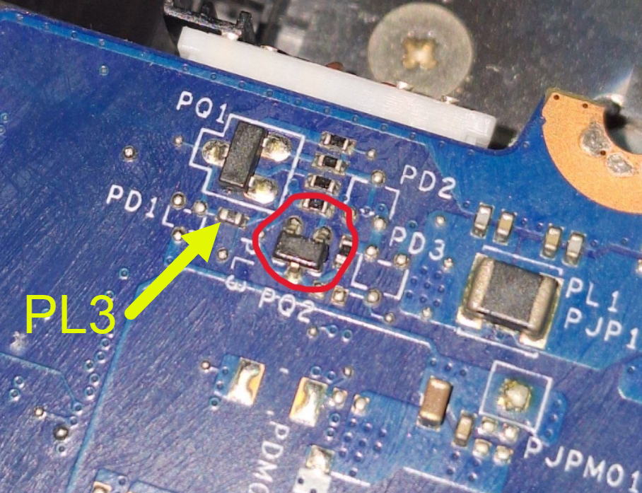

      Bear with me pls as I said I am very new to this. Took me 15min to find PL3
      Hope this is PL3 I am measuring.
      Top Top left - 0
      Top right - 0.26
      Bottom - 2.2

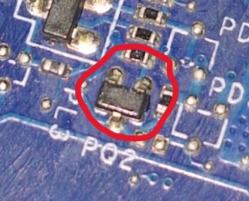

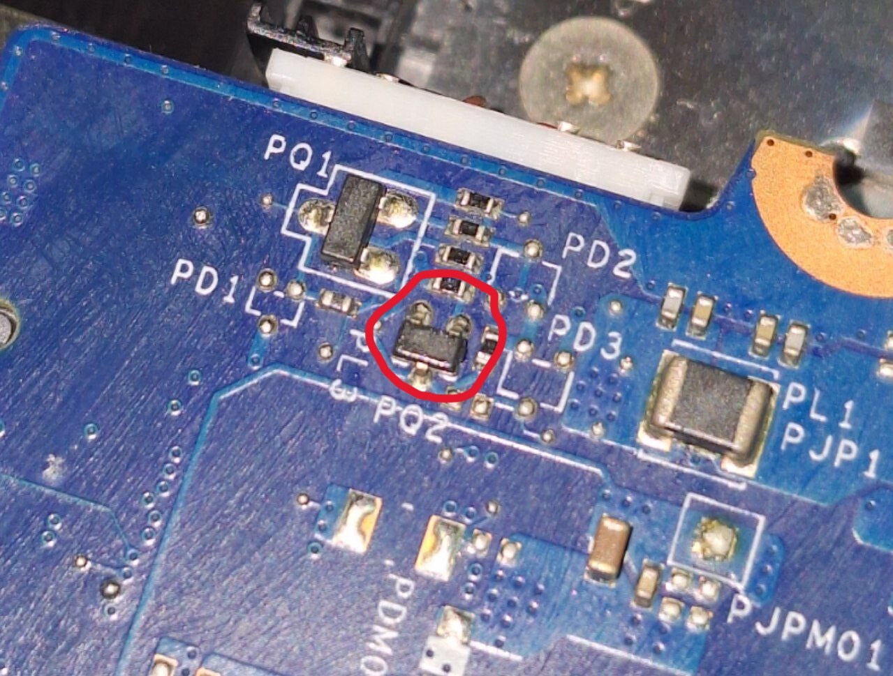

        See attached. The part that was measured is the transistor PQ2 (3 leaded part).
        We are interested in the 2 leaded part to the left which is PL3.
        Also interested in the measurements of the voltage to ground of the transistor that is at the top left of the ic @ PQ1.
        Post each measurement.

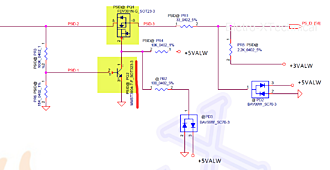

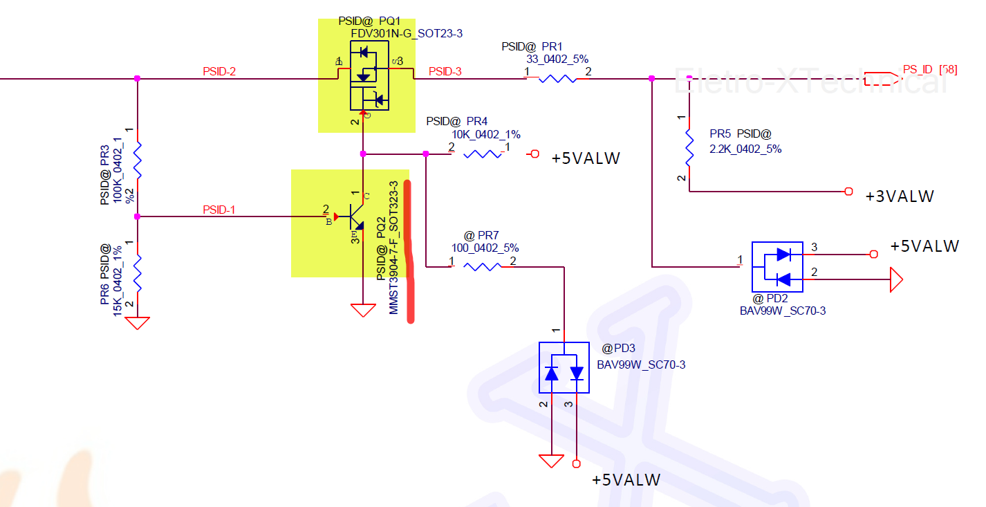

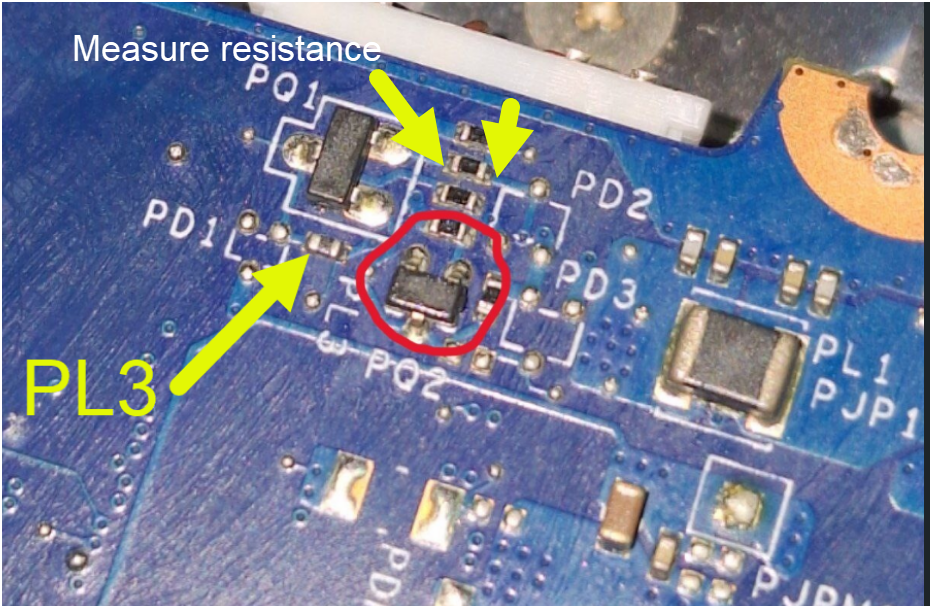

                According to the schematics, it should tone beep at pin # 4 of the power adapter. Confirm this detail. The part @ PL3 is a ferrite bead (not resistor) - this part acts like a resistor at high frequencies to offer resistance to block out electromagnetic noise = 'EMI filter' function. At low frequencies, the part has a lower resistance to permit the passing through of the signals.

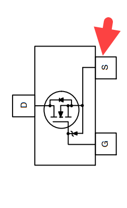

                Locate the mosfet (is like a transistor) @ PQ1 = 3 leads.
                We are interested in the 'S' pin (noted with the arrow of the attached diagram) = SOURCE pin. Remove all power. Meter in diode mode. One meter probe on the SOURCE pin. Other meter probe on the nearby black tiny 2 leaded parts = resistors. We are hunting for the 33 ohm resistor that should tone beep once it is found.
                Once you believe you have found the 33R = 33 ohm resistor, switch the meter to resistance mode. Then still with no power, one meter on one side of the 33R resistor (or can even be on the source pin of the PQ1 mosfet) and other meter lead on the other side of the 33R resistor.
                What is the resistance of this 33R resistor in ohms?

                Post your measurements.
                Click image for larger version  Name:	PQ1.png Views:	0 Size:	10.0 KB ID:	3295782

                  Holy moly....
                  So right after posting, I inspected the charger. The middle pin was completely bent to one side. Hence it not going all the way in, hence the issues I have been facing for WEEKS now.
                  I have verified the charging now, BIOS picks the charger up, CPU is running at full speed, and the bttery is actually going up in %.
