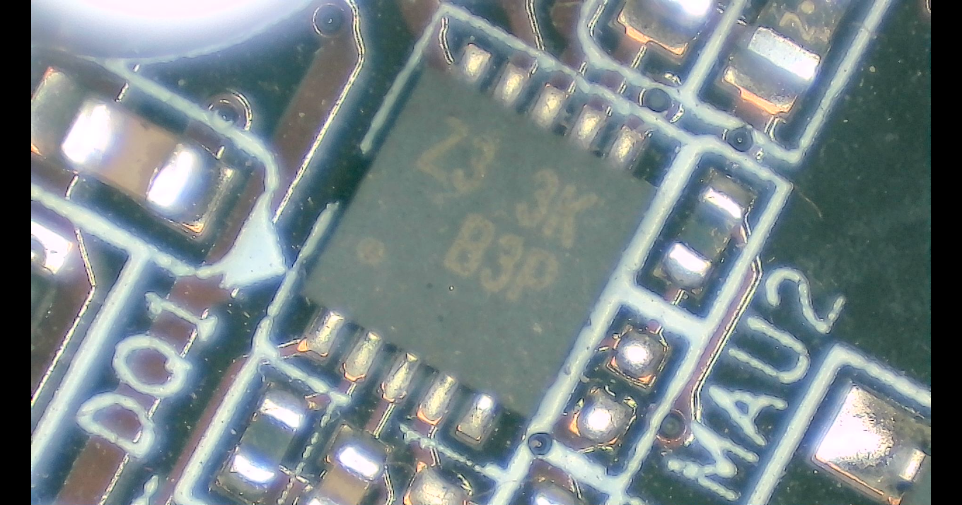

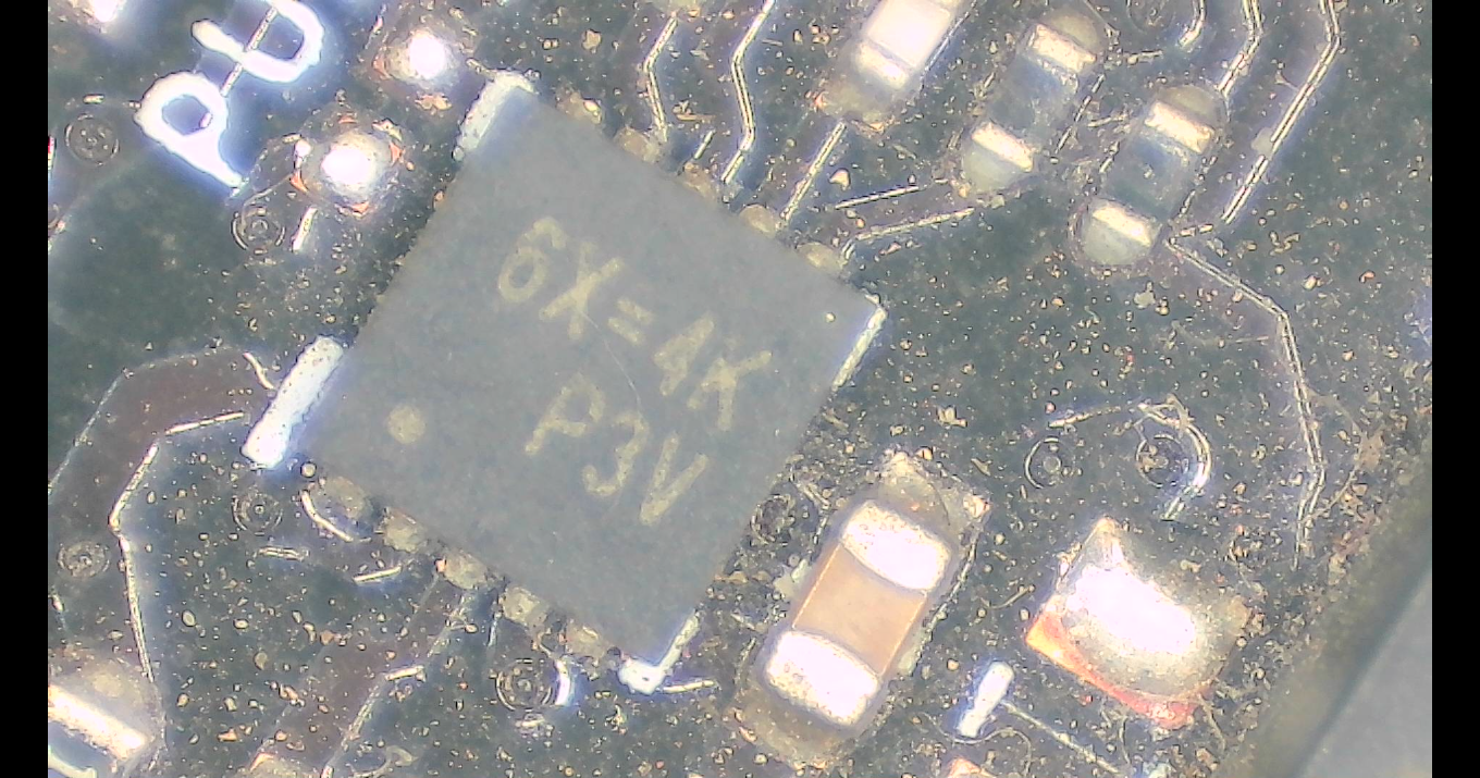

Hello! good day can you help me to identify this pair of IC'S ?
IC 6X=4X
IC Z3 3K

If there is an '=' in the part number, then it is by Richtek.
Searching 'Richtek 6x=' on Google resulted in the attached. The values after the '=' are the date codes.
Z3 is also from Richtek.

thank you, can you correct me? the Z3 3K is RT8237C

Yes. Note that 3K = manufacturer date code. The 3K does not need to match.
