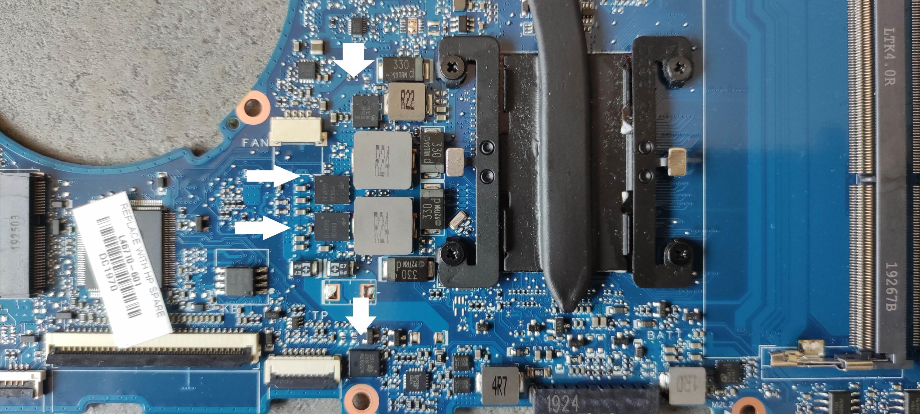

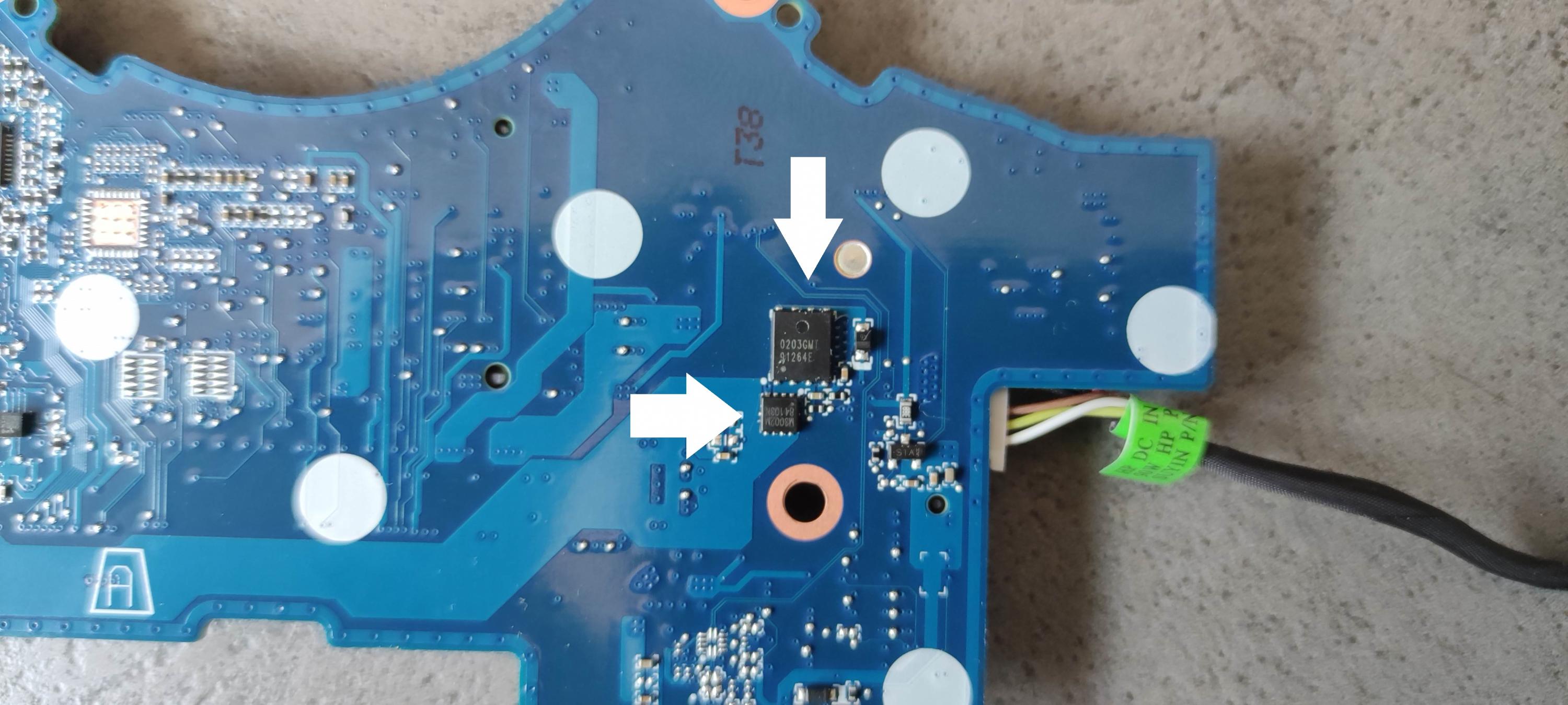

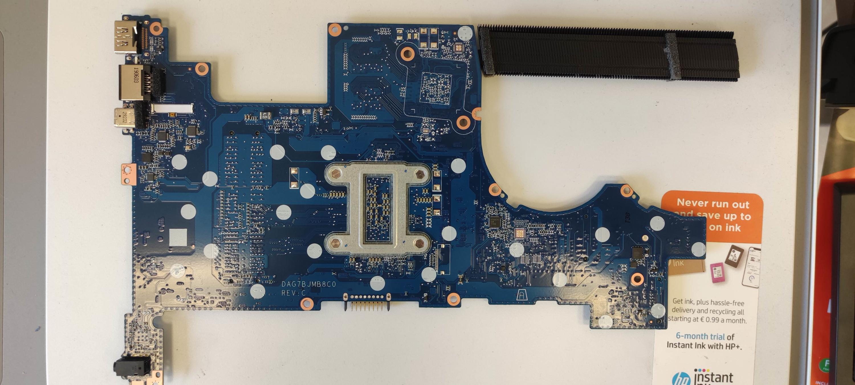

    Hi, I have this laptop that is not powering on. It died suddenly. If I connect the charger or the power supply (19v), no charging led light is turning on.
    I only checked with a multimeter that 19v is on the connector of the charging cable on the board (marked with an arrow on the "front" image).
    Any hint? Cannot find any schemathics or board layout. Board code is DAG7BJMB8C0 REV C MODEL G7BJ
    Regards,
    Vito

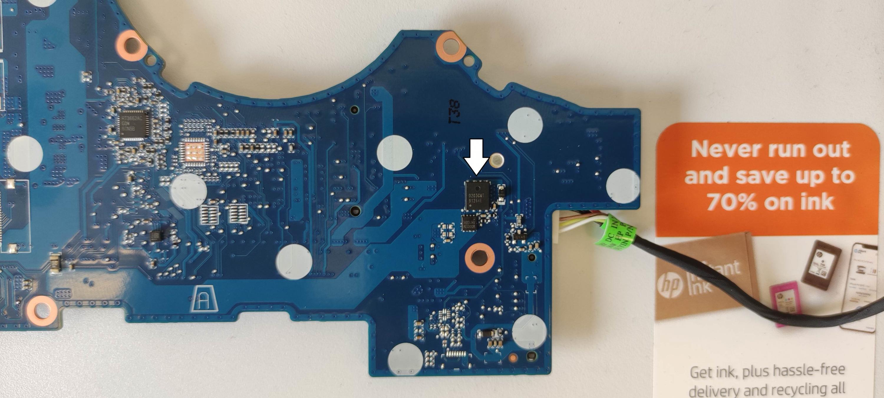

      the adapter voltage is present, around 20 volts, "power adapter connector" image
      I marked all the mosfets I found in front and rear of the board, I will check voltage on all of them and report here.

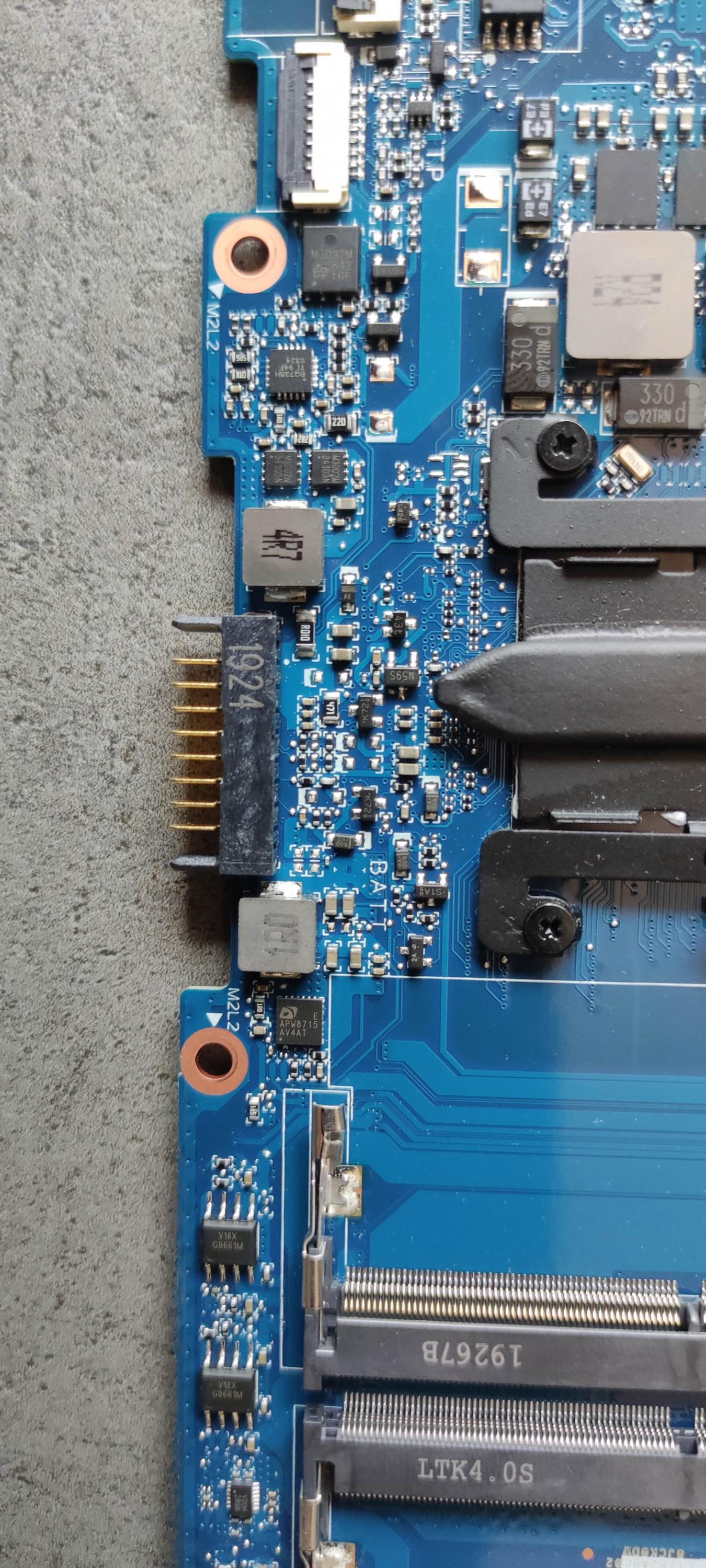

      I attached an image of battery connector, can you help me locating the charger IC?

        Re: HP Pavillion 15-cw1077nl no power
        I could only locate 2 classic mosfets, one on the front side and one on the rear side.
        front side:
        source(1-2-3) 0.4v
        gate (4) 0.3v
        drain 0v
        rear side
        source 0v
        gate 0.2v
        drain 22v

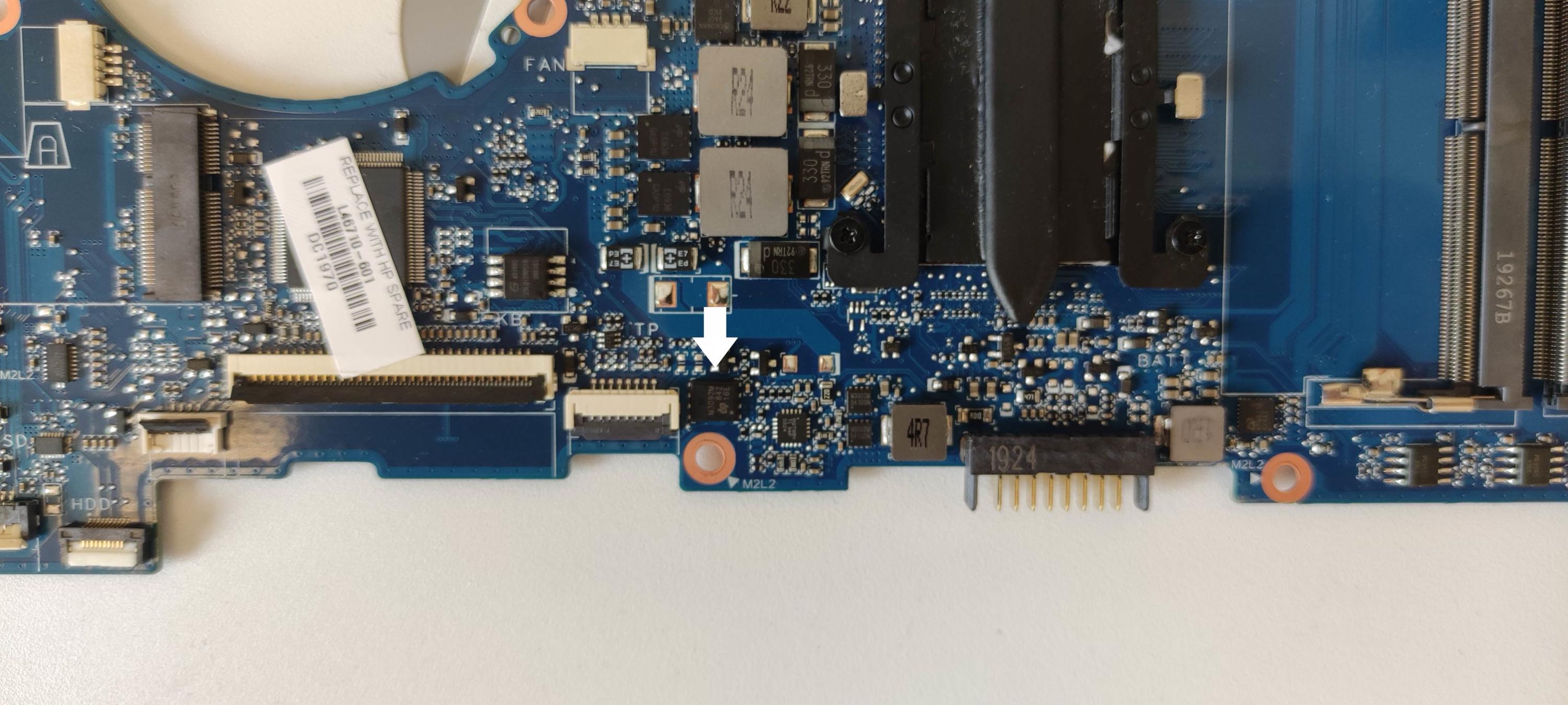

          The charger IC is the square on marked BQ738H.
          The part is a custom marked version with little public information. However we can get what we need from here and comparing to other similar parts from Texas Instruments.
          https://www.datasheetcafe.com/bq2473...ge-controller/
          With care, meter in dc volts mode, measure the voltage to ground of the VCC pin on the charger IC.
