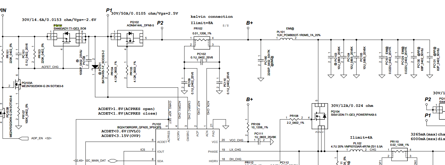

    Hi everyone
    I have hp 470 g2 not turn on zpl40/50/70
    when i put charcher dc jack flashing orange light for 2 second and off
    i check voltage i have 19.5 v and ADP_SIGNAL is 3,3v
    i check first mosfet for shorts is ok
    In bios i have 3.4v in pin 6 and 7
    Can i help me ?

    Measure the voltage to ground of each pin of the 2*DCin mosfets.
    Interested in the
    Source (1-2-3)
    Gate (4)
    Drain (5-6-7-8)
    Pin voltage measurements. Repeat for the 2nd DCin mosfet. Post all measurements.

      Pq101
      source=19,5v
      gate=6.1v
      drain=19.5v
      pq102
      source=19.5
      gate=25v
      drain=19.5v

        Post pics or topside markings of these measured mosfets.
        Wish to confirm if one is a P-channel and the other is a N-channel type.

          do you need schematic ?
          • Vesko356
            VIP Moderator
            • Aug 2018
            • 4386
            • Bulgaria 🇧🇬
            Re: Hp 470 G2 not turn on
            Originally posted by arber1232
            Schematic ---> https://www.badcaps.net/forum/showth...633#post678633
