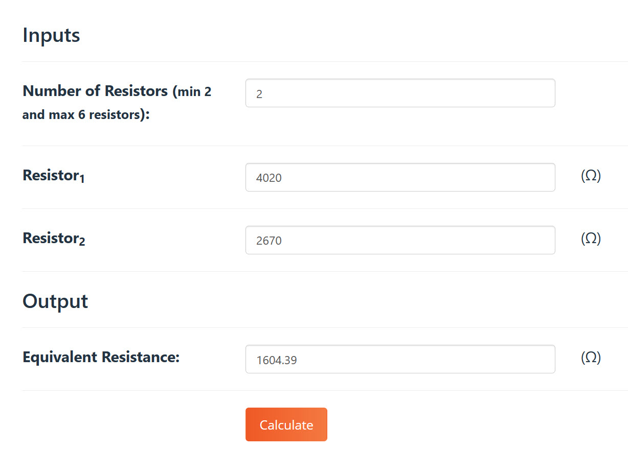

        Re: A1708 820-00840-01 20V 0.94A no Power
        resistance between pins: 7 and 8 on U7650 1.604
        • mon2
          • Dec 2019
          • 13967
          It is the correct value.
