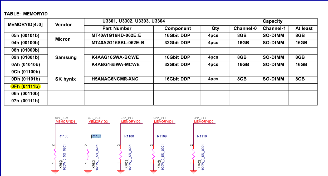

    please help me to remove ram onboar with bios or id on schematic (with schematic and bios)

                  Did anyone figure it out how to disable this?? i have a board with 32gb samsuing...and haven't got a clue how to disable it...

                    Come on guys, there is a parto of the schematic in the first post, help us less fortunate to earn some bucks!Is it even a ram issue?

                      Never attempted this before but it appears that you only need to strap as per the posted chart in post #1.
                      1) Take a pic of each resistor before starting so you can reverse the process, if necessary.
                      2) Remove resistors R1106, R1107.
                      3) Stuff resistors R1108, R1109, R1110. You can solder blob these pads to achieve the same 0 ohm resistor.
                      The above strappings should build up the binary code = 00111b = 07h in the above strap chart.
                      Attempt it and post your updates.

                        Hi mon2, tnx for sharing ,will give it a try, but i have samsung version 16gb k4abg165wa mcwe...i will post a full page from the schematics,so maybe you can help with my version? Click image for larger version
                          In order to build 00111b, R1106/R1107 should be staffed and remove R1108-R1110 ?
                          I try both 00111b and 11000b, but nothing works.

                            Hello... I want to disable the onboard RAM on Lenovo ThinkPad T14 Gen 1 laptop motherboard, NM-C931, but I've never been able to do it.
                            The motherboard has an Intel processor and Samsung 8GB of integrated RAM.
                            Schematic and BV: https://www.badcaps.net/forum/showth...72#post1215772
