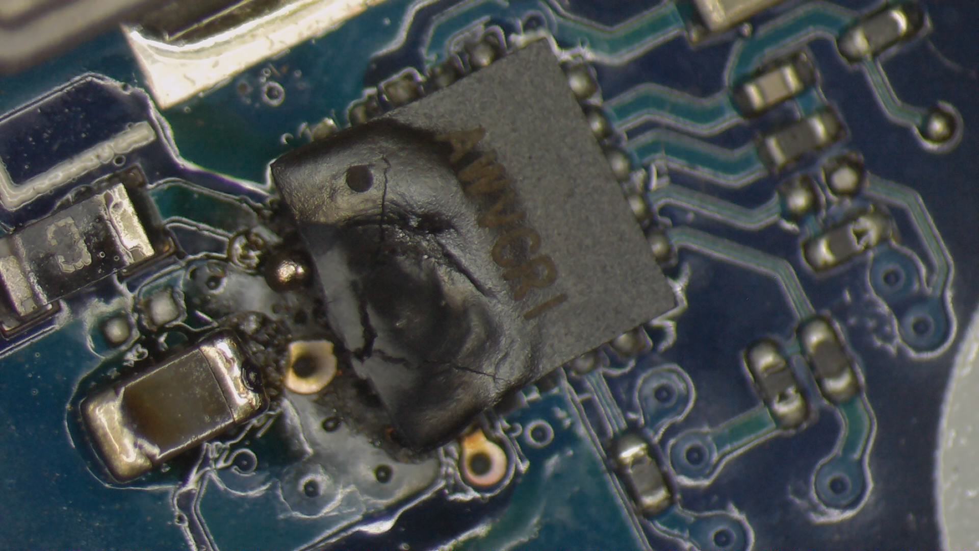

identify this IC marked "AWVCRI"
  • Wachenaggo
    • Jul 2018
    • 66
    • Philippines
    i got a board number a acer "NB8609_PCB_MB_V5" i can't find a Boardview or Schematic for that board but im sure that IC marked "AWVCRI" is causing not to boot shorted to gnd
    available sch and brd is board version 4 it is different.
    this the pic of the burned part.
  • Stevedb
    Stevedb
    • Feb 2018
    • 624
    • Belgium
    Re: identify this IC marked "AWVCRI"
    It is probably this chip SY8286BRAC. It is probably bad news and the chip killed the 3v alw and probably shorted pch.
