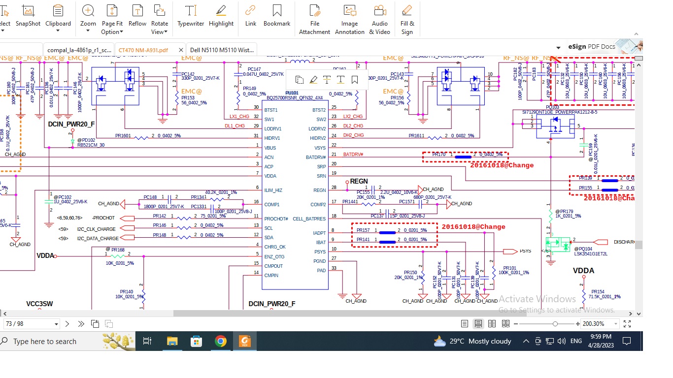

    The client brought me a laptop Lenovo T470 and it's not charging, the client said the battery is good and this suddenly happened to him, and reading from Ic charging it's like this:
    (BQ25700RSNR_QFN32_4X4) ic name.
    1: VCN= 20V
    2: VCP= 20V
    3: VBUS= 20V
    7: VDDA= 6V
    4: CHGR_OK= 3.3V
    21: BATDRV#= 3.3V
    22: VSYS= 9.2V
    3 pins in the battery connector have 3.3v, and when I connect the battery one goes 2.3v and the other two pins stay in 3.3v.
    what else do I have to check? ask me anything and I will replay as soon as possible.
    there is a pic of battery charger.
    Thank you.

    Re: Lenovo T470 not charging
    Connect the battery.
    Measure the voltage to ground of:
    SRN
    SRP
      with battery:
      SRN= 9.2V
      SRP= 9.2V
      without battery:
      SRN = 9.2V
      SRP= 9.2v
      Thank you for respond
              Link the full schematic when you can. Braincells are being wasted today on retooling our dreaded smt line for a new part.
                this is the schematic,
                      Confirm the voltage to ground of each pin on connector PJ2. Connect your battery while checking.
                      Confirm the voltage to ground on each side of fuse PF3.
                        Pj2 & pj3
                        without battery,
                        1pin= 0.21v
                        2pin= 0.21v
                        3pin= 3.3v
                        4pin = 3.3v
                        5pin= 3.3v
                        6pin= 0.0
                        7pin= 0.0
                        fuse= 0.21v
                        with battery:
                        1pin= 0.0v
                        2pin=0.0v
                        3pin= 3.3v
                        4pin= 3.3v
                        5pin= 2.06v
                        6pin= 0.0
                        7pin= 0.0
                        fuse= 0.0
                        • mon2
                          • Dec 2019
                          • 14679
                          Remove all power. Remove the battery.
                          Meter in resistance mode.
                          Check the resistance of the same fuse using the meter probes across the fuse.
                              FUSES with probes on both sides:
                              fp3= 000
                              fp4= 000
                              FUSES with black probe on ground and red on one side of the fuse:
                              fp3= 1.9 mega ohm
                              fp4= 1.9 mega ohm

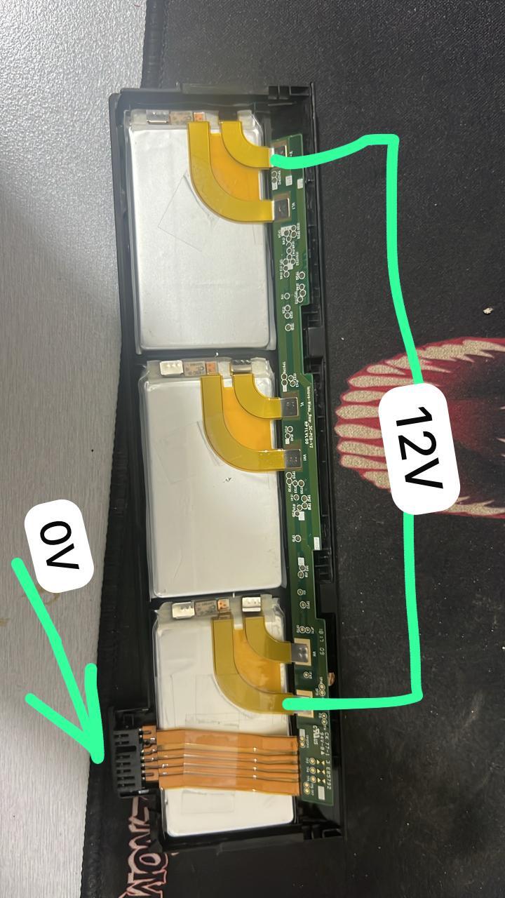

                                hello . i have a problem on t470 batteries, the voltage on battery cellule is ok (total 12 volts) but on board no voltage . any one can help me
