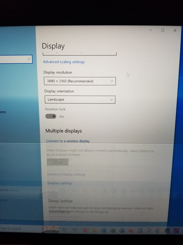

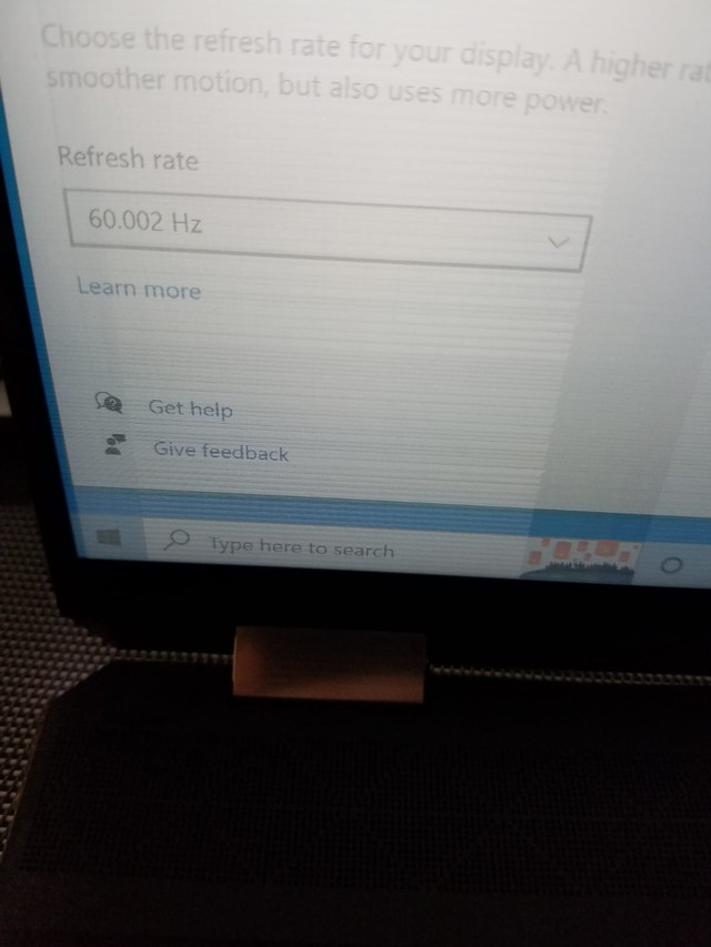

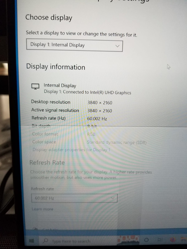

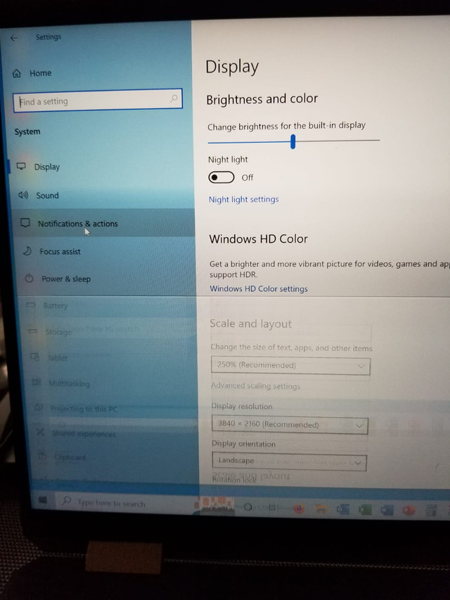

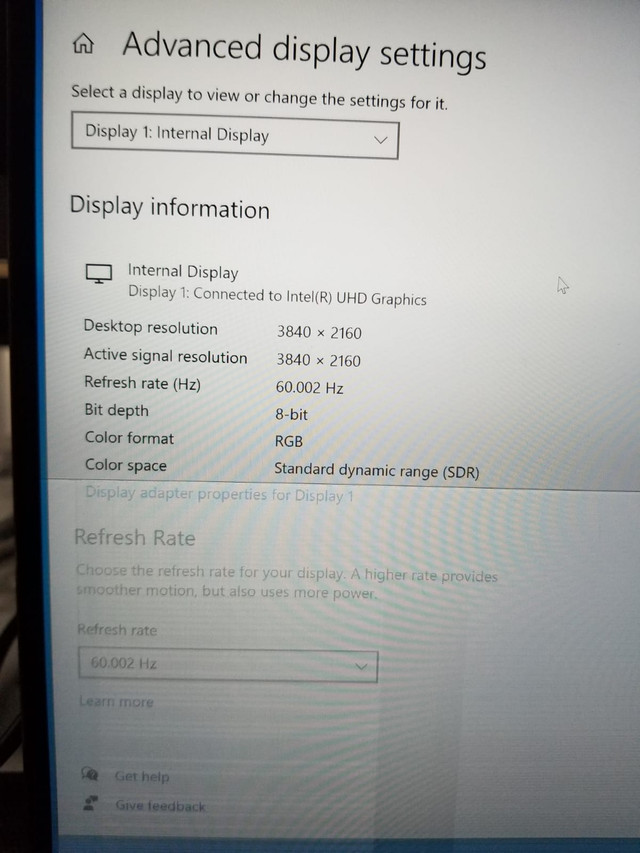

    Hello!
    I'm helping my mom with her HP Spectre x360 15-EB laptop. It's a convertible laptop, with a UHD IPS LCD touch panel.
    Bottom half of the screen has lines and artifacts, and top half is fine. I'm unsure if the issue is a bad display, a bad connection, a bad GPU, or something else. I live in Canada and my mom doesn't, so I can't be physically there to do any troubleshooting.
    I'm posting some photos of the problem, hopefully someone here can shed some light on this!
    Thanks!

    Re: HP Spectre 15-EB half of screen has artifacts
    Could be cable seating or damage, but more likely the screen.
    • mcplslg123
      • Jun 2015
      • 7262
      • india
      Very likely scrren is defective
      • darckreign1984
        • 260
        • Romania
        similar issue on a dell 14" laptop - that have touch screen.
        Screen faulty for me
        • eoy4
          • Apr 2023
          • 3
          Thanks everyone, bad screen was my best guess too. Just ordered a replacement screen and she'll have it professionally installed.
