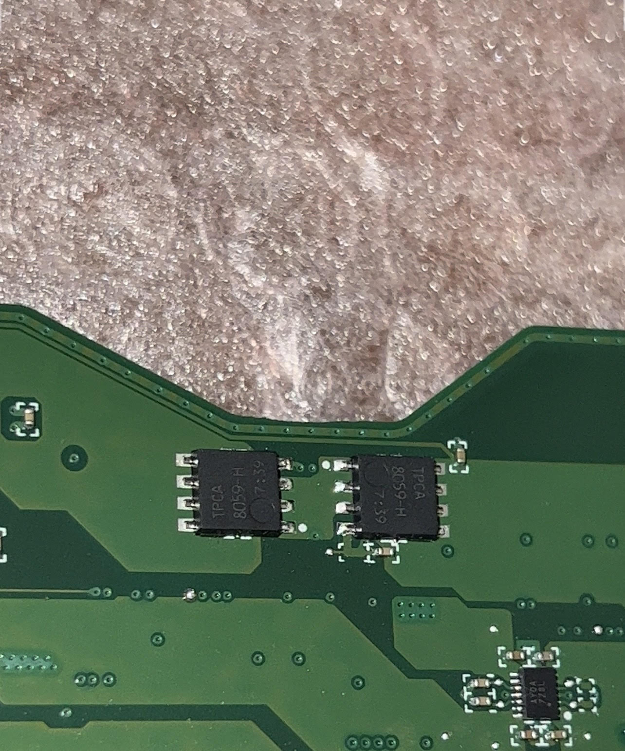

    Hi, anyone that could help me? My asus GL503VD Suddenly turned off one day. My laptop doesn't turn on, when i try to turn it on with the charger plugged in nothing happens. Also the led indicators don't light up. I tried disconnecting the battery and plug the charger in and same issue persists. I noticed that the motherboard makes a small clicking sound when the charger is plugged in but that's it.. i got the tools to measure resistance etc.. so if anyone could help it would be really appreciated.

    Them locate the 8 pin mosfets that will follow. Mosfets are electronic switches that must enable to power the logic board.
    Post the topside markings of these mosfets. Great if you can post pics of the area.
    Often, the 2nd dcin mosfet gets damaged. To be determined.

      I measured the voltage when i plug the charger in and I’m getting 0.44V.
      the Mosfets that are used are the TPCA 8059-H.

        These are N-channel mosfets so the GATE pin has to be higher than the voltage being passed between source / drain pins.
        Measure the voltage to ground of each pin of each mosfet.
        source (1-2-3)
        gate (4)
        drain (5-6-7-8)
        https://www.arrow.com/en/products/tp...hl1q-m/toshiba
        Continue to review the logic board for the battery charger IC on this board. The gate pins of these mosfets is being driven by the charger IC. It is possible that the charger IC is the 'BQ' series from TI.

          Okay, this are the voltages i got.
          Left Mosfet:
          Source: 0.37v
          Gate: 0.37v
          Drain: 0.00v
          Right Mosfet:
          Source: 0.37v
          Gate: 0.37v
          Drain: 0.37v
          I forgot to mention that the battery charger IC the BQ24780S

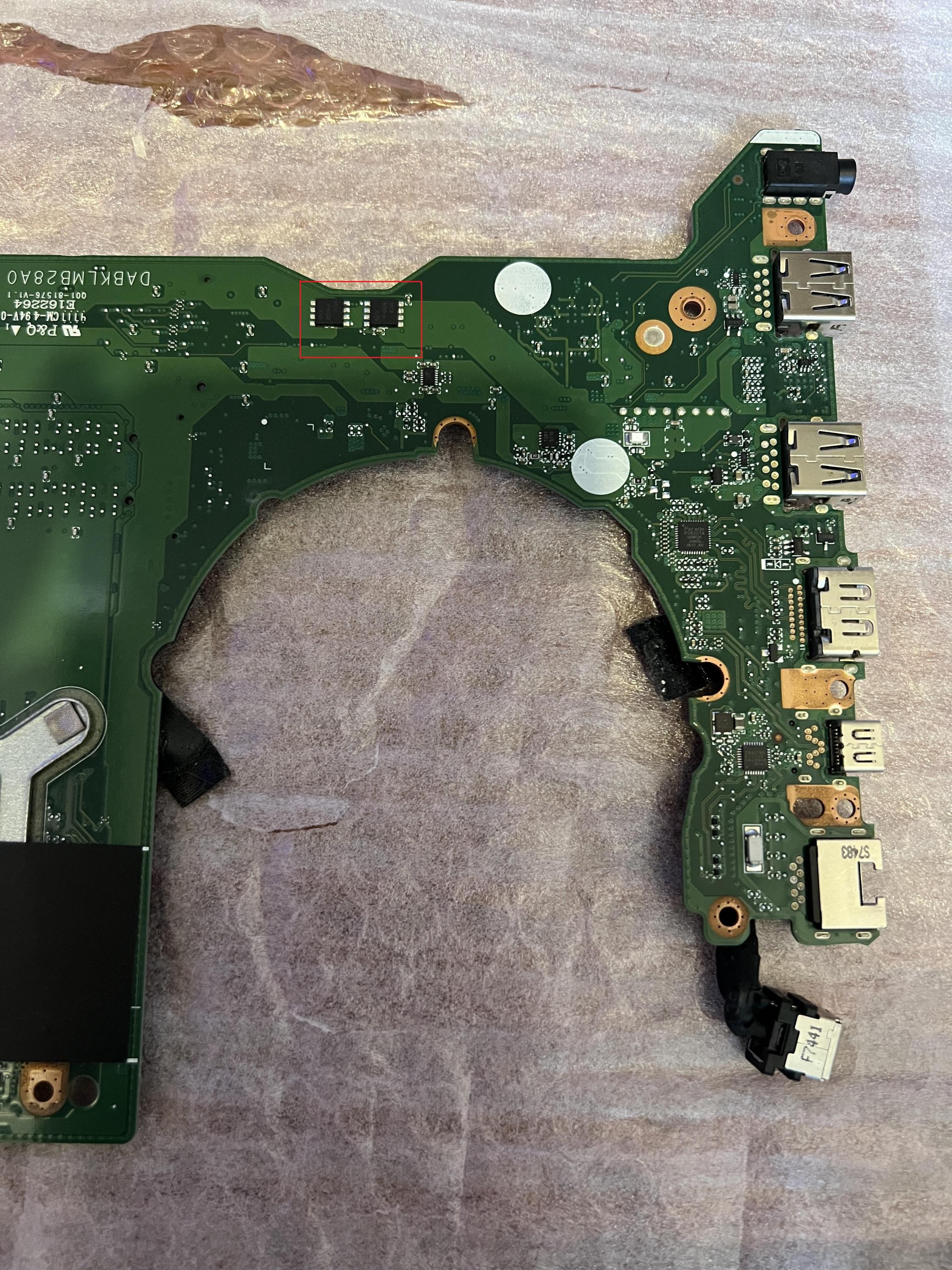

            I do not think that are the in rush mosfet the first and second mosfet the red corner. I think they are on the otherside of the board

              Ditto. Locate the DCin power adapter connector and then locate the mosfets close to the charger IC.
              If there is a fuse, check if the fuse is receiving power from the adapter.
              These mosfets are not being powered.

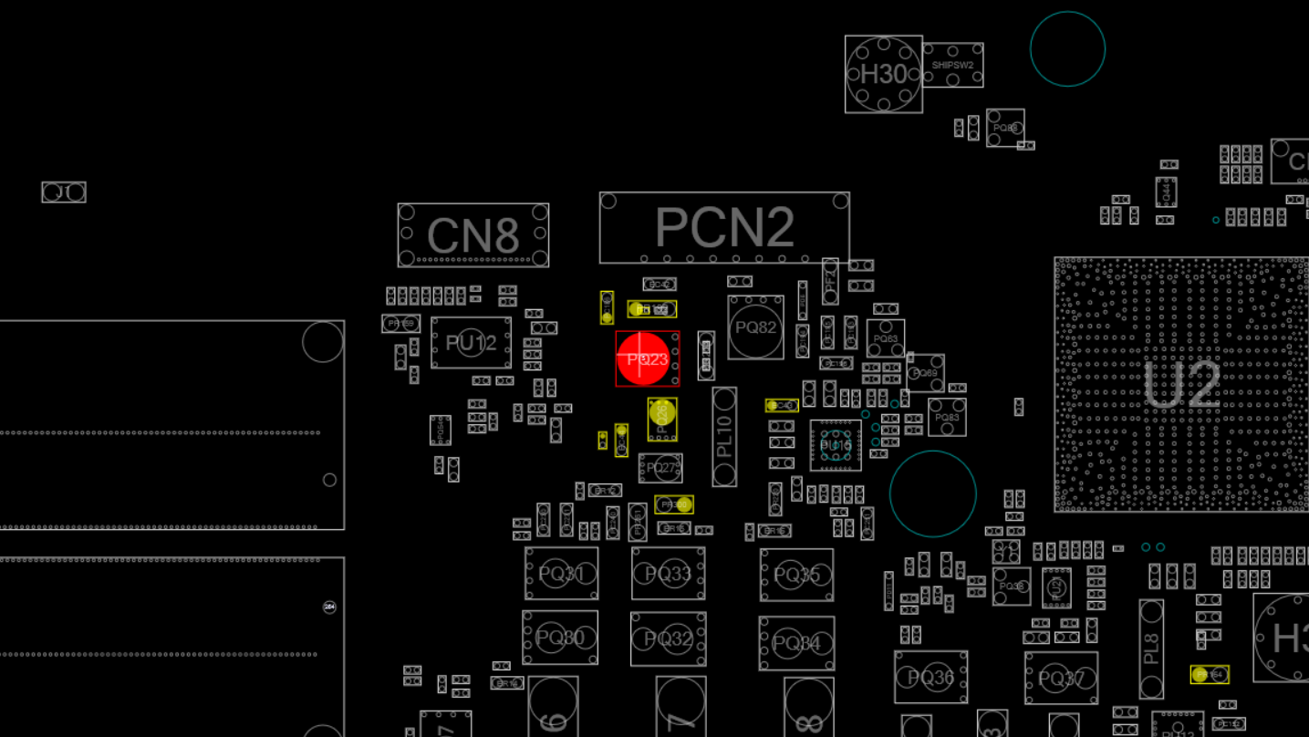

                            I checked the schematic of this laptop with boardview and i see that the drain from the left mosfet is connected to a other mosfet close to the battery charger IC. I removed the left mosfet but still had the short. After that i also decided to remove the one close to the battey charger IC but still the same problem, (i marked it with a red cross). You can see in the attachment that there are other components that are connected to it. I'm not sure which one i should check next.

                              There is no point in removing components this way, this is your main power rail and the short could be anywhere. Look carefully around the entire board for a component that is darkened or visually different from normal, it is most likely a ceramic capacitor. If you find nothing, the only way out is to inject 1 volt/2 amps and see for a heating component with a thermal camera or if you don't have one just feel with your fingers what is heating up.

                                I will take a look, if i want to inject voltage. From where can i do it ? I don't want to kill the motherboard.

                                  If you truly have a 0.6 ohms resistance to ground, injecting with 1v (NOT higher!), then the defective part will heat up and pop or crack like a pimple. (Ok, I am grossed out by that as well).
                                  Often caps that will split and you can smell it once they. Have seen tantalum caps do this as well as ceramic.
                                  You will inject the voltage at the mosfet pin that reads this low resistance to ground.
                                  Red DC power supply pin there, black to ground. Do not go higher than 1 volt - just in case this rail is directly reaching the CPU but if it is, then the CPU is likely already dead.

                                    At any point of the power rail, but in order not to do something stupid, it's best to be let's say after the second mosfet, exactly where you measured 0.6 ohms.

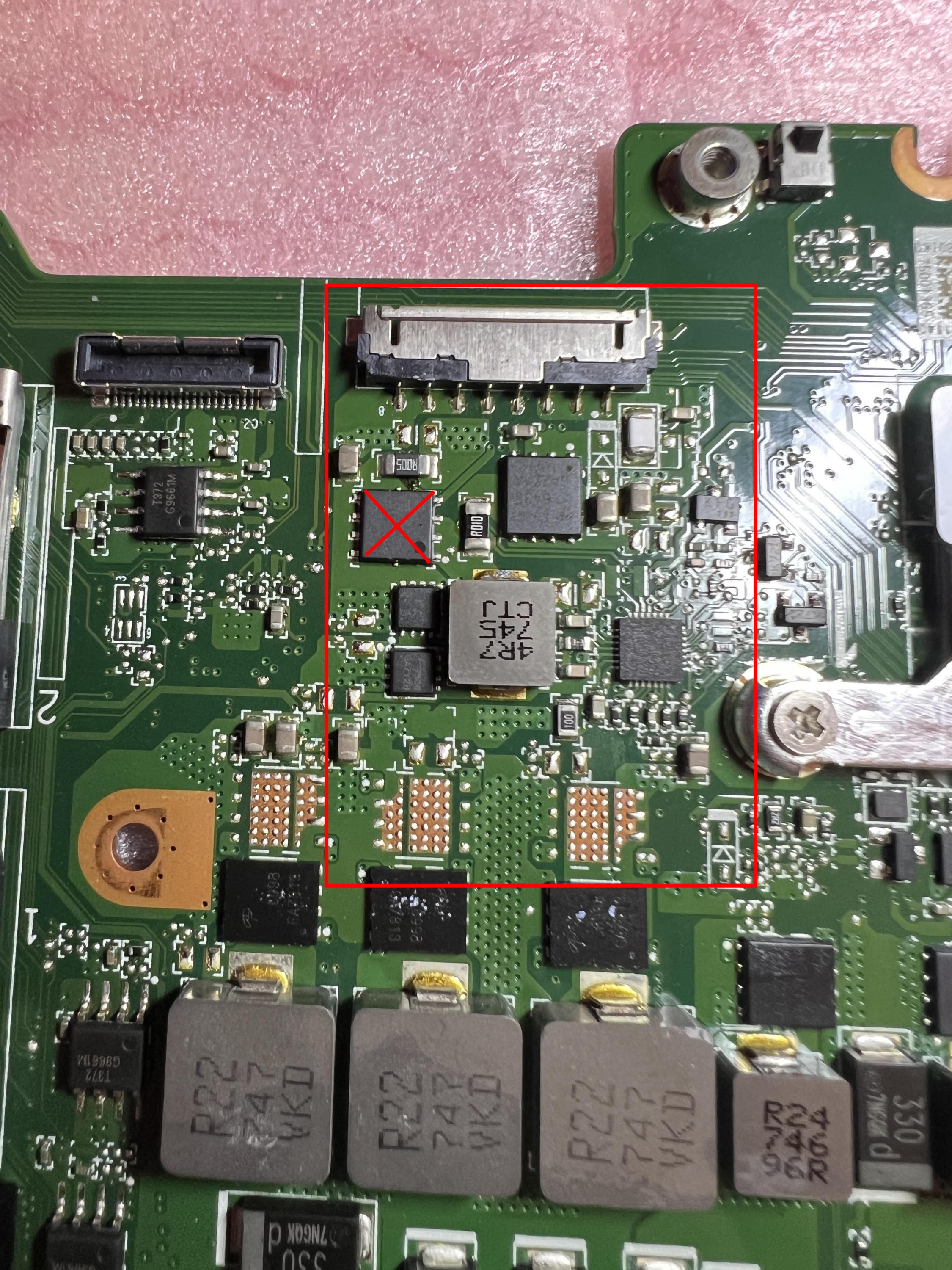

                                    • Jasonexe
                                      • Apr 2023
                                      • 69
                                      Re: Asus GL503VD Not charging or powering on
                                      i tried injecting 1v but i didn't feel any components getting hot. When i try measure the voltage where the short is while injecting it drops to 0.080v
                                        How much current was consumed?
                                        Is the CPU with a heat sink?
