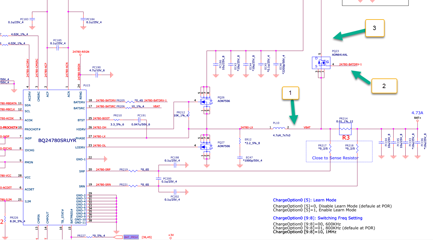

            #65
            Re: Asus GL503VD Not charging or powering on
            Yes, i still noticed a problem. I can use the laptop with the charger but once i unplug it, my pc will turn off instantly. Windows is telling that my battery is 100%. I also tried measuring the voltage of the battery connector when the laptop is turned on and the voltage fluctuates between 0.6-0.8 volts. When i listen carefully i can hear a crackling sound close to the battery connector.
            • mon2
              • Dec 2019
              • 14659
              #66
              Remove the battery.
              Meter in dc volts mode.
              Measure the voltage to ground of each pin the battery connector on the logic board side.
              The crackling sound may be contact arcing between the battery and mating connector contacts.
              While the battery is removed, check the voltage on the battery without the laptop as a load. Is the battery charged?
              See attached.
              What is the voltage to ground of pin 15 (BATPRES#) without the battery connected?
              What is the voltage to ground of this same pin, with the battery connected?
              Remove the power adapter so that only the battery is powering the board.
              What is the voltage to ground @ PL10 (point #1)?
              point # 2 (battery mosfet gate) and
              point # 3 (battery mosfet drain pin cluster) ?
              When the battery is present, pin #15 (active low signal) must be LOW (0v).
              When the battery is absent, pin #15 should be pulled high by resistor PR531 and the voltage rail +3VPCU.
              Respectively, when the battery only is present, the charger IC should enable the battery mosfet @ PQ23 to power the logic board.
              Confirm this operation by checking the mosfet pins of PQ23.
              When the adapter is connected, PQ23 should be OFF.
              Confirm it.

                      #70
                      Originally posted by mon2
                      Remove the battery.
                      See attached.
                      Confirm it.
                      I measured voltage from pin 15 and i get a voltage that fluctuates between 0-120 millivolts, same thing when battery is connected. I confirmed that the battery is dead, i tried recharging it with a adapter but after a couple hours it was still refusing to output any voltage.
                      • Jasonexe
                        • Apr 2023
                        • 69
                        #71
                        Edit: i decided to disassemble the battery pack (4 cells) and measured voltage from each cell and i get around 3.98v. When i measure from the battery connector i get nothing. So i think that a component on the pcb where the battery cells are connected is defective.
                        I also measured voltage from the battery connector on the motherboard with the battery removed.
                        pin 1, 2 and 3: voltage fluctuates between 2.61-3.80v
                        pin 4: voltage fluctuates between 3.18-3.20v
                        pin 5: voltage fluctuates between 3.18-3.25v
                        pin 6, 7 and 8: voltage fluctuaes between 0-2mv
