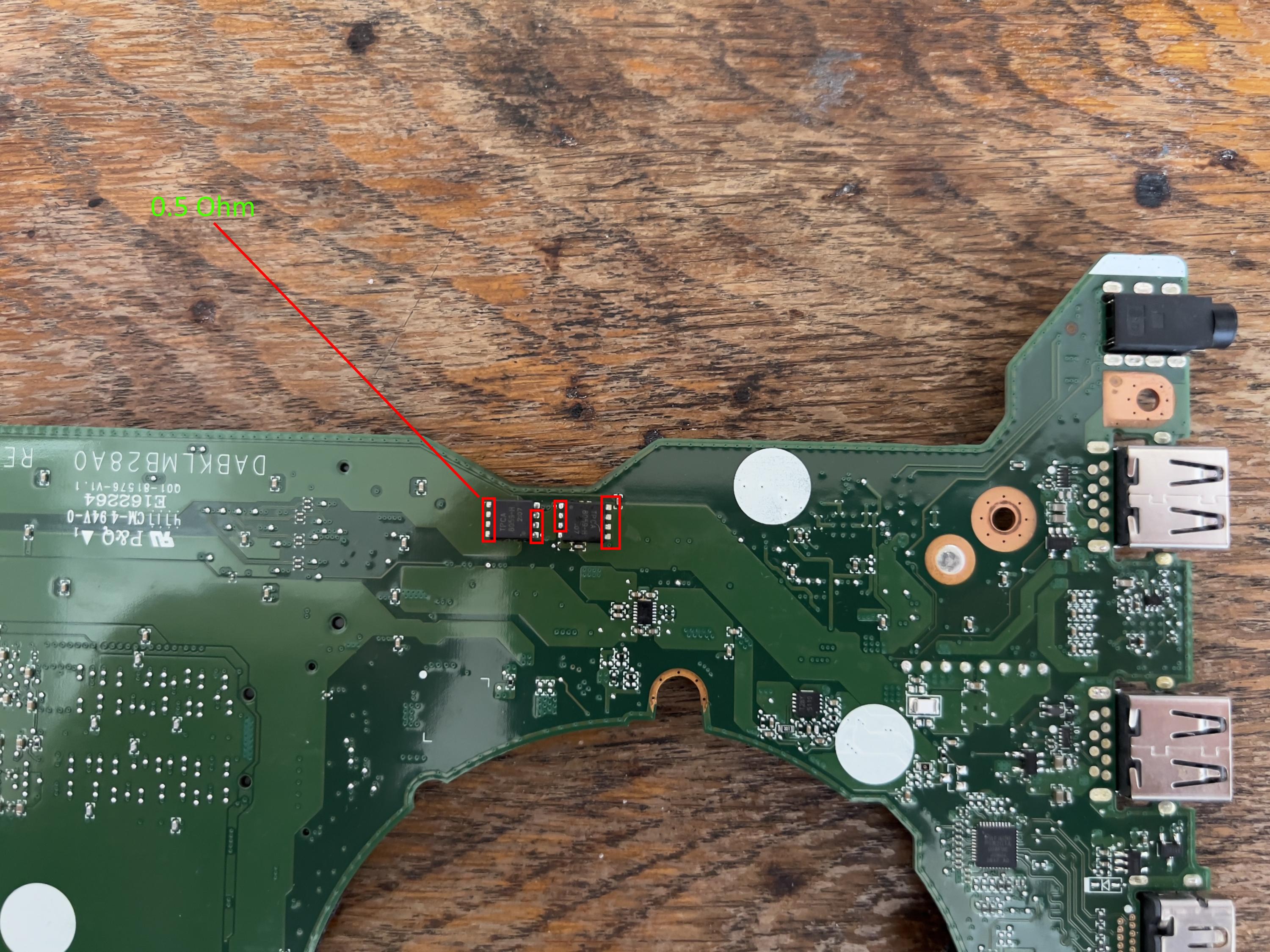

                    #49
                    Re: Asus GL503VD Not charging or powering on
                    Okay the ground points are good.
                    I checked resistance of both mosfets i replaced and i'm getting 0.5 ohms on the drain pins when measuring the mosfet on the left side. The mosfet on the right side gives me 7K ohms on the drain pins. I get the same resistance on the source pins and gate pin from both mosfets. My multimeter was set to 20K when i was measuring
                    however.. if i set 200k on my multimeter i get 39.2k ohms as reading on the pins where i was getting 7k ohms on. Im not sure if that is normal ?
                    I also checked the resistance from the inductor close to the battery charger ic and im getting 7.51k ohms when multimeter is set to 20k, when i set 200k on my multimeter i get 32.7k ohms as reading.
                    • mon2

                      #50
                      That is a very low resistance to ground.
                      Can you identify if this mosfet is PQ21 or PQ22 ?

                        #51
                        I checked and i believe that the mosfet with low reading is the PQ22.

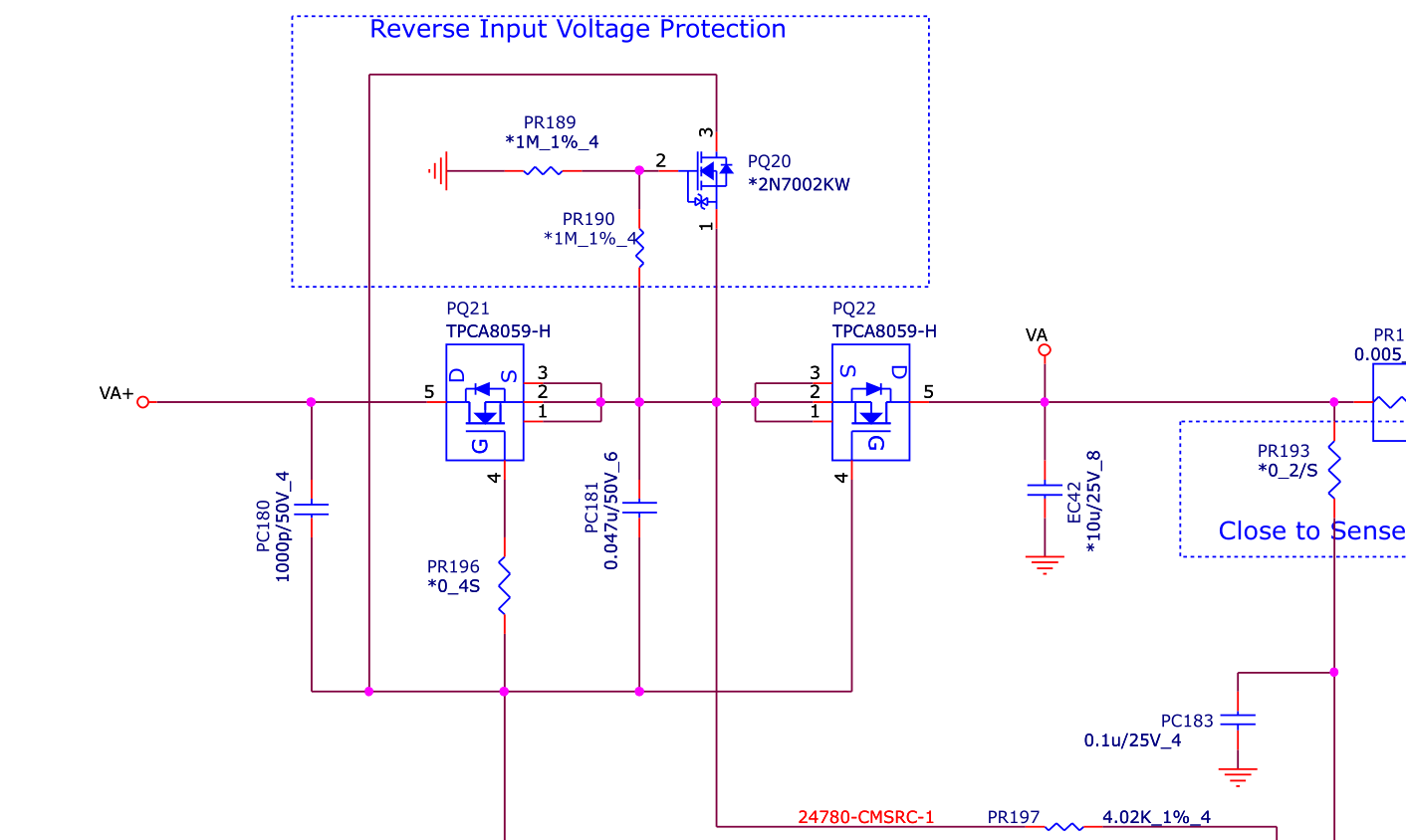

                          #52
                          Originally posted by Jasonexe
                          The short is gone after desoldering it. Both mosfets are the TPCA 8059-H so i will replace them both.
                          Originally posted by Vesko356
                          And most probably you're wrong with your conclusion about the fault.
                          You see? What did I told you?
                          Obviously you have a shorted main power line...
                          Yes it is, I don't have a schematic for this board, but according to the image these are first two input fets.
                          @Jasonexe:
                          Exactly as I told you, 0.6 Ohms is a dead short. Now you must find what is shorting your main power line.

                            #53
                            @Jasonexe:
                            What could i do to find the short? before i tried injecting 1v to see if anything gets hot but nothing was heating up.
