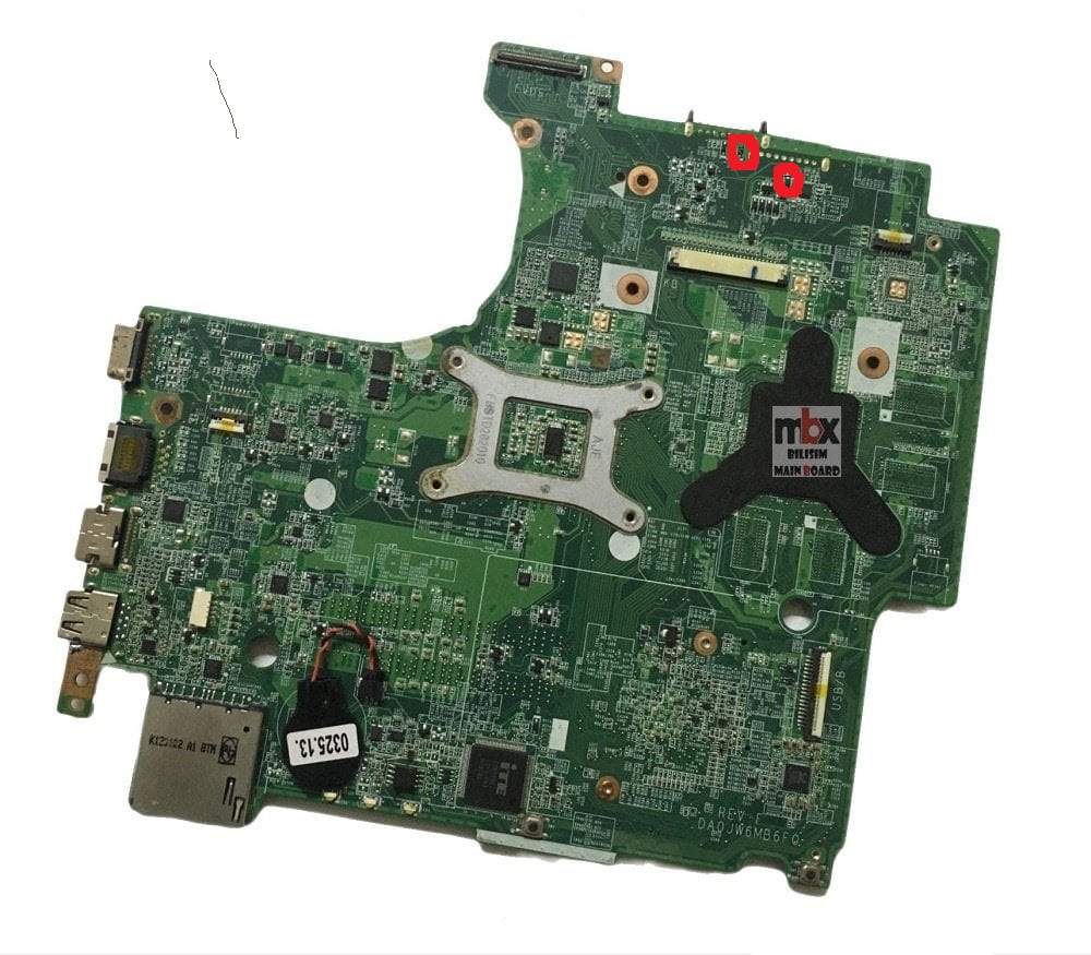

Da0jw6mb6f0 rev.f does not charge the battery
  • baki60
    • May 2020
    • 78
    • Türkiye
    Da0jw6mb6f0 rev.f does not charge the battery
    everything is working properly
    does not charge the battery
    battery tested
    there is 3v 3.3v at the battery inlet
    help masters
  • mon2
    • Dec 2019
    • 13996
    Re: Da0jw6mb6f0 rev.f
    Locate the charger IC.
    Link or post the schematic.
    Measure the voltage to ground of each pin of the charger IC.
    Do also measure the voltage readings of each contact on the battery connector with the battery connected.
    Post the measurements.
    • baki60
      • May 2020
      • 78
      • Türkiye
      Re: Da0jw6mb6f0 rev.f does not charge the battery
      battery input
      1-gnd
      2-gnd
      3-3.25
      4-3.25
      5-0.15
      6-13.02
      7-13.02
      power supply amps:0
      • mon2
        • Dec 2019
        • 13996
        Re: Da0jw6mb6f0 rev.f does not charge the battery
        This is the battery connector and looks ok.
        Locate the charger IC which will be nearby. Perhaps the BQ series by TI.
        Post a picture to confirm. We need the voltage of each pin on the charger IC.
        • baki60
          • May 2020
          • 78
          • Türkiye
          Re: Da0jw6mb6f0 rev.f does not charge the battery
          I missed the diode blade near the charging IC.
          i solved the problem
          Thank you for your interest
          • mon2
            • Dec 2019
            • 13996
            Re: Da0jw6mb6f0 rev.f does not charge the battery
            Well done. Perhaps you can post a picture of where this diode was missing for future readers?
            • baki60
              • May 2020
              • 78
              • Türkiye
              Re: Da0jw6mb6f0 rev.f does not charge the battery
              of course my master
              PD3 AND PD1
              • techfreak9356
                Vostro 3400 (LA-K033P) won't charge battery, everything else ok
                by techfreak9356
                I bought a Vostro 3400 motherboard (LA-K033P) to upgrade over my damaged Inspiron 5593 (LA-J091P) board. Everything else is ok except for the battery. This battery I am using now is already a replacement one since I disposed of the bloated original one. Back in the Inspiron 5593 motherboard, the battery charges fine and is identified just fine. However, with the upgraded motherboard, suddenly the replacement battery is labeled as "Not a dell battery". When I borrow a similar battery from my colleague (which did not have replacements yet), it is identified and charges just fine.
                09-14-2023, 11:10 PM
              • razenxd
                How can I charge that battery pack?
                by razenxd
                it's not a laptop/desktop related question but I figured that someone here will have the right knowledge.
                At work we use a few Aldebaran(now Softbank/United Robotics group) Nao Robots which they use some custom 6S li-on battery packs.
                Nao robots tends to draw from the battery even if they are shut down, and the BMS tends to be a little aggresive, if the pack stays on a turned off robot for 3 months it's gonna lock and will refuse to charge.
                Now, I have noticed a few things.
                The "dead" battery, while connected to charger and NOT Charging will...
                12-05-2024, 06:11 AM
              • ruletero
                Acer a515-43 low battery charge voltage
                by ruletero
                Hi
                Acer A515-43
                LA-H801P
                Fail: Does not charge battery, has low voltaje on connector.
                Laptop didn't want to turn on, only charge led blinked.
                I found PQB5 (mosfet high battery charger) in short, voltaje in +12.6V_BATT was 19 v ...
                I changed it, changed PQB6 too and now battery charger voltage is 4.4V but battery is 3 cell, 11.25v, then is very low to charging.
                Laptop turns on without battery and works fine, but with battery turns on and turns off inmediately, I suspect battery bad but I don't know...
                10-24-2022, 02:31 PM
              • Klevjetack
                Charge a L19D3PDA battery externally from the laptop
                by Klevjetack
                Is there a way to externally charge a L19D3PDA battery from the laptop. I have a broken charging port on my laptop and am trying to find a way to charge the battery for it. I have been doing some research and I have found that there is a module, TP4056, that can be used to charge Li-ion batteries. It says it is used to charge single cell Li-ion batteries. The L19D3PDA battery is a three cell battery. Is it possible to use the module to charge my battery and it would just be very slow? Or would that be a bad idea. Is there a different kind of module I can use to charge my Li-ion three cell battery?...
                03-05-2024, 07:26 AM
              • dclass-pro
                Latitude 3301 not charge battery
                by dclass-pro
                Hi guys I have this dell that with the battery charged it turns on correctly, but if I connect the charger I get the charging symbol but it doesn't charge the battery.
                I found the shorted charger PU4401 ISL9538h that had pins 14 and 15 shorted and I replaced it. but it still doesn't charge.
                I noticed 2 things:
                1) without the battery connected if I connect the power supply, on the SDA and SCL pins of the battery I have 0V I measured the resistance with ground and it is very high, if I connect the battery I have 3v on the 2 lines.
                2) if I try to turn it on without the battery...
                05-06-2025, 06:19 AM
