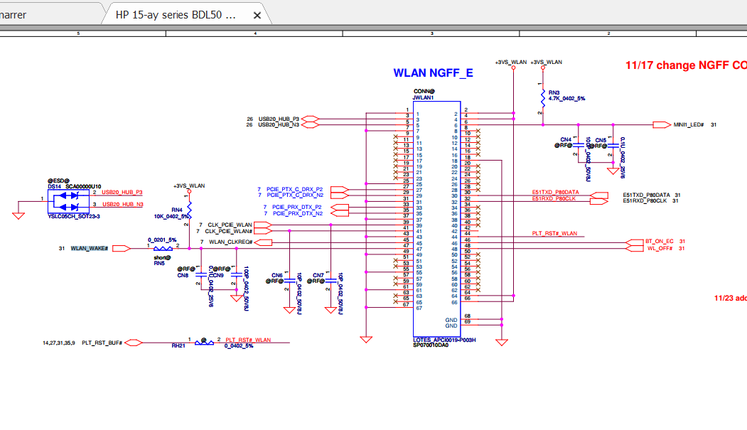

    hp not detect wifi card
    hello enyone can help
    bios ok
    change card ok
    +3VS_WLAN : 3.3v
    WAN WAKE# : 3.3 V
    WHAT NEXT ?
    ENYONE HAVE WIFI CARDS DATASHEET I NEED INDERSTAND HOW IT WORKS
    THANK YOU

      Re: hp not detect wifi card
      Originally posted by Kambi13
      What hp model is it? Did you swapped the wi-fi module with another one?
      THANKS FOR ANSERING
      I TRAY MANY CARD
      I DO NOT TALK ABOUT SPECIFIC MODEL
      i don't care if the laptop is not fixed i need to inderstand haw wifi card work
        Many HP laptops have a whitelist in the bios,that will only allow certain wifi cards,if they are not in the list they won`t work. The fix is to modify the bios.Sometimes a couple of pins on the wifi card can be taped over to make it work.
        By the way TYPING IN CAPITAL LETTERS IS CONSIDERED AS SHOUTING,AND VERY RUDE
          The wi-fi module may not work in some hp models if it's not the same chipset as the original, as SMDFlea stated, and quite well btw, that was exactly my initial tought.
            Also never forget about the Intel CNVi nonsense.
