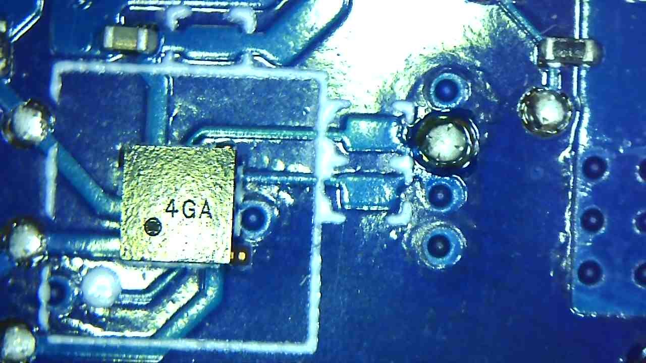

    Just arrived a Magicbook with m/b DAH98AMBAD0 completely dead, power LED stay OFF.
    Checking with thermal camera I see a chip labeled 4GA "pulsating".
    4GA code point me to "FT521GAb"="LDO, Dual out, Vout1/Vout2=2.8V/1.2V±2%, 250mA, +CE"
    Maybe something is shorting it ?
    What can I check ?

      Voltages of nearby components fluctuate when fed from the original power supply.
      I've also tried another power supply...same behavior.

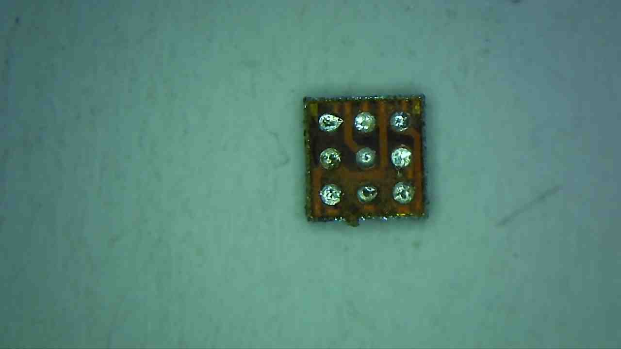

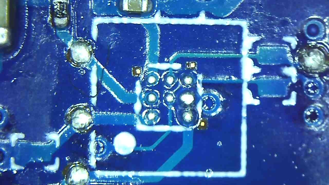

      This morning I've injected up to 4.5V (starting at 1V@1A) on the main power rail (this laptop is powered by a USB Type-C) and starting from 4V this chip immediately overheats on the thermal imager.
      So I've removed this "4GA" part and I'm looking for the datasheet to find a replacement
      Note: The voltages do not fluctuate with the bench power supply.

          Found !
          4G(A) = RT1711H Programmable USB Type-C PD Controller
