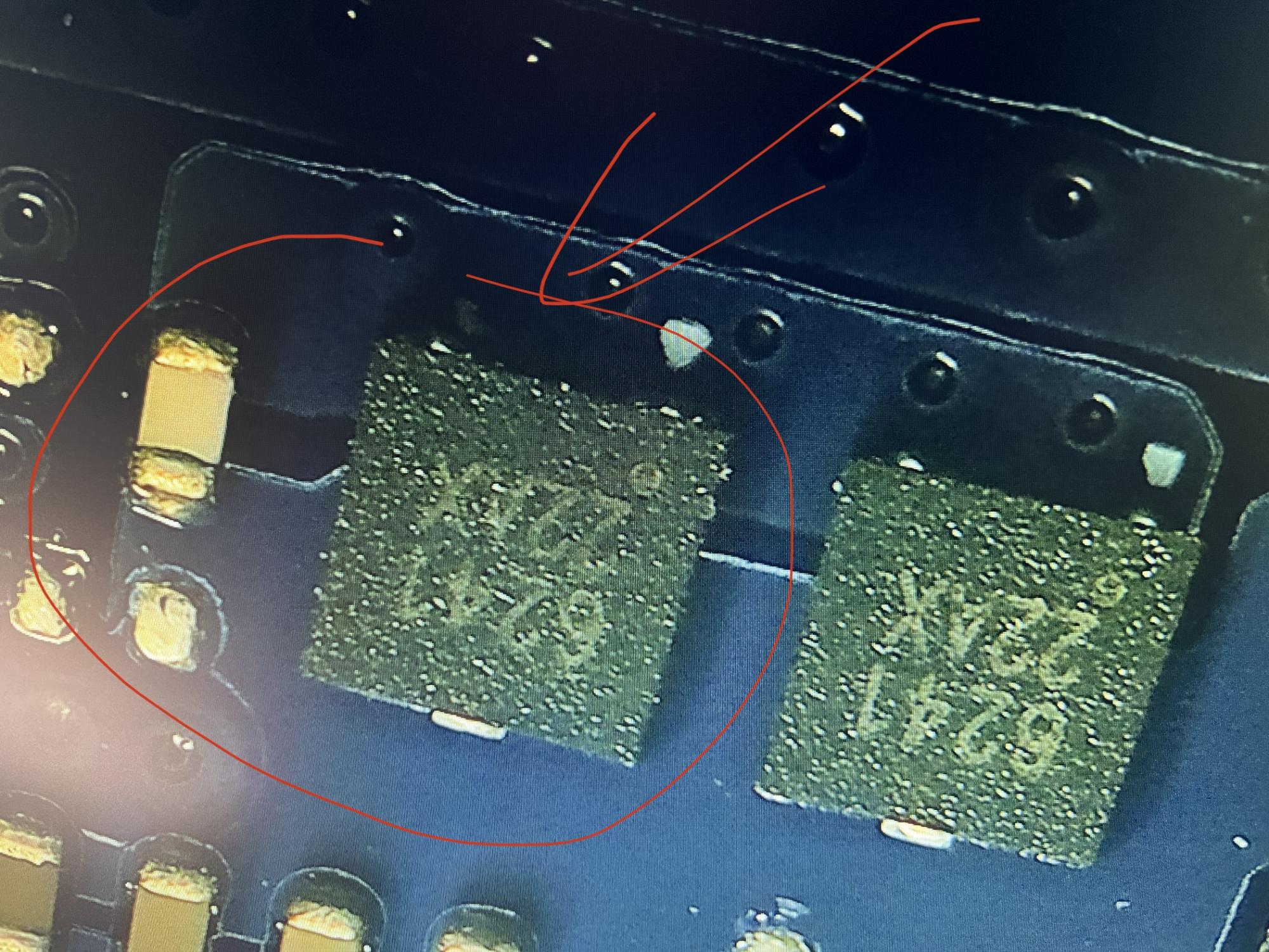

    Re: DAH98AMBAD0 Rev D Huawei Matebook No charge need schematic or boardview
    We don't need no stinkin schematics.
    Review the logic board and follow the DCin connector and likely you will see 2 x DCin mosfets -> then the charger IC.
    Review the topside markings -> are they the 'BQ' type? Post all markings. Even better if you can post clear close up pictures of this region.
      I was able to check with the thermal camera and as soon as I insert the charger this area becomes very hot for 1/2 seconds, the capacitor is shorted as well as obviously all the following ones
        US $6.50 | 5-10pcs Marking 6241 Charging protection IC Chip
        https://a.aliexpress.com/_mKzaPzk
          Great, thanks, i order them, if i remove the first one shorted should it charge? Is this a double charging protection?

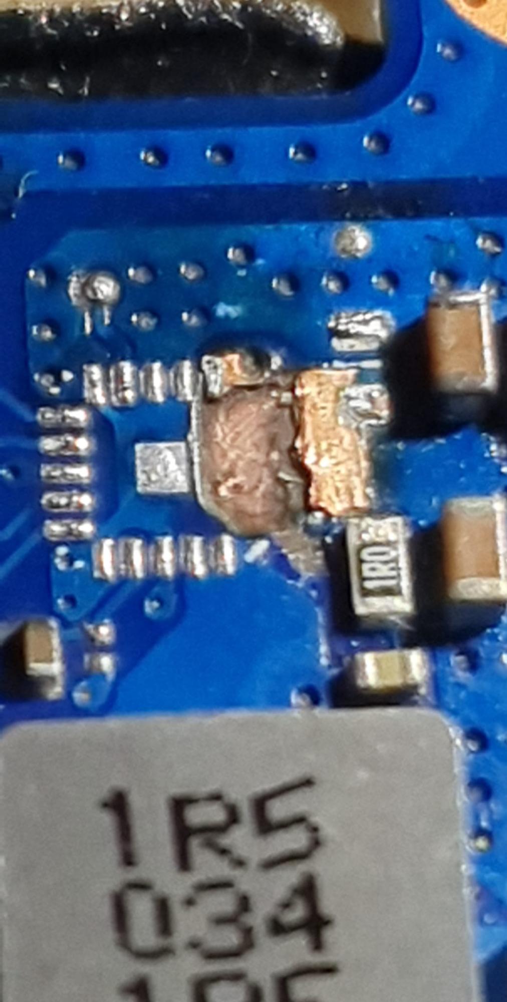

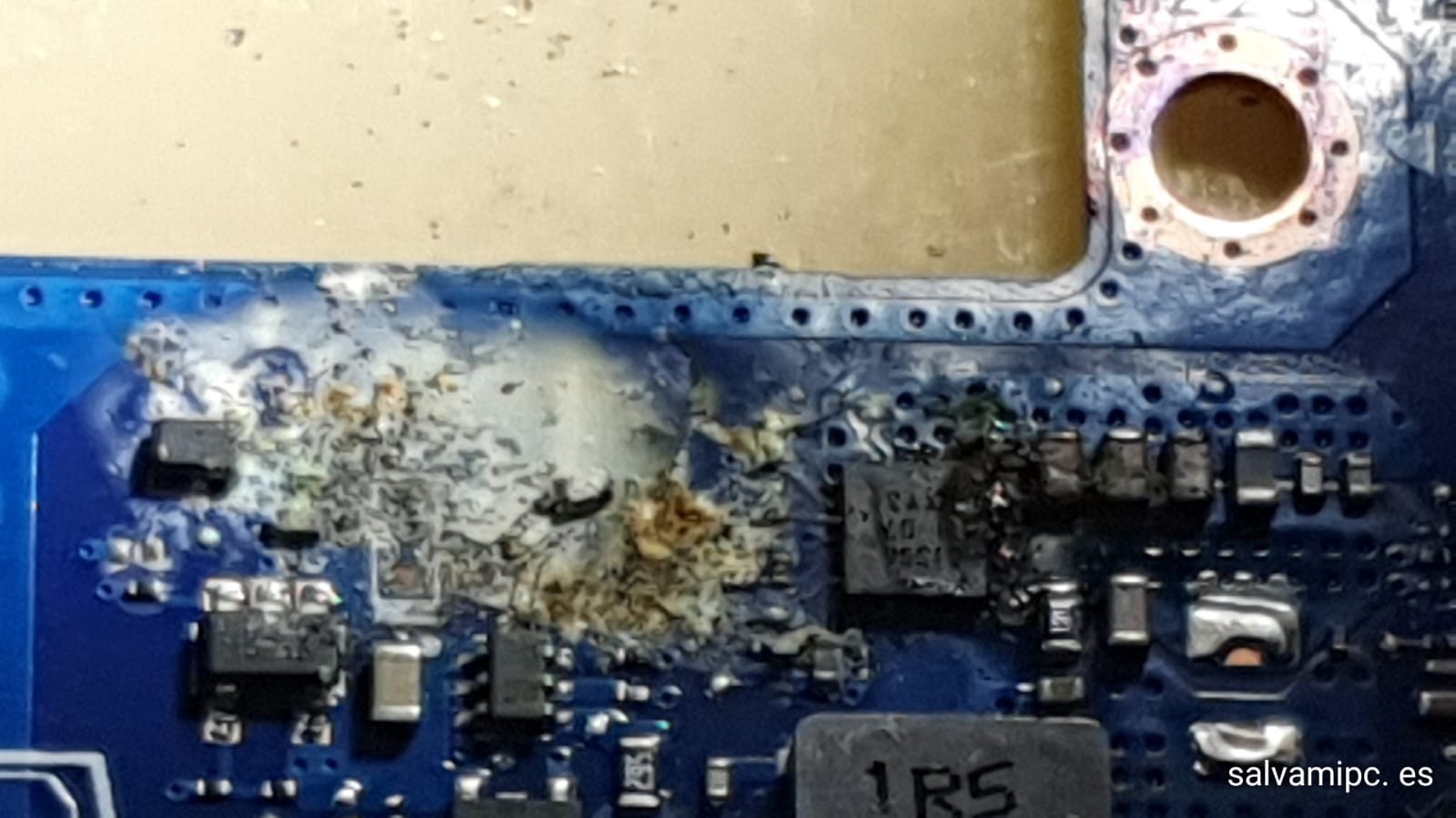

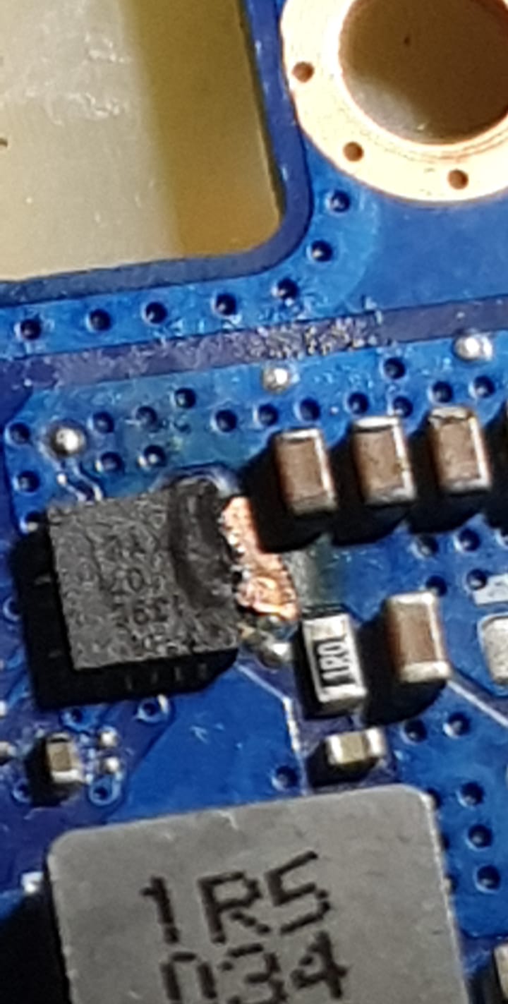

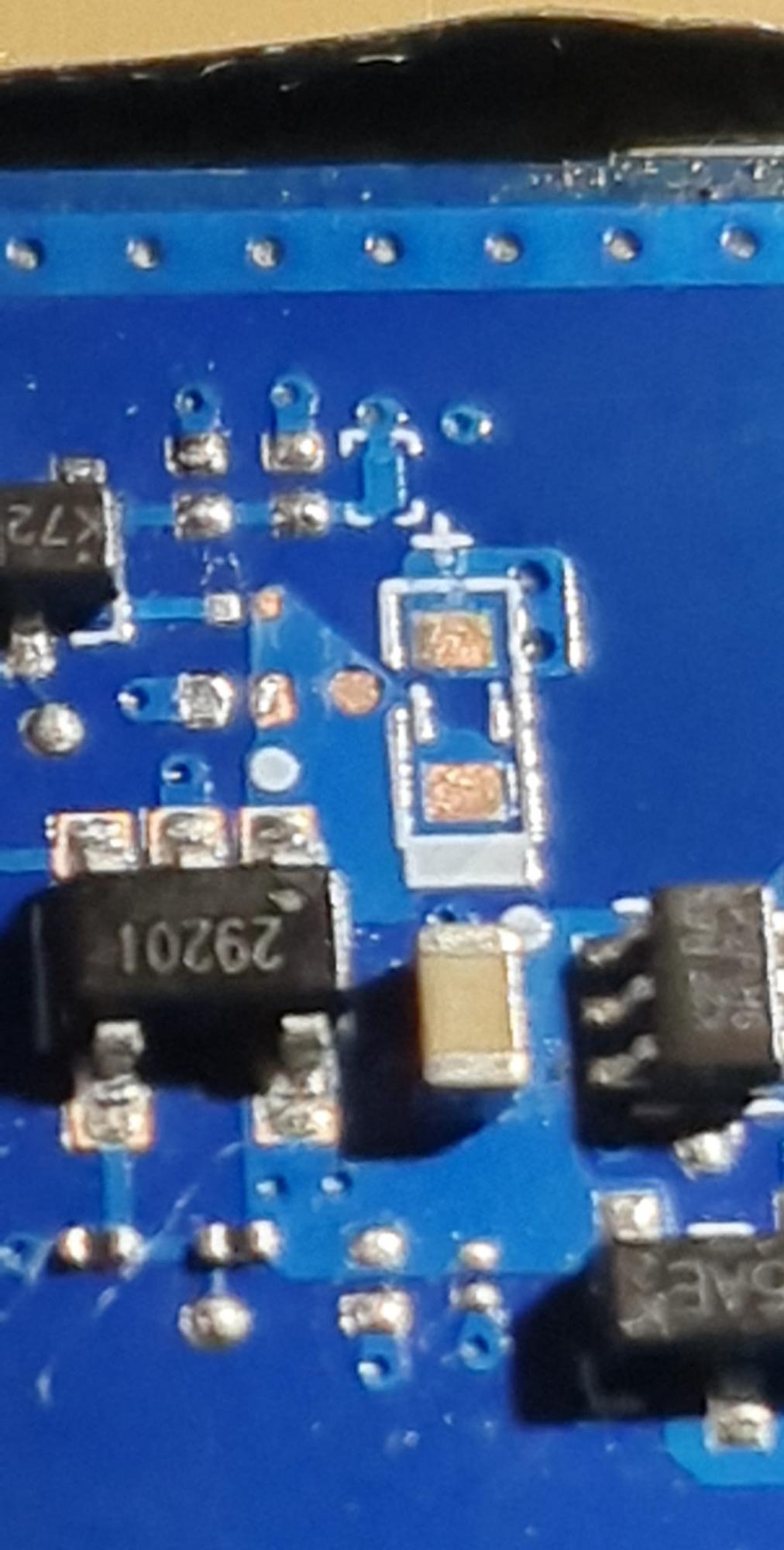

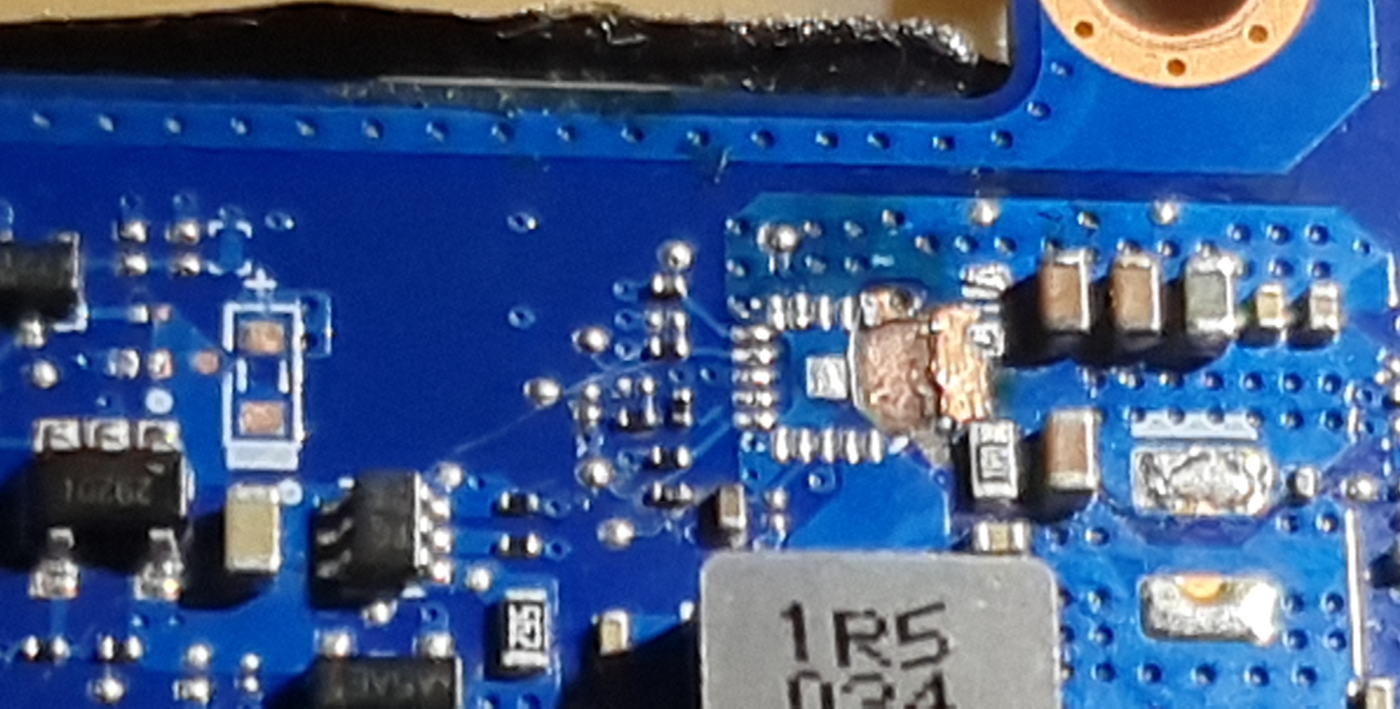

              HUAWEI MateBook D 15 AMD - dah98ambad0
              I have a HUAWEI MateBook D 15 dah98ambad0 rev: D, has a bit of liquid damage, a buck converter exploded, and few missing componentes that I need to identify. I clean the area and remove the buck converter, as well the first cam was short, now there no more short, plugging the ubsc I have 9v on the in of this buck converter.
              Can anybody help me identify the components on the left of the tps51396 are, looks like 3 components.
              Or if anybody can share a schematic or board view.

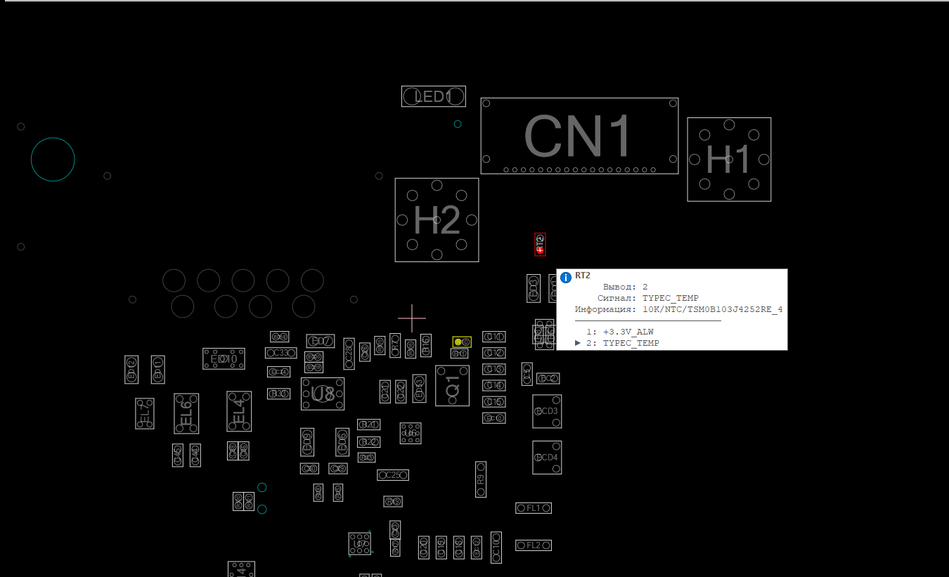

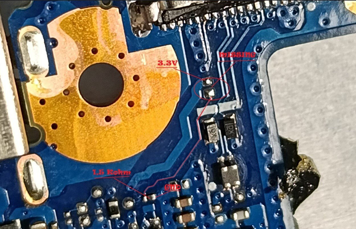

                              Help to identify missing component near the usb-c charging port. Seems to be a missing resistor. Pads are redoned by me. Thanks
                              • Rezistor
                                • Jun 2021
                                • 308
                                • USSR
                                NTC (10 kOhm)
