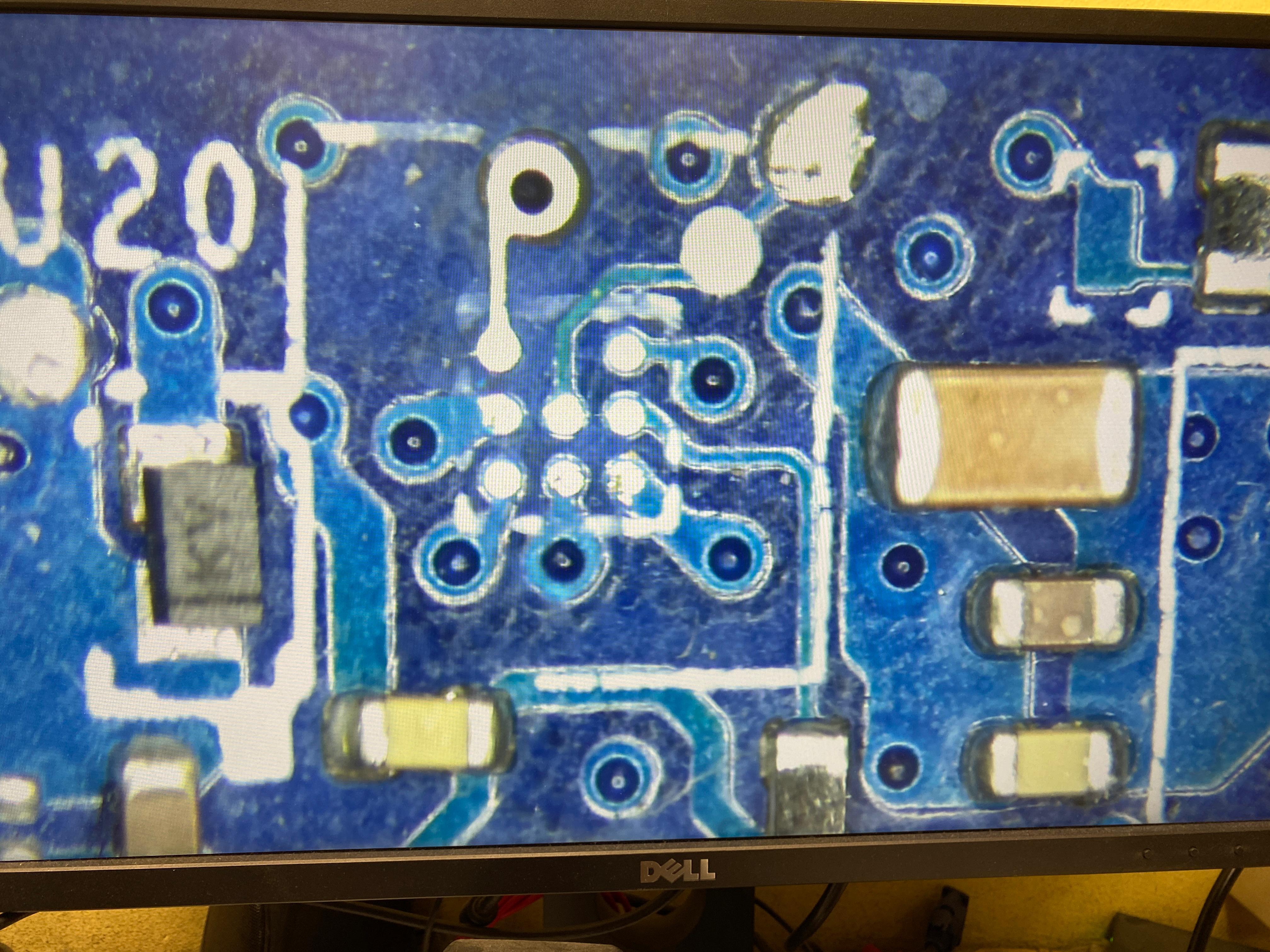

    Attached detailed photographs of the motherboard part.

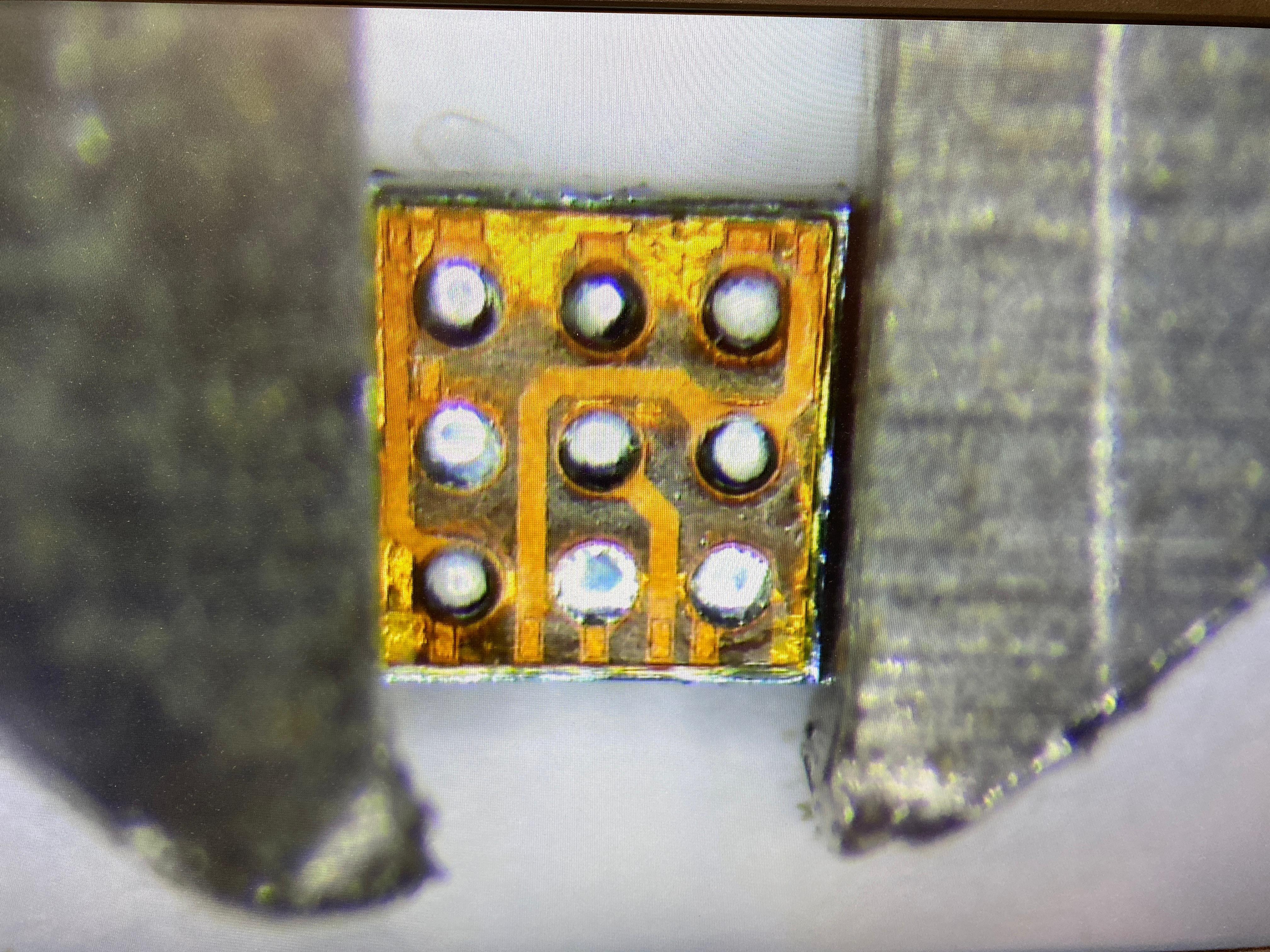

    The integrated U20, on the front of the chip it says 4GD and a Chinese logo very small, looking with the microscope from the side, it has 3x3 solder balls.
    There is no schematic or boarview available anywhere.
    Thanks a lot!!

    Post the best picture you can take of this WLCSP9 packaged device.

      Here they are, U20 zoomed at max.

        What is nearby? Usb connector? The limited boardview balls seem to hint this to be a load switch.

          I unsoldered it to take the photo below, and we put new tin on it and assembled it. And it does the same.
          The chip is part of the current input circuit of the single USB-C port, I have also changed the previous mosfet (EMB20P03), and nothing.

            Can you trace the wiring from the USB-C port pads to this device? This may be a low capacitance ESD suppressor that has taken a hit. Such devices use a flow-through pinout and will not impact the USB operation as long as this device is not defective but the ESD protection is then lost.

                      I found a user with the same problem, and he find it...is the same IC
                      https://www.badcaps.net/forum/troubl...h98ambad0-dead
                      The shit IC: https://www.richtek.com/assets/produ...DS1711H-04.pdf
                      • matheus30
                        • Apr 2016
                        • 27
                        • spain
                        Solved, works!

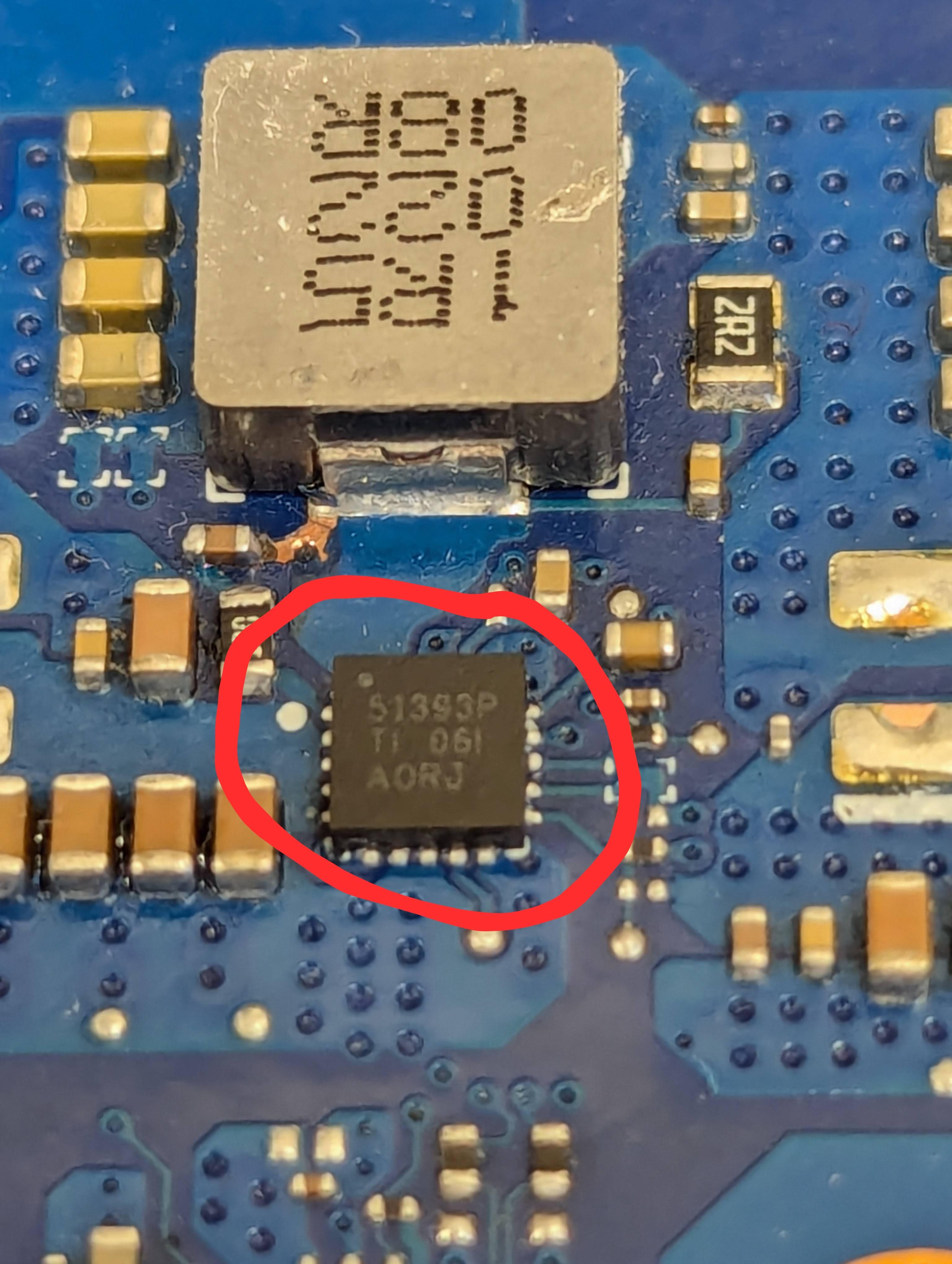

                                  I understand now. I found some corrosion on the board and also a component that gets slightly warm, but it is unclear to me how as no current goes in.
                                  I believe this is the USB-C controller -
                                  The area where the corrosion was, and the chip which gets warm (30C) -

                                    30C is not considered to be a high temp. Any regulator that converts a high voltage to a low voltage will raise the device temp in the process. Higher the efficiency of the regulator, the lower the temp rise over ambient.
                                    Have you attempted to reverse plug into the usb type C connector to test the other side of the dual blade connector? If you use one side, then CC1 pin is tested. If the other side, CC2 pin is tested. If you have more than one USB C connector onboard - test each in the same way.
                                    Do any of the port permutations offer 20v or a higher current draw?
