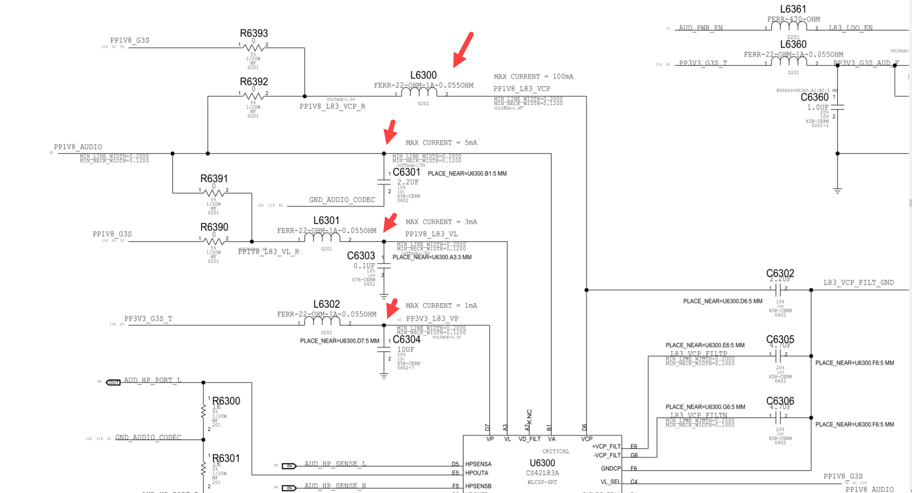

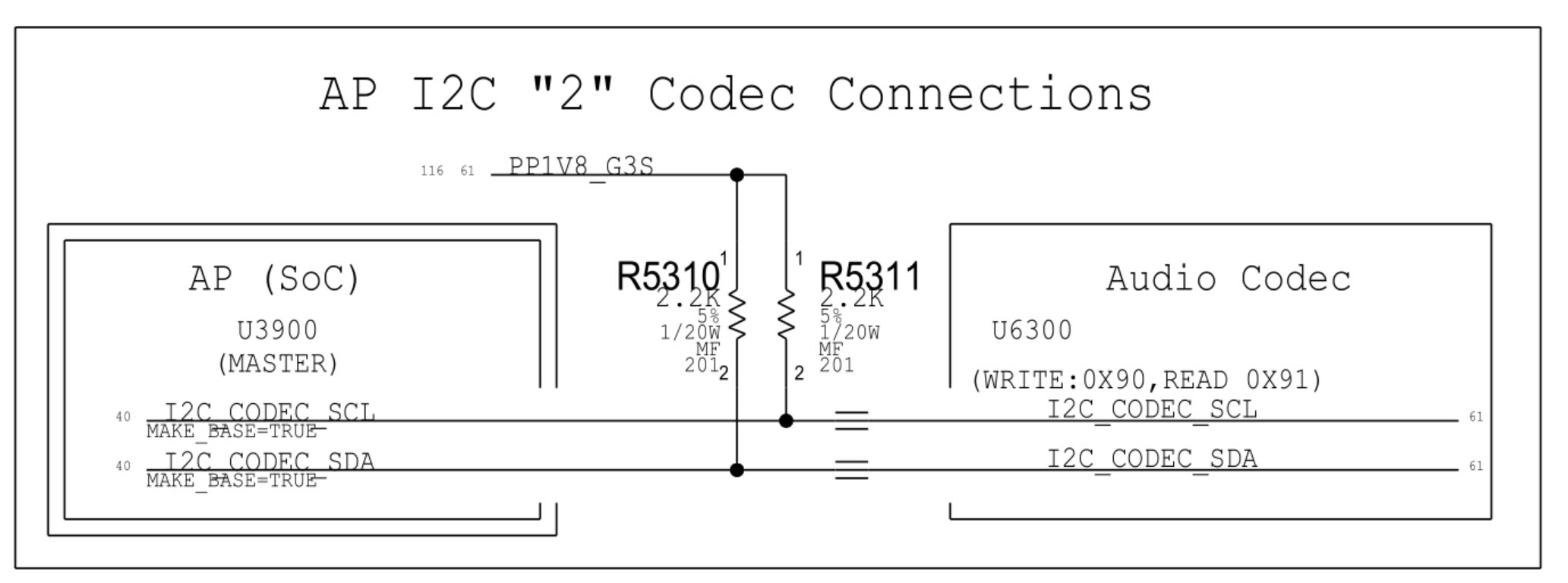

    Hello ,
    I have a MacBook Pro A1990 , year 2018 board number : 820-01041A.
    The speakers and the microphone of the Mac are not working for some reason.
    I do have sound through a Bluetooth device or when I connect a headphone plus microphone to the jack 3.5mm input.
    Can anyone give me some direction on how to debug it on board?
    thanks
  • mon2
    • Dec 2019
    • 14673
    Re: MacBook Pro A1990 No Audio ( Speakers and Microphone)
    Meter in DC volts mode, 5 volts or higher scale is ok.
    Measure the voltage to ground of:
    I2C_CODEC_SCL
    I2C_CODEC_SDA
    Check the power rails for the audio codec as per attachment.
    Post the measurements.
