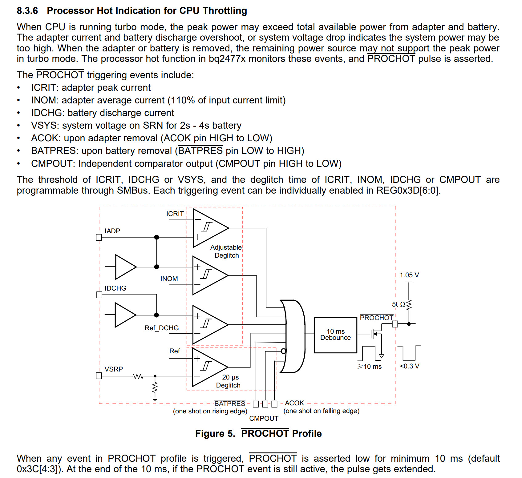

                  • mon2
                    • Dec 2019
                    • 14001
                    #29
                    Re: TUF505DT : No charge
                    To me, pin # 10 stick out.
                    This is an active LOW signal. If LOW, there is something wrong.
                    See attached from one of the datasheets by TI.
                    Remove all power. Meter in resistance mode. Measure the resistance to ground of pin #10.
                    Next, meter in DIODE mode.
                    Red meter probe, yes RED to ground.
                    Black meter probe to pin #10 of the charger IC.
                    Post each measurement.

                            #33
                            Originally posted by kurtspirit
                            1 - ACN : 19.41V
                            2 - ACP : 20.23V
                            Voltage drop too high
                            7 - IADP : 3,204V
                            Saturated as a result

                                • mon2
                                  • Dec 2019
                                  • 14001
                                  #36
                                  Check the resistance to ground of ACN pin.
                                  Post the measurement.
                                  • kurtspirit
                                    • Feb 2019
                                    • 112
                                    • France
                                    #37
                                    I find 85kohm between ground and ACN
                                    • mon2
                                      • Dec 2019
                                      • 14001
                                      #38
                                      So no short on the main power rail.
                                      Measure the resistance between ACN & ACP pins. What is the resistance of the current sense resistor?
                                      There should not be such a large voltage drop from ACP to ACN pins.
                                      Perhaps you can measure the voltage to ground again of each of these pins and post your updates.

                                        • mon2
                                          • Dec 2019
                                          • 14001
                                          #40
                                          OMG...can you check the acn to acp resistance again?
                                          Waaaay too high. Check the schematics (not at my desk now) but it should be ~1ohm or less.
                                          This is a serious fault if the reading is accurate.
