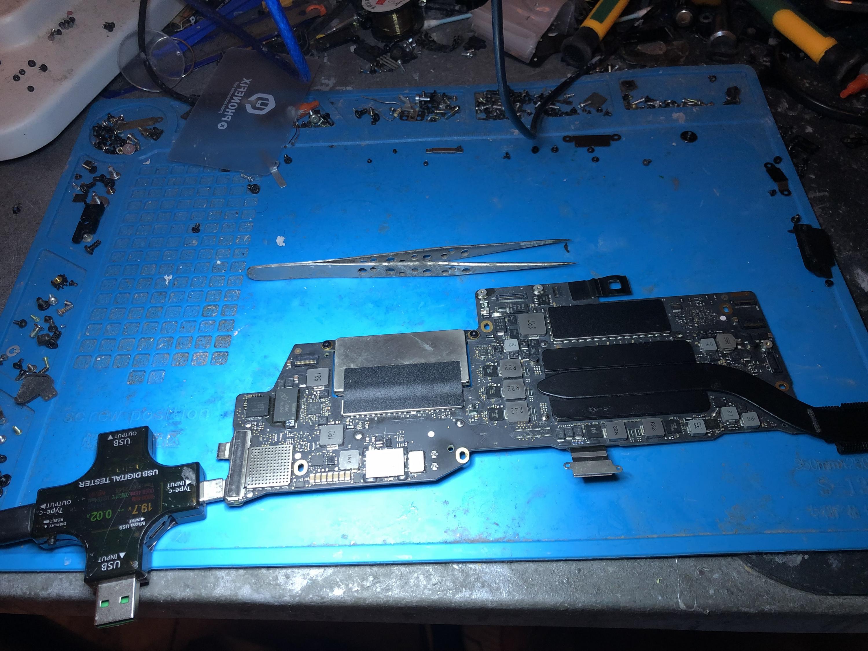

    HI, I have a macbook A1708 820-00840-A, won't turn on, no shorts, no liquid damage, well tripped 20v but no current draw.
    Measures :
    PPBUS_G3H 13V
    PPDCIN_G3H 19V76
    PP5V_S5 3 to 5V unstable
    PP3V3_S5 0 to 3V3 unstable
    3V3_S5 0 to 3v3 unstable
    PP3V3_G3H 3V4
    SN650839 have some voltages coming out:
    PP5V_LDo5V 5V
    PP3v3_LDO3V 3V3
    PPBUS_PMIC 13V
    PP1V25_VREF 1V3
    Do you have an idea please ?

    Re: macbook a1708 no power
    Remove all power. Meter in resistance mode.
    Measure the resistance to ground of:
    PP5V_S5
    PP3V3_S5
    Power up. Measure the voltage to ground of:
    P3V3S5_EN
    P5VXX_EN

      I replaced the u7650 but the result is the same
      PP5V_S5 290 K
      PP3V3_S5 24 K
      3V3S5_EN 47 K
      P5VXX_EN 47 K
      The measurements seem good to me but I can't find where the problem comes from.
        P3V3S5_EN
        P5VXX_EN

          P3V3S5_EN 0V Δ 3V4 instable
          the same for P5VXX_EN 0V Δ 3V4 instable

            must be some short on s4 s3 s0 rail. check resistance on that rails.

              I found the problem, c2977 in bad condition, by dint of doing tests and disconnecting and reconnecting, c2977 is shorted, I was then able to identify the short circuit and replace c2977, now all the voltages are stable and the macbook comes alive. Thanks for your help
