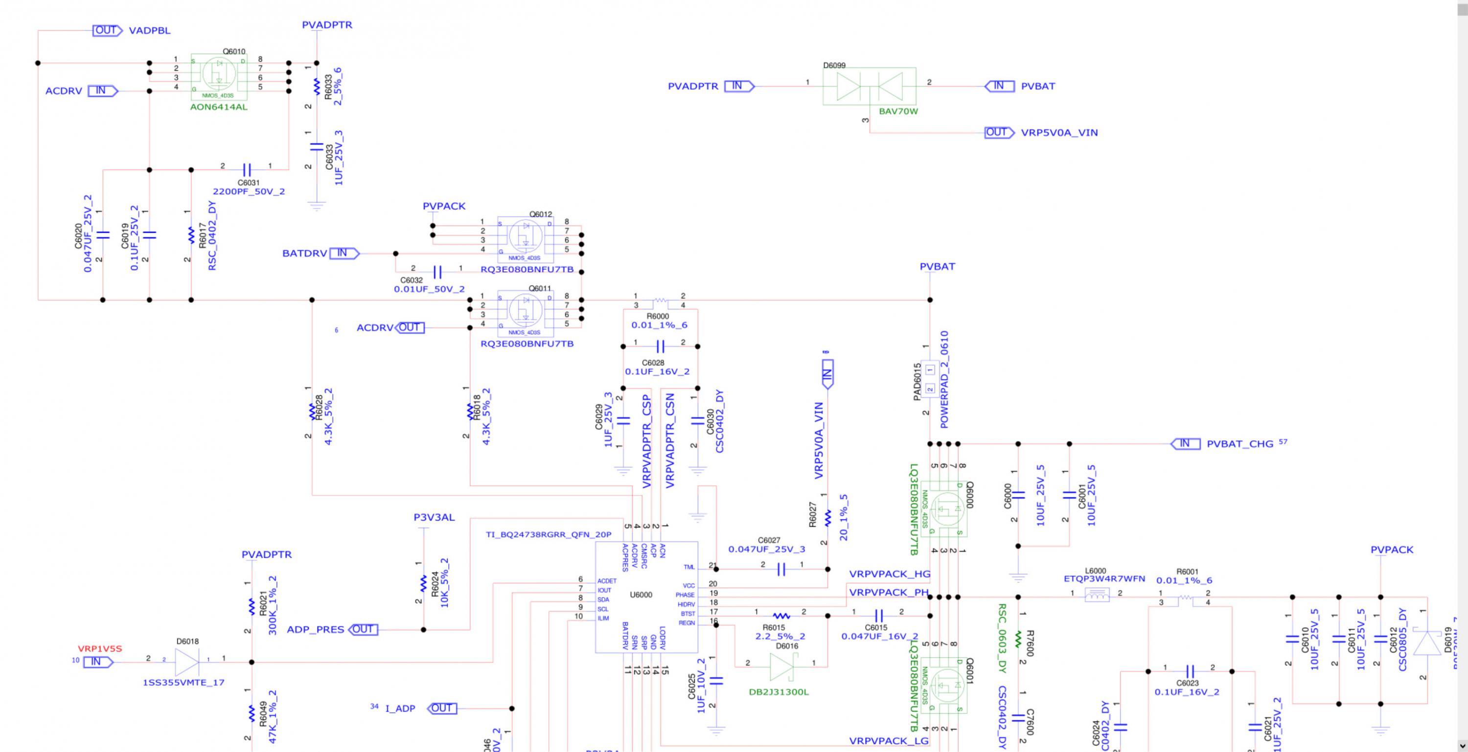

    hello
    my laptop hp 15SBGV2D-6050A2548101-MB-A02 does not turn on right now.
    If you make a direct connection from the first mosfet source to drain, it turns on, but if you put the battery in, a short circuit appears in the source.
    Turns on and works perfectly just connected to the battery and connected to the charger but both (battery and charger appears short circuit in the source and the first mosfet heats up and starts to smoke. (this without the first mosfet)
    If you put the first mosfet, the gate oscillates between 5v and 15v, sometimes 17v appears and I can turn on the computer.
    I have already changed the input mosfets, the secondary and the load ic and even then it does not work and always presents the same problem described above.
    The mosfets that I changed for the load and input and secondary mosfets and the switch are not original, they are the a5 vng n channel I think it will not be for that reason right?
    I await tips.

    1) remove the ~4k resistor @ R6018. Do not lose this part.
    2) Power up and measure the voltage to ground @ ACDRV pin # 4. What is the measurement?
    3) Measure the voltage to ground of REGN pin # 16. What is the measurement?

        Appears that the charger IC is able to boost the voltage ok to enable the mosfets.
        Remove all power and meter in resistance mode.
        Measure the resistance to ground of the drain pins on Q6011 = main power rail (PVBAT). What is the resistance ? If it is low, then the main rail is shorting somewhere.
        Check the resistance across the mosfet pins @ Q6011. Need to check if it is leaking.
        Measure the usual:
        source (1-2-3) & drain (5-6-7-8)
        source (1-2-3) & gate (4)
        gate (4) & drain (5-6-7-8)
        Post each measurement.

            Measure the resistance to ground of the drain pins (5-6-7-8).
            What is the measurement ?
            The readings are low and this mosfet may be leaky. You can remove it and measure the resistance of this part while it is on your work table to confirm.
            After this part is removed, are the readings of the other mosfets higher than reported earlier ?

                You still have a leaky mosfet in the circuit.
                Remove all power and review the resistance across the mosfet pins for:
                Q6000
                and also
                Q6012
                Post your measurements.

                    Each is a suspect with the low resistance values.
                    Carefully remove q6000 (aka high side charging mosfet) off the board. Then measure the resistance of the battery mosfet again.

                      ACDRV should be ~25v under normal operation. Fault may be from a leaky q6000 or the battery mosfet. Start with q6000 removal.
