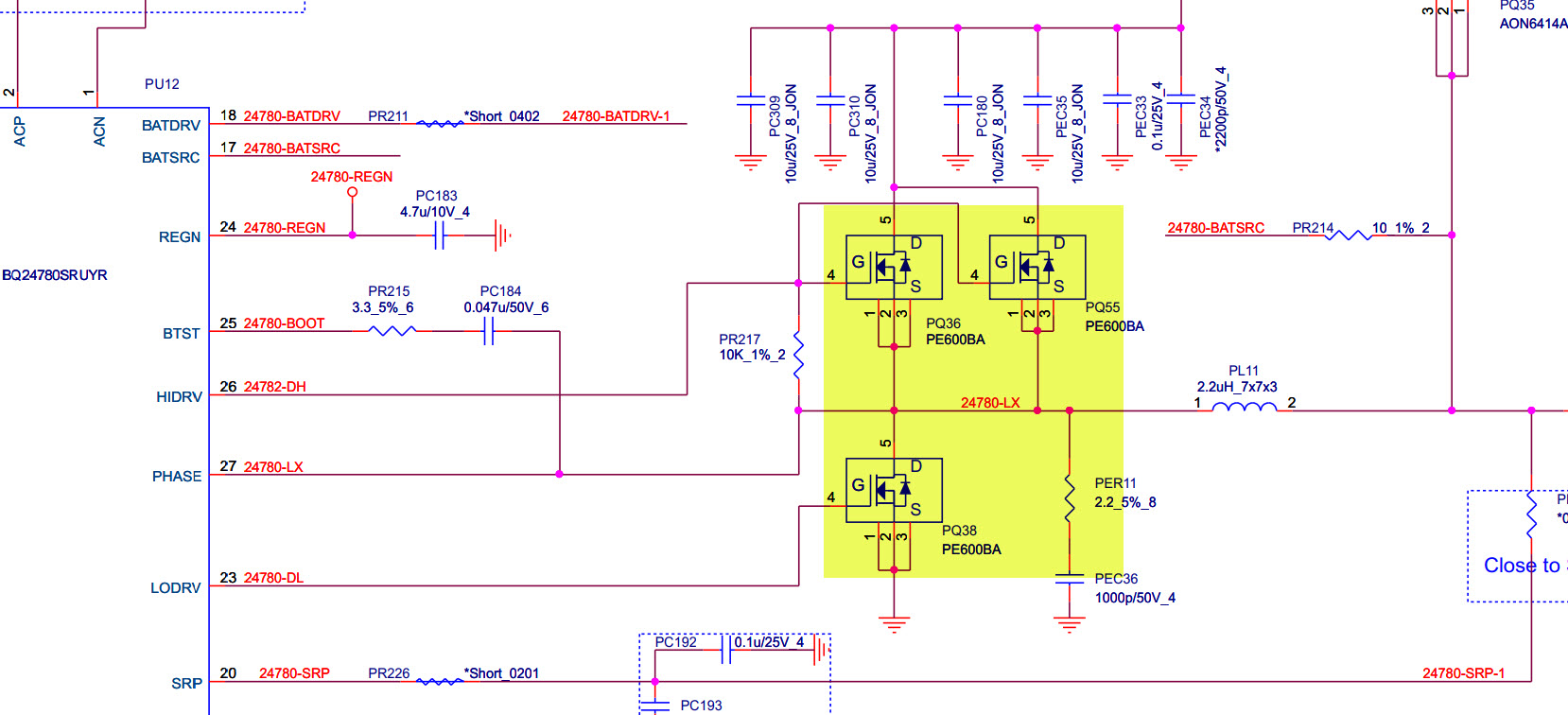

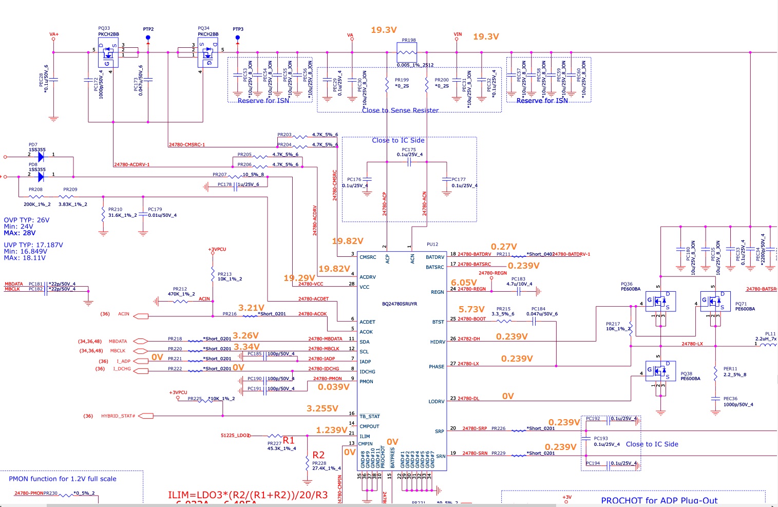

    I recently fixed a FA506IV cam with Vram mosfet short on Vin(19v)to ground. Got both mosfet replaced and now laptop could turns on and GPU everything works but battery not charging. Battery status shows 100% on both BIOS page and Windows system.
    Measured voltage got 0.3v on battery red lead not going up. charging mosfet gate low and 19v not passing through inductor.
    I also tried dc bench supply 14v charge directly onto battery but seems not drawing anthing.
    Any idea?

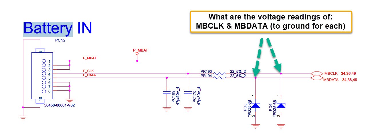

    Check the voltage on each and every pin on the battery pack.
    The suspects are the SMBUS pins and the local ESD diodes.
    Post the schematic / boardview files if available.

      schematic is similar to FA506IH. Will post BQ24780S pin voltage later on.

            From your post, assuming that you have inspected the battery charging mosfets @ PQ36, PQ55 & PQ38 ? Confirm it.
            Also post the actual measurements so others can review the details and/or learn from them.

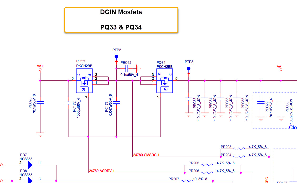

            See attached. @Piernov is referencing to review the DCIN mosfets @ PQ33 & PQ34.

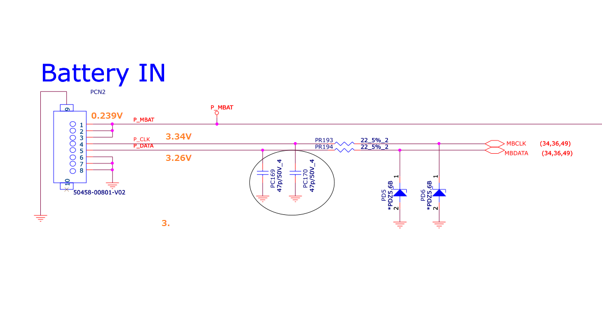

            I was requesting the voltage details of the SMBUS lines. Meter in DC volts scale (5 volts or higher is ok) -> red meter probe on SMBUS line under test; black meter probe to ground. Voltage reading ? Repeat for the next interface line.
            Update:

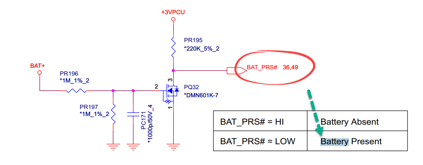

            What is the voltage reading (with the battery connected) of BAT_PRS# ?

              YES, I have inspected PQ36,PQ35, PQ71& PQ38. diode reading good.
              BAT_PRS# is 0v. LOW . So battery present

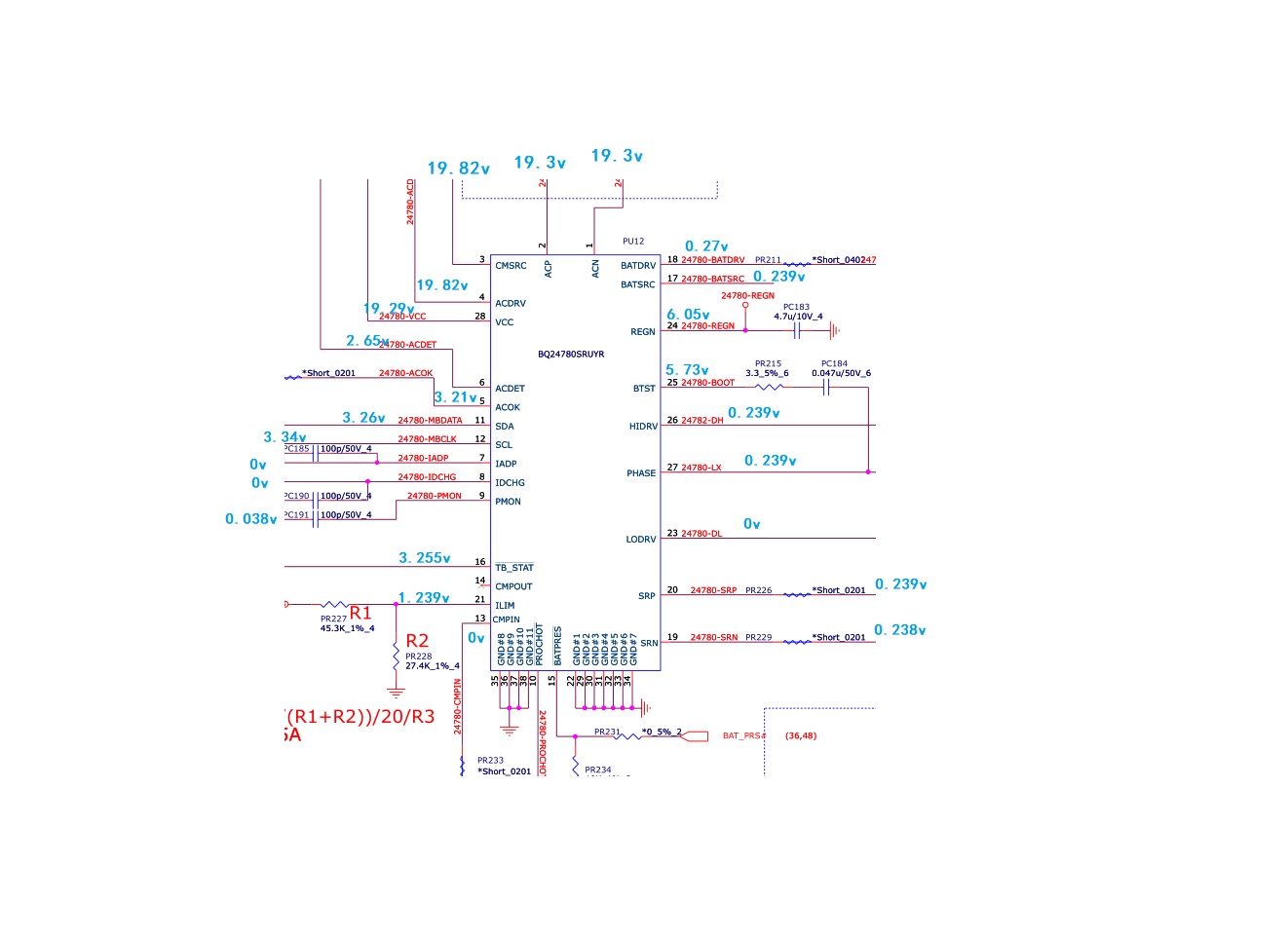

                1) What is the voltage of ACDET on the charger IC (PU6, pin # 6) ?
                2) The ACDRV voltages are too low to turn on the DCIN mosfets @ PQ33 & PQ34.
                3) Remove all power / no battery. Meter in resistance mode (start with the lowest scale).
                Then check the resistance across the DCIN mosfets as follows:
                source (1-2-3) & drain (5-6-7-8)
                source (1-2-3) & gate (4)
                gate(4) & drain (5-6-7-8)
                Post each measurement. If the reading is '1' or 'OL' on the meter, switch to a higher scale.
                Also post the meter scale for each measurement.
                If the resistance is too low, the mosfet is defective and needs to be replaced.

                1) attaching the datasheet for the DCIN mosfets = N-channel.
                2) On an N-channel mosfet so the gate voltage has to be HIGHER than the source to turn ON the mosfet. Typically TI likes to use ~6 volts HIGHER than the source leg to turn it ON.
                3) What is the voltage of your applied battery ? Suspecting that it is not 19v3 on the battery.
                With the adapter connected -> the gate voltage being too low to have the mosfet technically ON -> suspecting that at least one of the mosfets is defective (PQ33 and/or PQ34).
                Would you have a donor board ? The mosfets are quite common and can be replaced with others.
                Still proceed to do the resistance checks on these mosfets as a confirmation.

                  My bad, ACDET is 2.65v on BQ24780S PIN6
                  OMG, you are right, for PQ33, I have low resistance around 2ohm on DS,SG and DG. PQ34 has 18 ohm on GS, DS and DG about 78k ohm.

                    I will suggest to replace BOTH of these DCIN mosfets - they are quite inexpensive. You are in TO and should have lots of access to such parts - if not shout back and will see if we can hunt them down.
                    DK / Mouser / Arrow are outside sources for the same.
                    The ACDET voltage is good.
                    A bit concerned about the TI charger IC as well since the conditions appear to be OK but with defective DCIN mosfets, the charger IC may be folding back and not allowing for further charging. That is, the ACDRV is low when expecting ~25v on the gate of each DCIN mosfet. Just a guess that the charger IC is turning OFF this flow of events.
                    Respectively - not a bad idea to hunt for replacement mosfets for the DCIN x 2; battery charging mosfets x 3 and the charging IC itself.

                                      Just post update and thanks to @mon2 advice, after replacing 2x DCIN mosfet, charge ic finally shut out 17.2v to battery and now charging like a charm.
